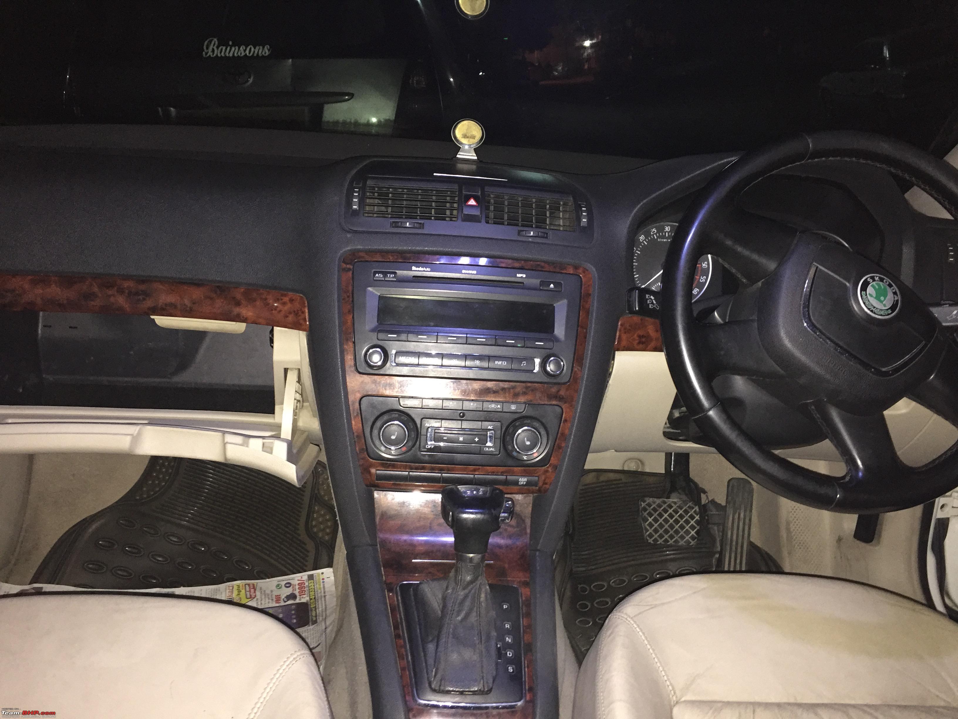

Skoda Laura Elegance Airbags and multiple problems
Hi friends, we just bought a used Skoda Laura Elegance 1.9 TDI 2010 model with automatic transmission.
The Car is in good shape and it has 95000 kms on the odometer. Though we have sorted most of the minor problems with the car by replacing the flywheel, setting the left front door glass switch problem and glove box light tube and front fog lamp bulbs replacement, yet two three problems persists as we could not locate the real cause.
Now, we cannot locate the passenger airbag switch in the glove box, even as while putting the car on Scanner, it is found that the Passenger Airbag wire is open. Same is the case with reverse gear Sensor, as the Graphic display is unable to show the distance from an object behind the car nor the buzzer would beep.
Any guidance in the matter would help us to ascertain the problem, before going to the Garage again as the previous garages, we visited were unable to sort the trouble.
Are you very sure the car hasn't had an airbag deployment till date?
There have been cases when people have not replaced airbags after an accident and do not inform the next buyer of it. Also, since the airbag wire is open, it could very well mean that the module is missing.
Coming to the reverse parking sensor, it sounds like a malfunction between the sensor and the display and not the gearbox itself. This can be checked by any reputed garage handling slightly premium cars.
