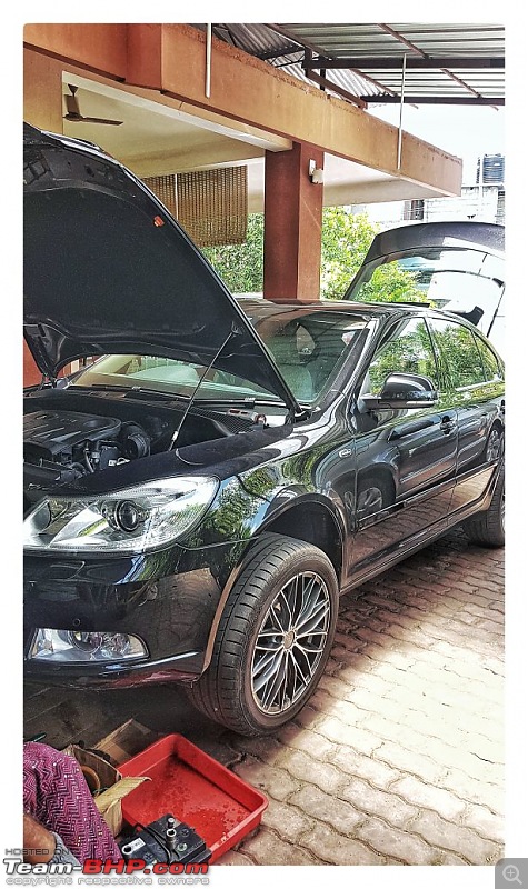

So finally, I decided to change the DSG Oil today. Laura has done 53000 Kms after 5.5 Years. I went to this specific independent vendow after coming across some good reviews from Team-BHP about a gentleman called Abraham who owns this workshop called Eurocar.
He charged my Rs.10000 for 6 Litre of DSG Oil + Filter from the brand Febi (Bilstein). The oil replaced was moderately dark in shade. Their mechanic did an clean job. Very friendly people. Few other cars I found there were Porsche Cayanne, Range Rover, Audi A6, Couple of Jettas and Octavias. I am not sure whether there's any extra smoothness in the shift post oil change except for the Placebo effect .

Which brand and grade of oil did you get?

Mechanic got the VW SPEC DSG Oil. Brand name is Febi from the house of Bilstein. Filter also came as a part of the kit which was manufactured in Netherlands. It came as a kit of 6 bottles + Filter.
