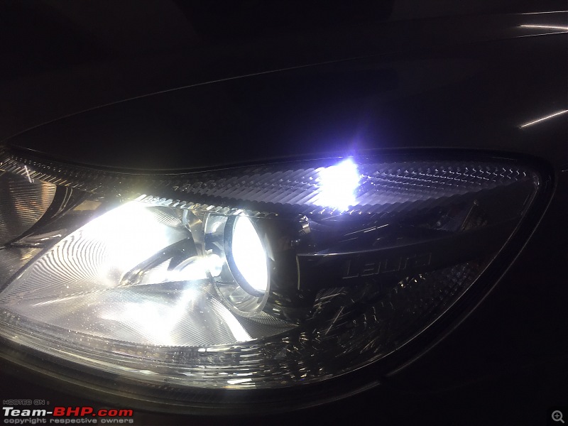

I have upgraded low beam lights to HID, I see lot of difference in visibility. The product I chose was RSR H7 4300W with canbus. Hence there was no error code generated.
Below are some pictures.
Looks great with the HID, could you tell us from where did you source the kit & how much it costed if you don't mind? What brand of lights(Philips?) are you using?
Looks like your parking lights are 8000K as it looks bluish did you get an error canceler for that as well?
I sourced a kit from Sainath Auto Ultimate Khar, The kit came with HID bulbs and a canbus kit from RSR which did not through up any error you can refer last picture of canbus, while setting up the parking LED's they were also routed through canbus hence there was no error. The job just plug and play no wire cutting or any alteration required in wiring set up.
Total job costed me RS 8300, it was worth spending as I could see lot of improvement in lighting.
