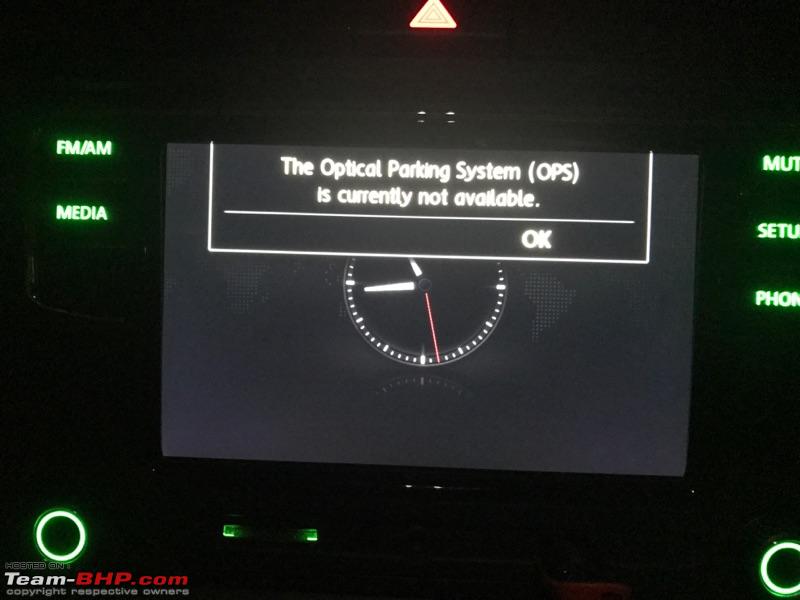

At times, the system produces a loud beep with the parking switch blinking. The system just stops functioning and displays the message "OPS is currently unavailable".

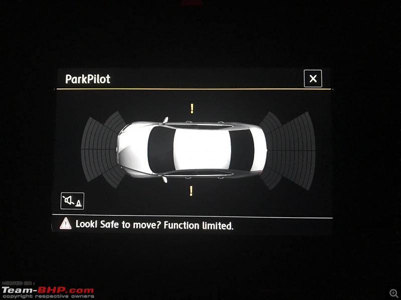

Sometimes, the system works with limited functionality. In this case, the front parking sensors give visual feedback but not acoustic feedback.
Skoda Laura: Problems & solutions thread-2.jpeg
From all this, I suspect the front parking aid speaker. How do I access the speaker and where is it located? Is there anything else that needs to be looked into? Any inputs would be of great help.

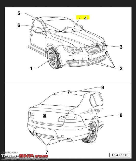

Hi csr9,
This error will come when any component of the OPS system is removed. This error comes only once after disconnection of any component such as sensor/buzzer. Since your system is working partially it most likely is loose connection.
Could you please check if you are able to find this buzzer behind instrument cluster.
Skoda Laura: Problems & solutions thread-skodaops.jpg
Regards.
