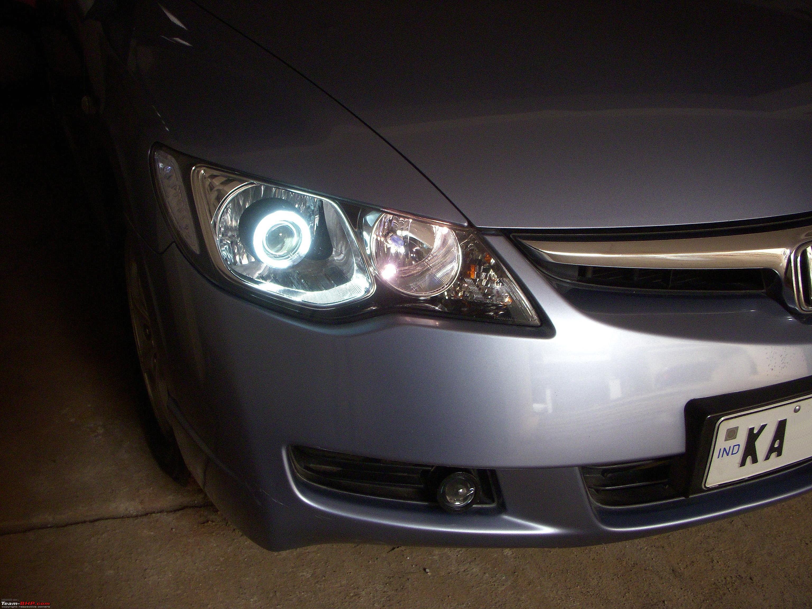

Friends I have got my car fitted with Morimoto H1 Projectors & also Blazer fog lights.
Had got the blazers fitted last week.
Morimotos were fixed yesterday.
As of now, All I can say now is they are just AMAZING.(will write a detailed report later)
After fitting the Mini Morimotos I'm facing some issues, need to take it to HASS. But before that I would like to get clarified here.
Parking lights are not working(front, rear) after the angel eyes(CCFL's are working if connected directly from battery) were connected. Current is not passing from the wires to Parking light.
We checkd the Fuse too, (Fuse #8 below the steering). Fuse if fine
What could be the issue?
Wiring was done perfectly.
Today morning my HU LCD (only LCD display) is not producing proper light, it's way dull(every other interior light is working perfectly), but the moment I put the parking lights switch the LCD display is proper (Parking lights are still not working).
HU is working perfectly, except for the display.
So what could be the problem for both these issues?
I'm very much concerned about the car now.
Note -I'm also puttin up the same post in Auto Lighting thread too

Issue resolved. FUSE BUSTED
While retrofitting We had checked every Fuse in the Fuse box, except for the one which was busted.
Did a thorough recheck once again yesterday late afternoon, found the faulty FUSE & replaced with new.
Everything is working fine.
Shall write a small report later.
A Pic of the Car with CCFL's on.
Honda Civic : Maintenance, Service Costs and Must dos-dscn4005.jpg
Honda Civic : Maintenance, Service Costs and Must dos-dscn4006.jpg
sushrutha is offline

Hi Sushrutha,
Congrats on the ccfls. You beat me in getting them first . They look awesome.
Can you give the source where you procured the entire set and the costs ...

That's good to hear, Sushrutha!
The car's front looks appealing with the new headlamps.
I hope you have before/after pictures of the headlamp beam throw in the dark. It would be an instructive comparison for prospective upgraders.

Sushrutha the lights look awesome.
Awaiting some pics in the dark. Actually can't wait to see the full look which i am sure will be spectacular in the evening / night.
