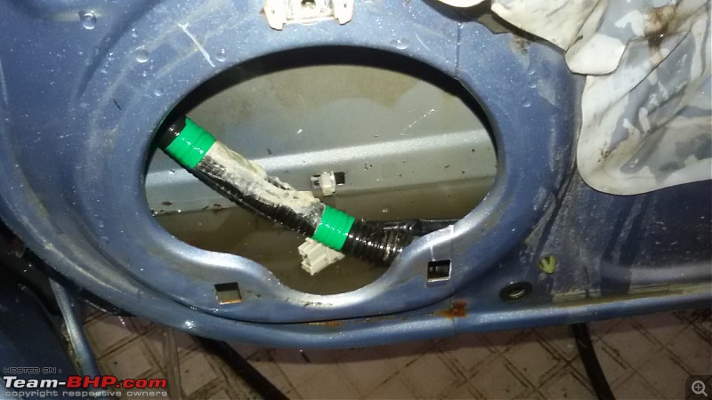

Originally Posted by kunal_kaushal View Post
Hi Mate
I would suggest to please examine the joint beneath the weather strip on the roof just above the A pillar, which is prone to develop small gap due to deterioration of the sealing compund with age coupled with harsh weather conditions, at times the same is the cause if water entering the cabin from the area highlighted through the pic your good self has posted.
Originally Posted by coolkurt View Post
You can check out this video.
The SA mentioned that they are going to use sealants and patch these up. As of now as you both detected, the culprit seems to be doors clog and the weather strip. Check these pictures and videos
Hopefully this solves your problem. Couldn't help notice that even you have missing windscreen beadings. They were stolen towards the end of my car's life cycle too. Surprising theft
Did the leakage issue sorted out, where did you give the civic.
