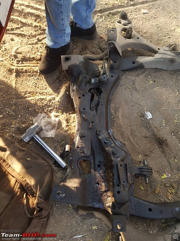

Took it for a repair shop with good reviews nearby. I am watching the work as the guy wants me to see it in front of him. Attaching some pics. I will post detailed description once everything is back running. I have heard good reviews of this guy. The major leaks seems to be from pipe hose which we pressed and came back from a hydraulic shop. The pipe has a sensor attached to it which is restricting our further movements to make it more firm at the metal hose. Let's see.

So, another update. It was a very long day for me as few other issues cropped up.
The rack had a minor leak which was fixed for 7.5K which is definitely an expensive fix but quality of work was good, so I don't mind. The real leak is from PS high pressure pipe- it has a small hole in middle, no idea how it happened. It is leaking from there. So, the fix we will do on Friday is- will remove the hoses and connectors, get a new pipe and will connect back all hoses and connectors carefully via hydraulic press. I am quoted 1500 with labor. I feel rack didn't needed any repair but anyway I did it. :banghead:
The high pressure pipe has a sensor connected to it, they say can get a new one from Honda only. The local ones do not have that sensor attached to it. May be anyone has idea here how they replaced the high pressure pipe before. Attaching pic of the sensor on pipe.
Also, my steering alignment was totally bad after the rack was fixed again. With trial and error we brought it to correct position but still the car steers towards right when the steering is straight to the driver. Will this be resolved by wheel alignment?
I had a minor accident after installation but I was lucky that it happened is garage only. The tie rod of driver end broke down from the joints all sudden when I was taking reverse. No idea how it happened. The mechanic was also surprised. I replaced with a new pair immediately. I was lucky that it didn't happened on road when I was driving or was with family. Any idea how can it happen? It was changed last year by my FNG, ofcourse was not a genuine Honda part. :(
I will update regarding pipe fix soon.

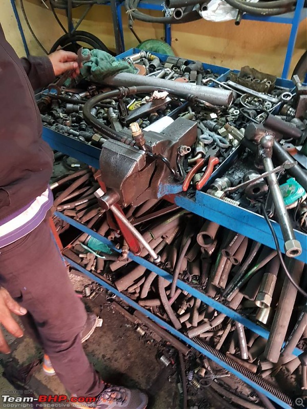

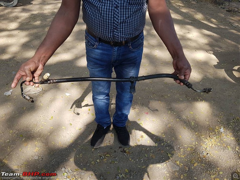

So, finally a sigh of relief.
I been to workshop today and immediately started working on the high pressure pipe for PS. The pipe was not readily available by dealers and HASS one was above 15K. So, here's the trick we followed.
1. Opened the existing high pressure PS pipe and drained all PS fluid.
2. Took exact measurements and photos of it.
3. Removed the PS pressure sensor.
4. We went to hydraulic shop nearby and started working on the new pipe.
5. The guy at hydraulic shop took measurements for the new pipe. He took a pipe which is used in JCB with power of 320 Bars. The current pipe was rubber one in and out and can only hold 100 Bars of pressure. He guaranteed me that now there won't be any leak on pipe as its metal based with rubber.
6. In front of me he started building a new one with existing connectors from the old pipe as they were all good.
7. Pipe is ready though came 2 inches extra in length which took 40 mins extra by the mechanic to fix.
Attaching the pics here of old pipe and workshop guy in Pune. I missed to take photo of new pipe that was built. The car is showing no signs of leakage now. Tomorrow, I ll take car to high pressure wash to clear all oil debris. I should say our roadside mechanics are equally competent.
Honda quoted me 1.2L for complete replacement of PS system. My job was done in less than 12K. Pipe was built for 1000 bucks and Labor 600. I am monitoring the car now and so far fluid levels is same. Also, do not use transmission oil for PS and only use a Power Steering fluid of good quality. I topped up the complete PS with 750 around ml of oil.
