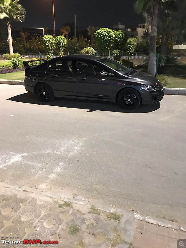

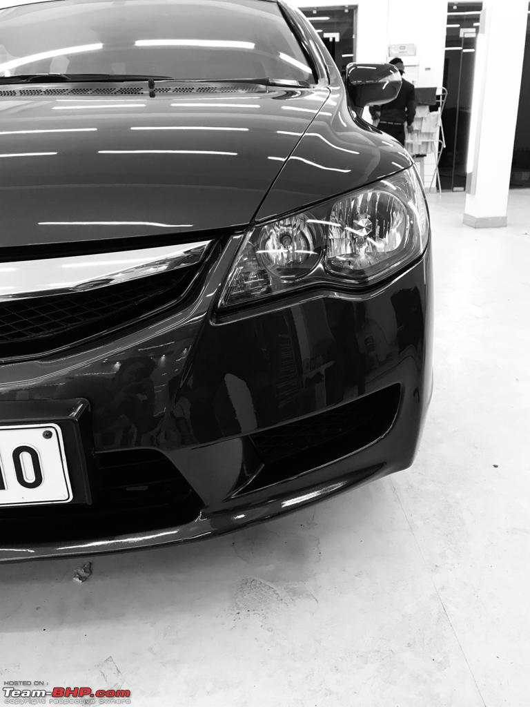

I would say if you are not in NCR, definitely go for it.
In fact I got one for myself last October and could not be happier. That is when I am in Gurgaon.
I still have about 5.5 years of life left in that car and I am not even going to be in the country that long (plan to move out sometime in September), but the time that I have spent with this car, will always be so special. It will always be my first car love.
Attached some pics to push you for the decision
Honda Civic : Maintenance, Service Costs and Must dos-imageuploadedbyteambhp1590262927.283125.jpg
Honda Civic : Maintenance, Service Costs and Must dos-imageuploadedbyteambhp1590262975.943599.jpg
Honda Civic : Maintenance, Service Costs and Must dos-imageuploadedbyteambhp1590263017.613847.jpg
akhil994 is offline   (5) Thanks
Attachment 2009524
Oh man! You must do that. Don't you ?
Your car look H.O.T
Wow! Dude, your car looks smoking hot.
The new gen Honda civic pales in front of it's 8th gen predecessor.
