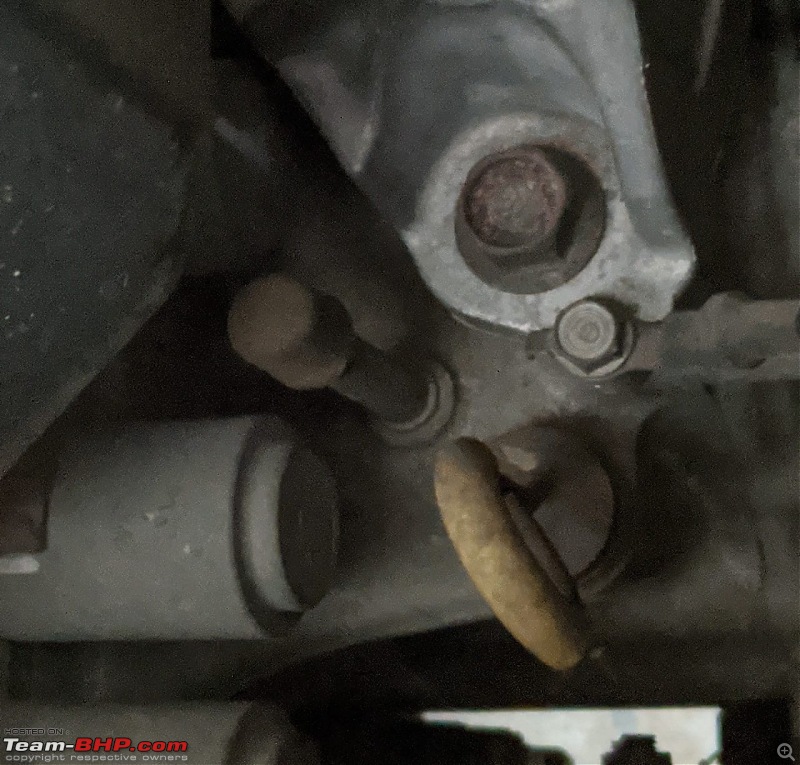

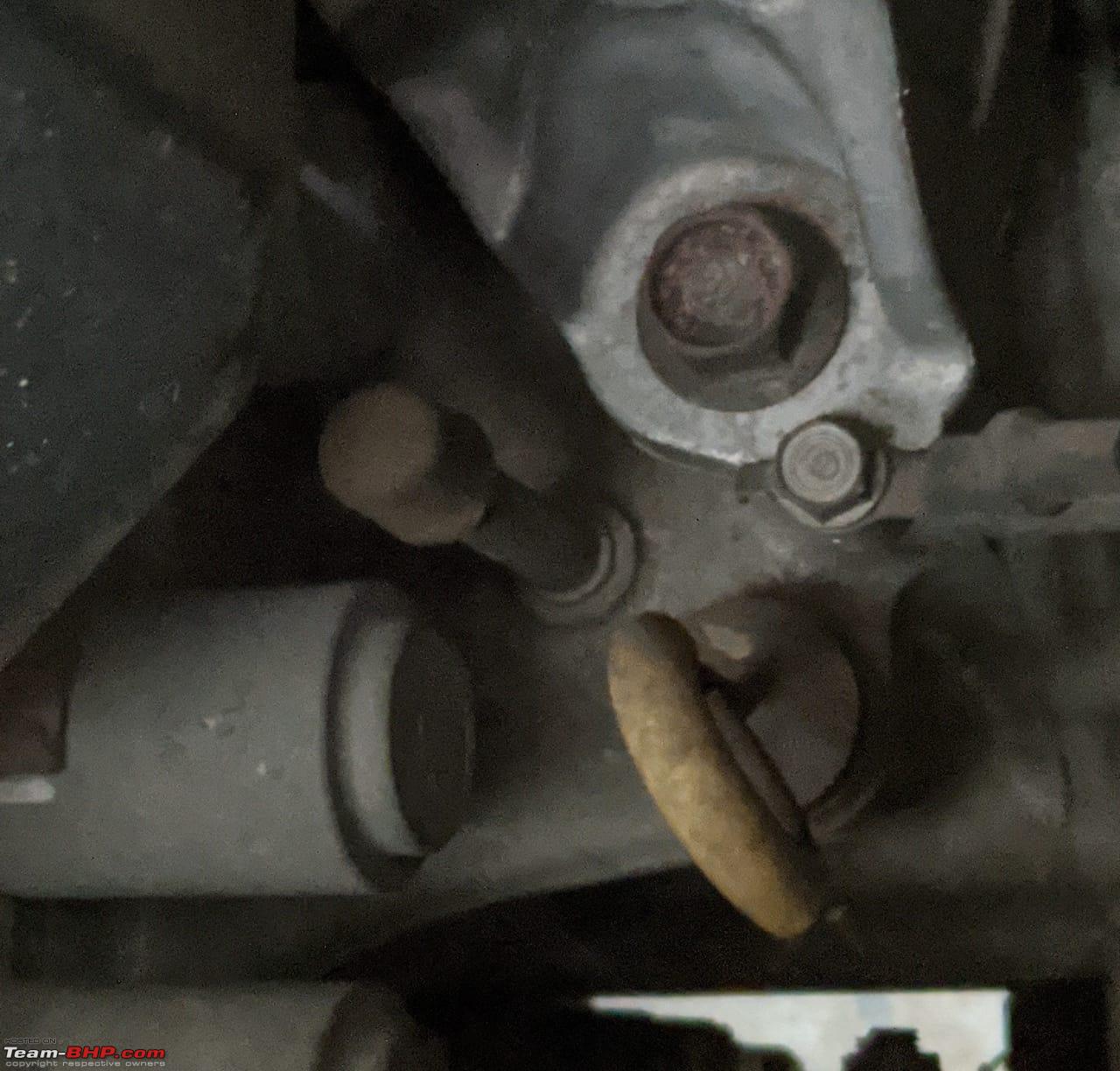

First check if the handbrake actually *works*. The handbrake cable is attached to the rear brake calliper in a ‘hooked’ manner. Just peep underneath and you’ll understand.
Also, the civic has a disc setup all around which makes the parking brake a little tricky than usual. There’s also a provision to adjust the cable tension. It can be something as simple as a lose cable which needs to be readjusted. Any half good mechanic should sort it out for you. Till then, use park in the AT box.
