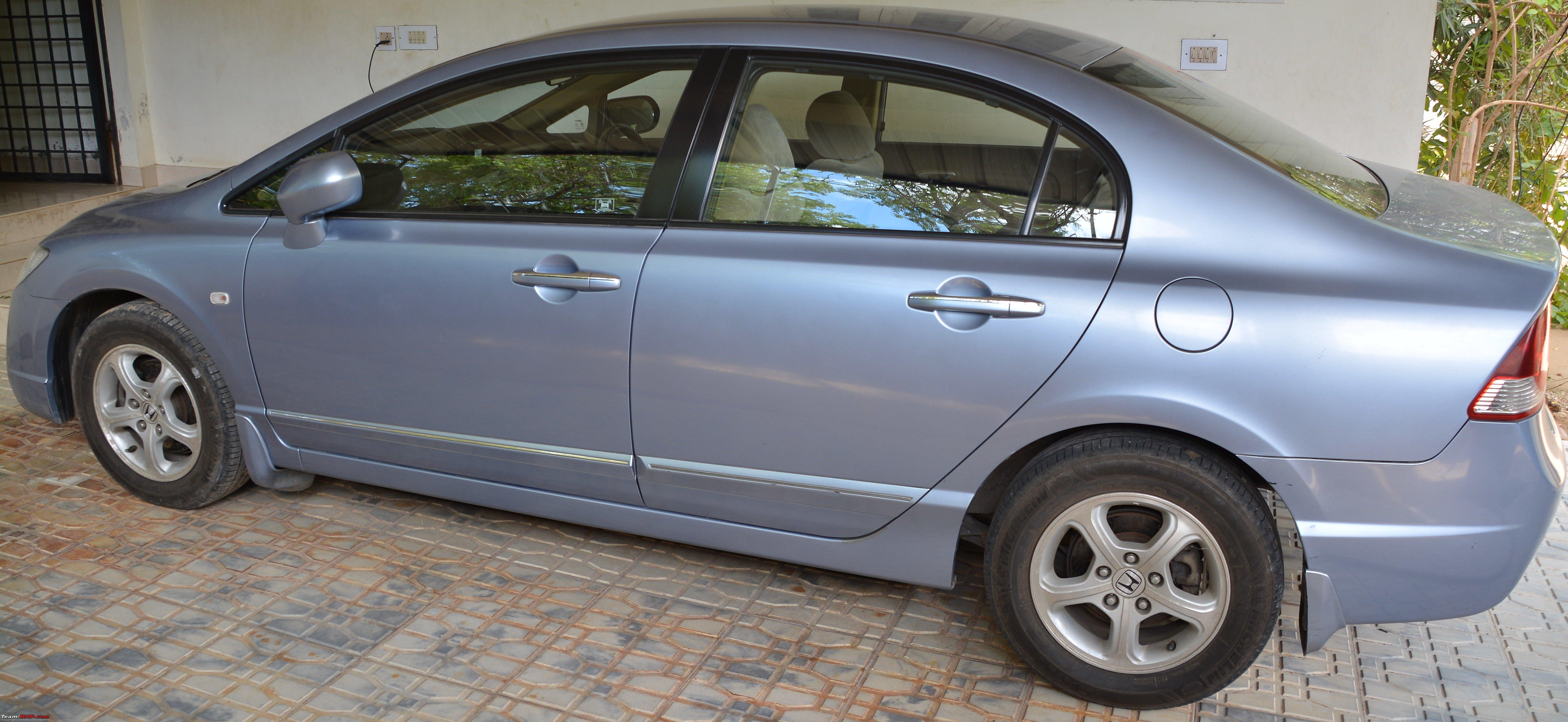

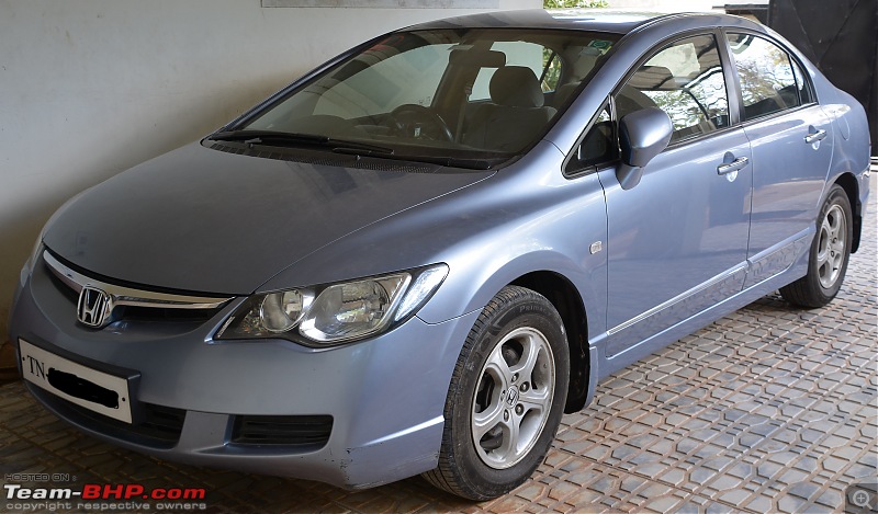

Had a 200KM run today and fell in love with it again.
I too had a 300 kms run on 4-lane roads recently and I know that a City can never beat this in high speed stability. And to know that nothing else on the highway can overtake me If I chose to, I was the King on the road!
Photos I took a few days ago:

I don't believe this car is 14 years old. It seems more like a 5 year old. And the shape it is in, It would have done another 14 years easily. You seem to have ample parking space. Was it not possible to retain the Civic and buy another smaller vehicle like the Amaze and keep both cars?

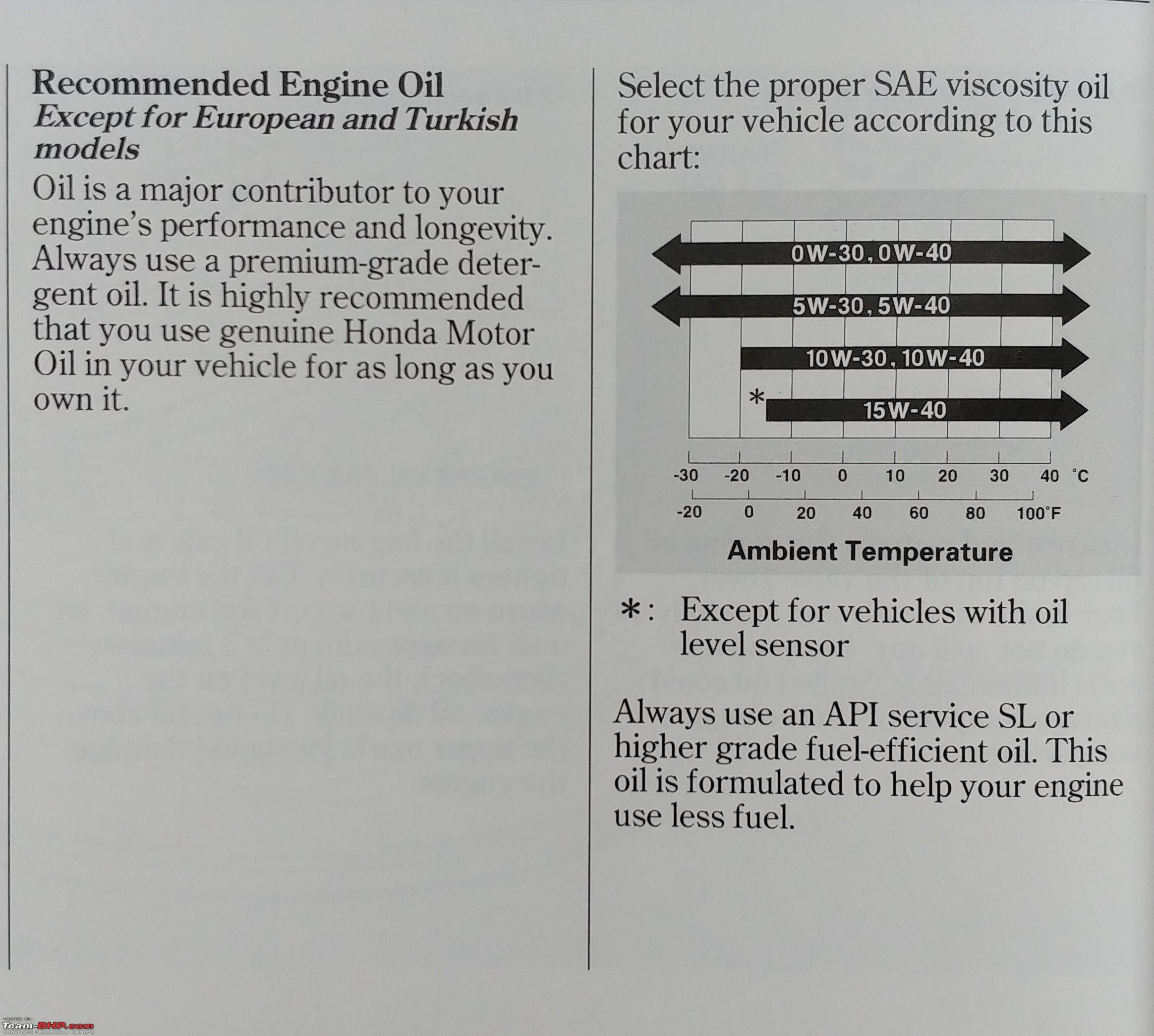

Originally Posted by pta320 View Post
If not then please atleast someone upload the maintenance/service page which has all the maintenance items and timelines. And also the page which has engine oil grade mentioned.
Thank you.
Captured the necessary from my mobile. So, pardon the quality.
Honda Civic : Maintenance, Service Costs and Must dos-20210920_1347561.jpg
Honda Civic : Maintenance, Service Costs and Must dos-20210920_134826.jpg
Honda Civic : Maintenance, Service Costs and Must dos-20210920_1350311.jpg
During last service at the ASC, my Civic was filled with 0W20 grade oil from Idemitsu. Today, on referring the owners manual, am surprised to see 0W20 is not in the recommendations list! Veterans, please share the best grade and brand of the oil to be used in Civic, ensuring longevity of the engine components.
Thank you brother. That was a life saver.
Honda ASC fills 0W20. After learning that I changed to Mobil1 5W30 immediately. Anyways I now maintain the car myself so will only send to ASC for some parts/fluids which are not available.
Attachment 2209510
Attachment 2209511
Attachment 2209512
From what I’ve gathered, 0W20 is usually recommended for better fuel economy. On newer Honda’s it is there in the owners manual recommended oil list. 0W20 is a thin engine oil which is easy to pump and that’s why it helps in the economy.
Please note that 0W20 and 0W40 both will behave similar at lower temperatures. At higher temps 0W40 will be a lot more viscous and will provide better wear protection as it will stay for longer between the moving parts.
At cold temps 0W oils will flow much much faster than an oil like 15W or 20W and that’s where they shine by providing immediate protection during startup. That’s why with thick oil like 15Wxx or 20Wxx the car is difficult to start during cold temps.
To summarize in 0W40, 5W30 , 0 - 40 , 5 - 30 are temperature ranges in which oil is certified to operate and provide protection.
Hope that helps.
Hope that helps.
Quite informative.
Thank you brother. That was a life saver. After learning that I changed to Mobil1 5W30 immediately.
You're welcome. Let me know if you need anything else.
What made you choose Mobil over other brands? And why did you opt for 5W30 instead of 5W40/ 10W30/ 10W40?

In case you find the page mentioning coolant change information, please do share.
You can chose any brand of oil. Just make sure that oil grade is same or higher than the one recommended in owners manual (most oils these days are API SN certified or greater). Brands hardly make any difference unless it's some unknown brand. Mobil, Castrol, Shell, Liquimoly, Pennzoil, Motul are all great brands.
Mobil is usually the most used as I see on many forums and has more reviews available backing up its image. On some YouTube tests Mobil1 marginally outperforms other brands. So all these factors combined with easy availability on Amazon makes Mobil1 my choice of oil.
From what I've seen Mobil1 0W40 (Ultimate all round performance) is the best engine oil you can buy in India. (0W40 is a higher grade than 5W30/40 and is complaint with European regulations which are usually stricter than US regs). But make sure your owner manual recommends it.
