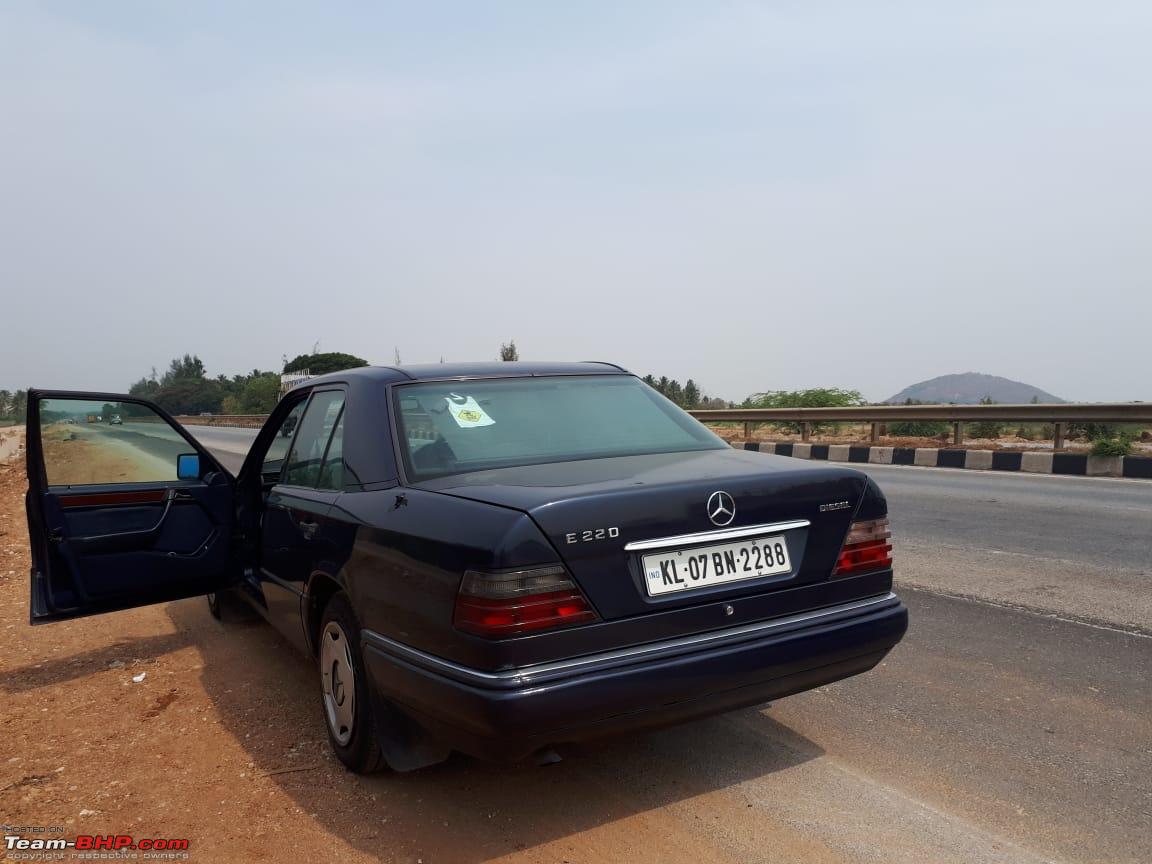

So the latest:
I reached Pune from Kochi in the W124. A long 1,500 km drive.
Only the last 120 km on the highway could've been better - with traffic jams due to road construction. We were stuck in a non-moving traffic for about 1 hour and it took almost 4 hours to cover the last 120 km. The drive itself was good and I mostly kept between 90-100. Occasionally touching 120 kmph. We stayed over at my brother-in-law's place in Bangalore and started to Pune from Bangalore sunday early morning and reached our place in Pune the same night.
So, the next day (monday) around 11 am I was unloading stuff from the trunk and started the car again just like that and idled the car for sometime. A few minutes later, I saw the car was dripping diesel. So I opened the bonnet and it looks like the diesel was leaking from the fuel filter. This morning when I checked again, the leaking seem to have stopped and the area around the fuel filter is dry. Not sure whether the leaking had started after the long drive on sunday or when the car idled Monday morning. I`ll take a look in the evening today to see if it is leaking again after I start the car.
P.S:- The 'E 220' instead of the 'E 250' was done on purpose. The original RC book said E220 even though it said Diesel and having everything else right (the engine size, number, cylinders etc). While renewing the registration last week, I didn't want any complications, so I took out the '5' out of '250' and stuck in a '2' which I had collected long back from somewhere. I`ll put the 250 back on it.
