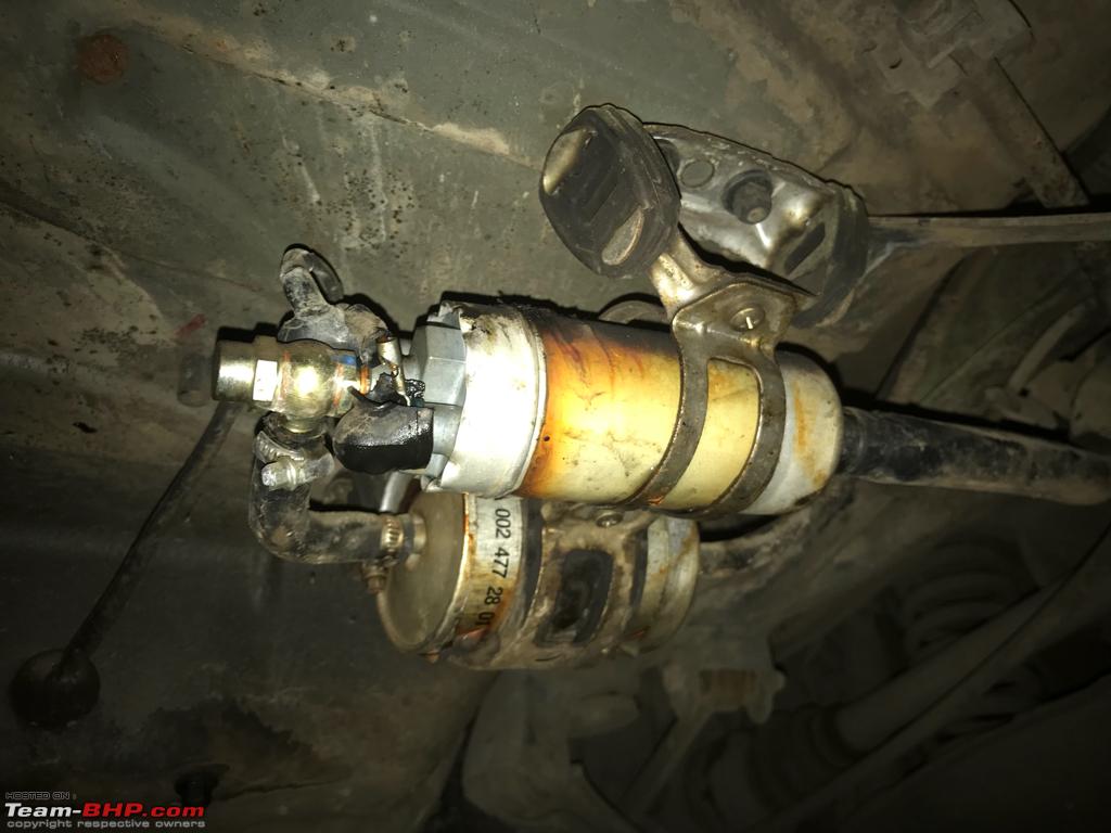

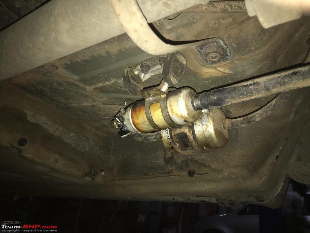

Hello Jeroen,
I have attached some images and also pin pointed from where the leak is happening. So I don't think it's the hoses, maybe a faulty fuel pump? My car is a 1997 model e220 W124.
Thank you
always a bit difficult to see on a photograph. I do not see any obvious wet spots. I do see a piece of hose, hose clamp, bajonet bolt with a copper ring. All of that can leak if not tightened properly. Try and switch on the pump, (usually switching on the ignition will do) and see if you can see where the actual leak is.
Anything coming from the above should be fixable without having to replace the pump. If it leak from somewhere else on the pump you might have to replace the pump. This looks like a sealed pump, so not much you can do.
Good luck
Jeroen
If I fill petrol it still leaks without even switching on the pump(switching on the ignition), I don't know much about it but that is for sure it's a sealed pump can't do much. I have a video that shows the exact place from where it leaks. Going to take the car to a W124 specialist,that is what I have been told. Hoping for the best.

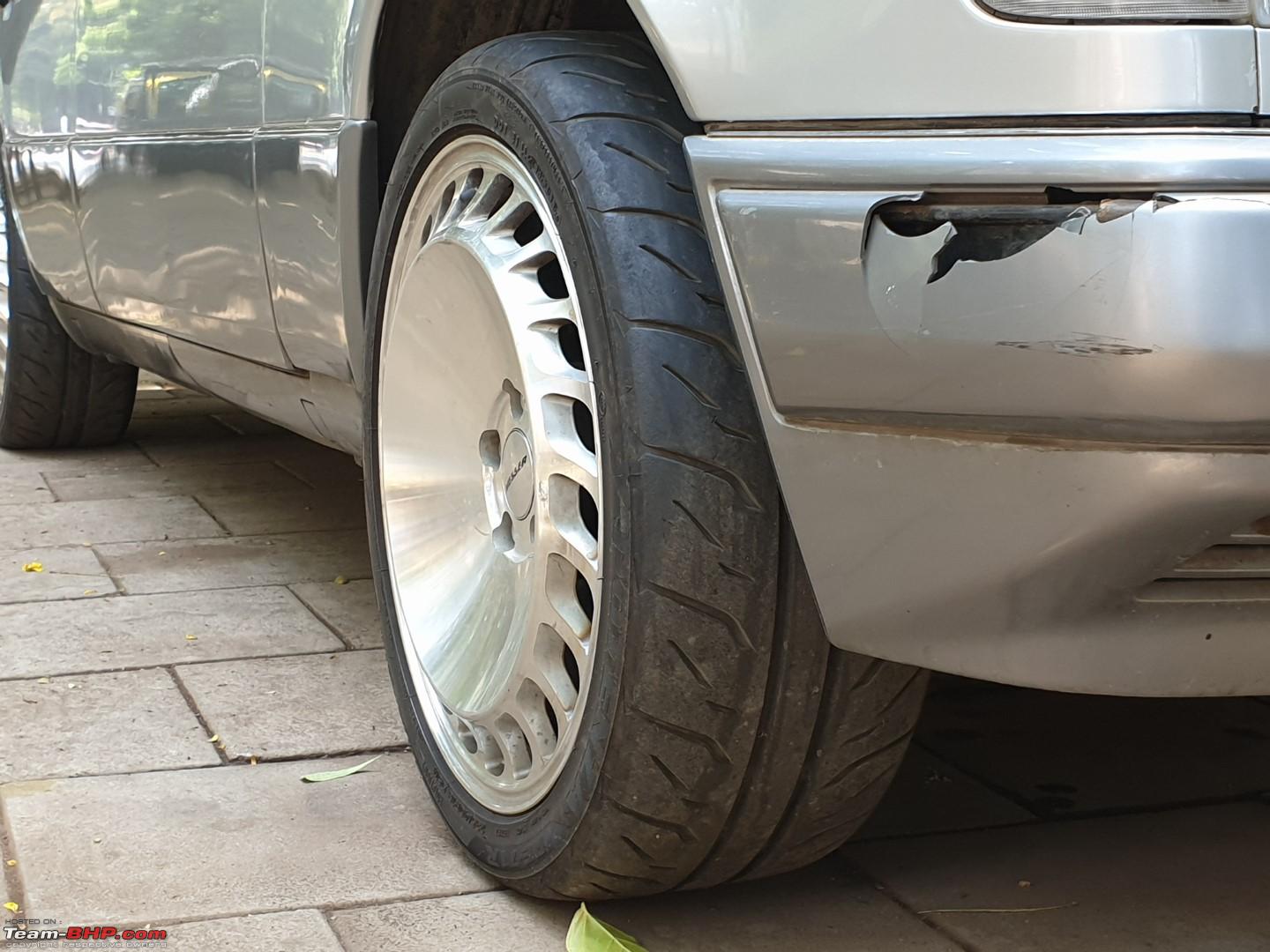

Spotted this W124 with an unusual set of rims in Parsi colony. Watchman told me it's a daily driver. While the style of the alloy wheels is a love-or-hate (wouldn't be my choice), there is no denying that this car had incredible presence . I passed it, then took a u-turn, parked on the opposite side and walked up to check her out. Had a couple of nicks / misses (e.g. missing star at the back), but overall, she looked beautiful. Child seat always tells me it's an informed owner.
