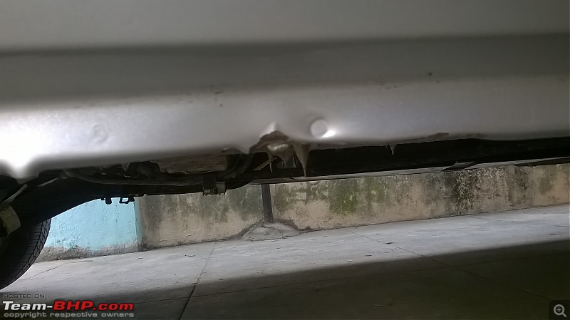

Has anyone come across issues with rust in the running board? . My guess was that this was caused by flexing of the running board ends while lifting the car. The SA confirmed it on the previous visit, need to check with them on what can be done.
Is this a design issue?, i have never seen this in other cars, the running board metal protrudes towards the edges, this fouls with the jack when lifting the car.
Attaching pics:
knaveen is offline

My post regarding the above issue:
http://www.team-bhp.com/forum/test-d...ml#post3201660
john doe is offline   (1) Thanks

Did a 800km trip in the past two days. The Nano performed brilliantly. This is my 4th highway trip on my Nano , noticed that the AC was not effective as it is used to be. Initially i thought it was the extremely hot weather but on the return trip, i was driving in at night and the issue persisted. Looks like the thermostat was cutting out too early, there was air coming out the blower but not cold. Not sure if it was the icing issue mentioned earlier in the thread, as there was no reduction in airflow.
Visiting the service center this week for the rust issue, will have to check this during the visit.
