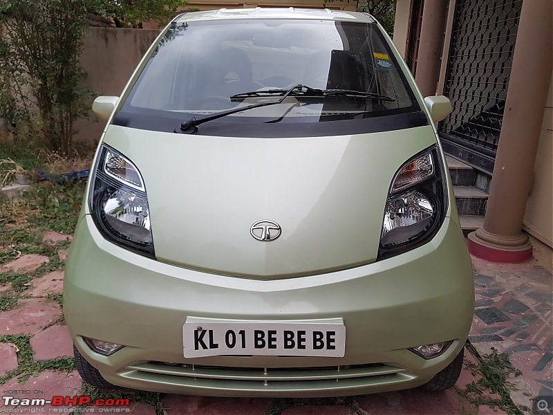

Changed both headlights to new genx type lights with clear indicator lens and "nano" imprint. Now the front looks better without the amber strip.
I thought about changing the front bumper to new genX type but i guess i'd leave that for now I'll miss the "storm trooper" style fog lights if i do that.
That is a really clean Nano. Do you mind sharing the numbers (price, kms etc.)?
Leave the front bumper alone. The Genx may not even fit. BTW, I cant help but notice that the chin spoiler is painted. Not so in my car. If you can, do change the rear bumper as the upper grille really helps cooling esp. when stopped or running slow. Or even better, why not do some DIY grille cutting in the existing one?
Yes, the chin was painted by the dealer (true value) while fixing the scratched bumper before they handed over the car. I will fix the rear bumper with cutout, had been on my mind since the day i purchased this for the very same reason - to reduce heat buildup.
Anyone know which is the headlight height adjustment screw? There are two at the back, one straight down on the indicator side and the other behind main beam side.
Figured this out. Its the one straight down on the indicator's side.
Sankar is offline

This is my old light, but it works the same for genx lights. The channel sort of plastic moulding you see in the photo above the adjustment screw is a guide which lets one access the adjustment screw from the top with the lights mounted.
