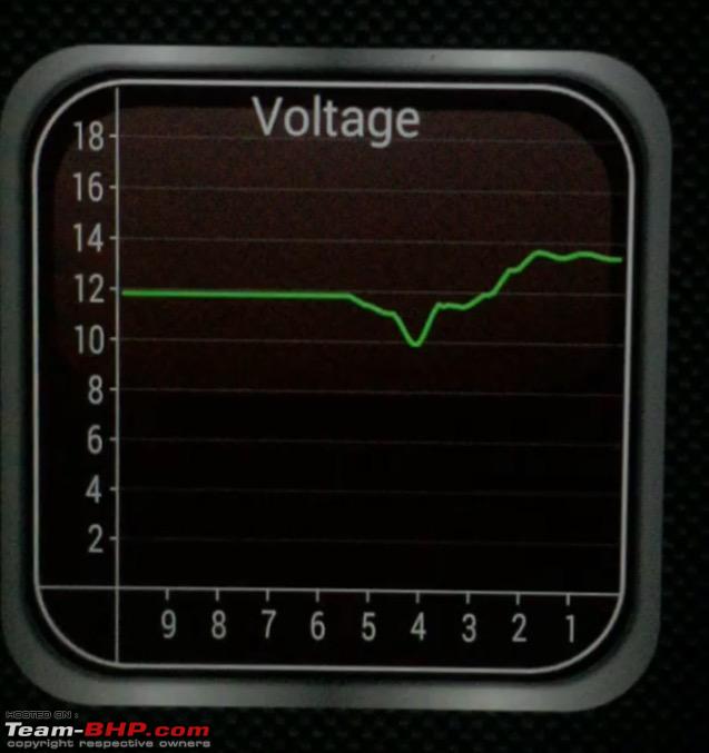

A starting issue has cropped up on the Nano. Irrespective of cold or warm weather, when I turn the key there is a 2-3 second delay before the engine starts to crank. I can hear the usual click sound after turning the key. Earlier, there was almost no delay between me turning the key and the engine beginning to crank. If I now let go of the key after a short moment like I used to, there is no cranking. If I am persistent and keep the key in turned position, the engine will eventually crank.
A couple of days ago I got stranded at a red light after the car refused to start after I had turned off the engine. I pushed the car to the side and after a couple of minutes and a few attempts, managed to start it up again after I realized that I need to keep turning the key to start up the engine.
The only pattern I have seen is that this problem is more likely to occur if the car is started after 10-15 hours of being parked. The longer the time for which the car is parked, the more pronounced is the cranking delay.
The battery is fine from what I saw through the OBD.
Is it the ignition switch? Or the fuel pump? Something else?
Tanmay K is offline

For the fuel pump, you could listen for the hum of the pump when you switch on.
I have this problem, but it happens if the car is run very hot (Hot day+Full AC+Traffic+2 hours of it) and then started after 15 minutes.
Since you have OBD, can you check to see if the battery voltage is dipping (approx 2 Volts) for the first two seconds after you try to crank, but before the starter is actually turning. If it is dropping, then the starter relay must be transferring power to the starter, but starter not able to turn the engine. If the battery voltage is not dropping immediately, then it could be a lazy relay.
Thank you for the insight. I checked the voltage graph. It seems the relay is ok, the starter might be having a problem. The voltage starts dropping for a second or two before I can hear the engine crank and continues to drop (at a faster rate) after the cranking starts.

I'm not sure if this adds more information; I hope so. For about 2.5 seconds after turning the key, the voltage stays constant and then drops after the cranking begins.

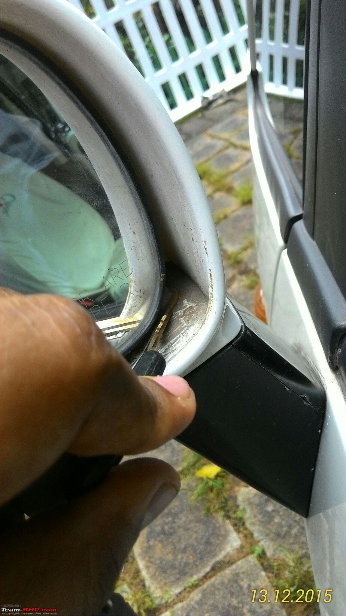

Don't worry, its not another issue. I leave my Nano parked outside the house. Not only is she exposed to Nature,but also to street urchins. Had been facing a problem of loosening of the left Outside Rear View Mirror (ORVM). Its due to these pesky kids turning it completely outwards. Last time, I had taken it to Concorde and gotten it fixed along with service. Since it happened again, I thought I should find out how to do it myself. Finally got around to doing it yesterday. Sorry I didn't take any photos at that time.
What you need:
2 13mm spanners
A flat head screwdriver (or something flat and rigid to seperate the cover)
The key is pointing towards the joint which is to be separated. Only the outer side cover is to be removed. The cover on inner side is only for aesthetics, I felt.
It is fairly easily to remove the cover. No heart-in-the-mouth inducing cracks are heard.
There are two nuts on both sides of the shaft which tighten a spring. This tightening is what makes the ORVM from flapping in the wind. The nut at the bottom is easy to access once the cover is removed.
The upper nut has to be held while tightening. No need to remove the mirror for this. Let the spanner in through where I have shown with the key. TATA nano - List of ALL issues-p_20151213_113814_1_p.jpg
Tighten to your content. Put the cover back and you're done!
