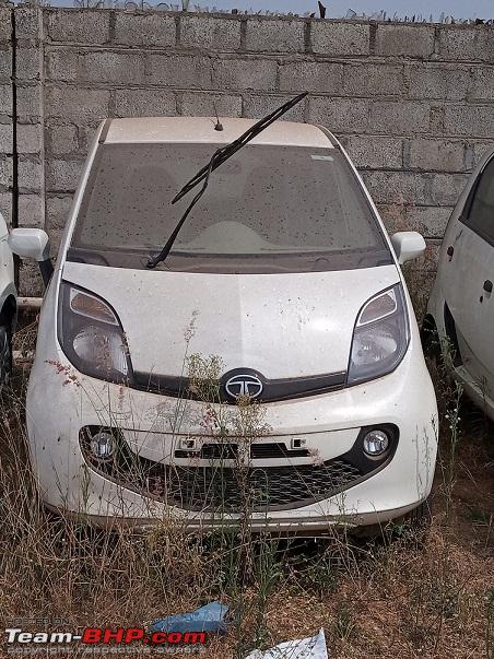

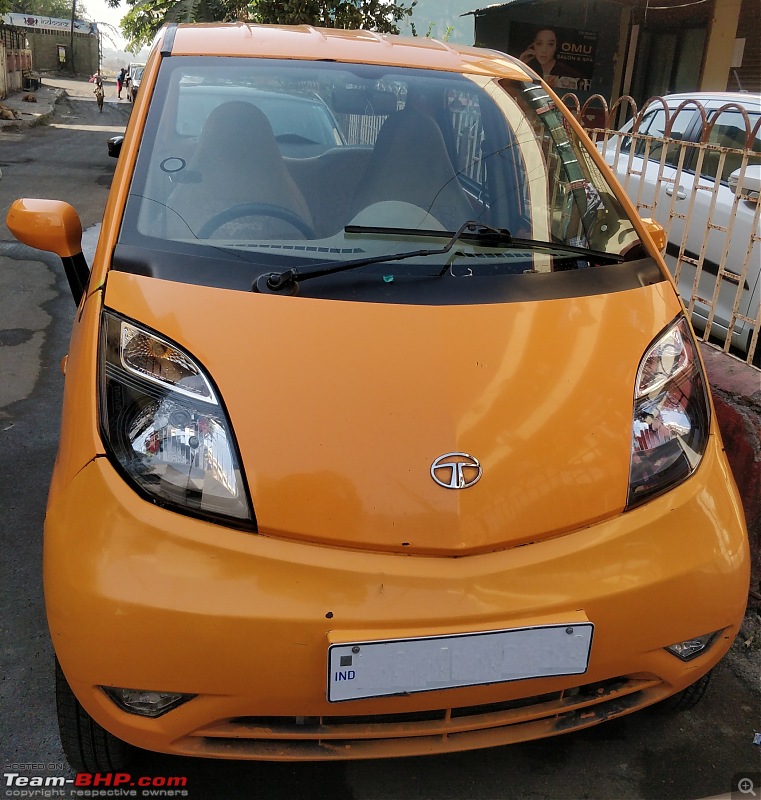

thought many experts of nano read this thread hence posting.
Many showrooms in b'lore are quoting nano has stopped production and it is only on full payment they would deliver it , only XT variant is available at Rs 3.49 lakhs (after waiving off rs 22 k on insurance).
I got a 2017 model in mysore showroom, they quoted rs 3.38 laksh as someone booked and did not take delivery. As it is already 2 years old how much discount i could seek. I had quoted rs 2.75 lakhs.
Some pictures are enclosed, if some one has negotiated befor such deals pls help.
I think the tyres have gone & might have become hard , i might have to factor about rs 8 to 10k for tyre replacement.
Ananth

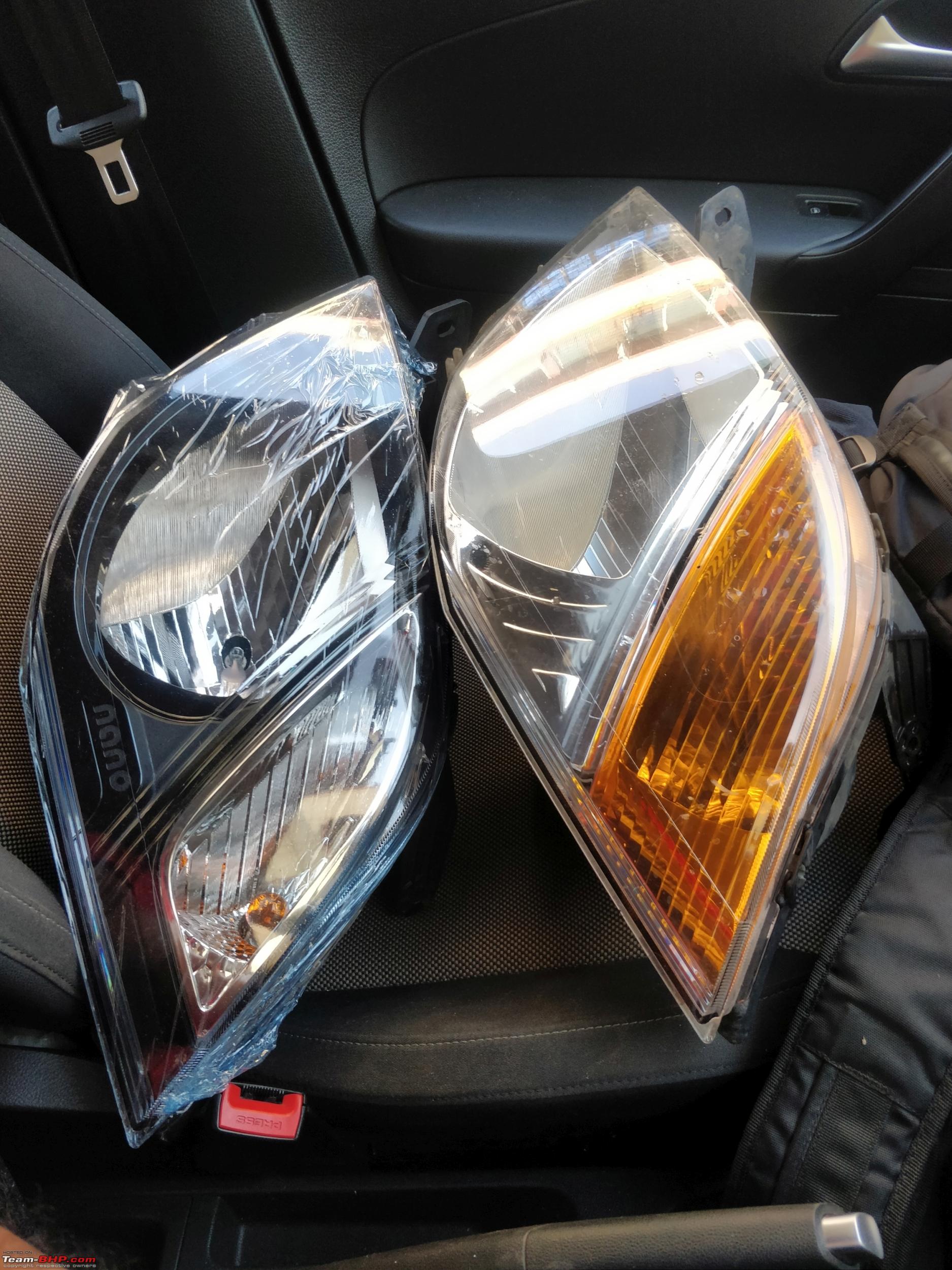

Haven't updated for a while since I've been a little busy, so this will be a slightly long post. Please excuse.
1. Got a new set of headlamps for the Nano as the old ones reflectors have gotten too dull, the new ones are a direct fit and make the car look better. Cost: a little under Rs 3800 for the set.

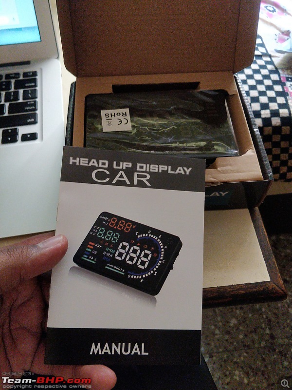

5. Have got an HUD system that plugs into the OBD port from AliExpress... Have always wanted the full trip computer of the GenX Nano but in the old one. Cost: Rs 2300. Have an inter-city run to do this weekend. Will try it out then and report.
