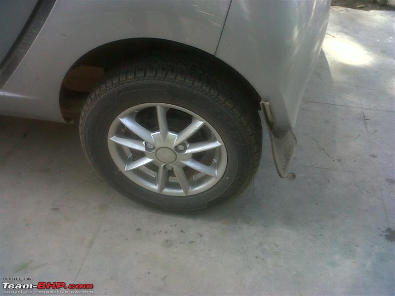

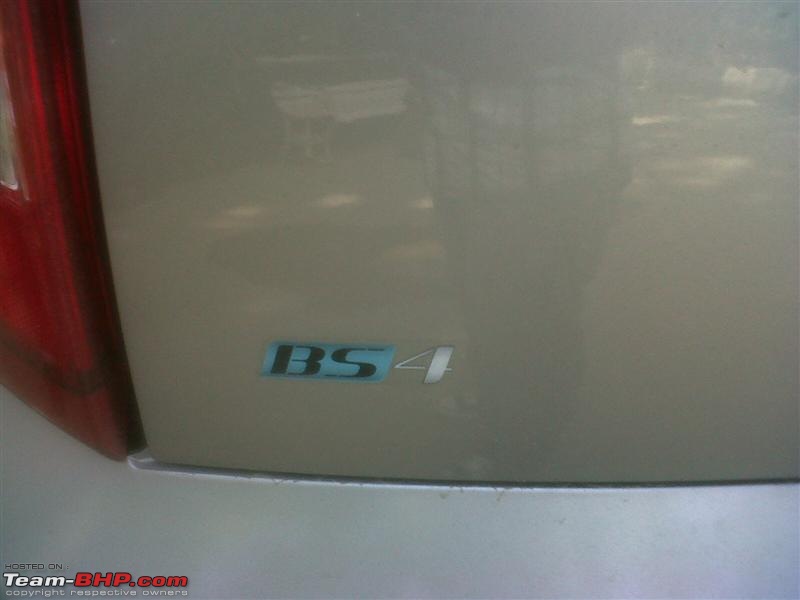

The cost of alloy is 2100 pops. they are giving back 370 for the disc. (of new car)
Booked a Nano Lx lunar silver for a friend on her insistent.
As far as LH mirror is concerned they can be fixed by drilling holes on the door. Its a easy job if you know how to properly use a drill.
Finally arrived. I must say this is the first dealing with TATA Udaipur (Classic Motors) and man they are really slow. It took them 23 days to get this color and alloy. Overall a wonderful experience, GM's personal driver came to deliver it 180kms to my place. Look at the bright side I got a BS4 for old price.
1. One major flaw is that there is no indicator for AC. So you will not know until the cold air blows. And it does very slow here in the hills. A bright Rs.2 Led light wouldn't have hurt.
2. Sharp corners and it will come on two wheels,. Managed to do it thrice. , Not that i recommend it to do.
3. Like I said before drilling for LH mirror is a fine job with lot of patience not to chip the paint.
4. Alloys do help. they gave me 425 each for steel wheel. Hence alloys set me back by 1600 each.
5. Wish there was a glove box in top end model atleast.
4. power windows switch is placed weirdly.
5. Lo...oot of panel Gaps.
6. Got freebies, seatcover, mudflaps, two set of mats.
