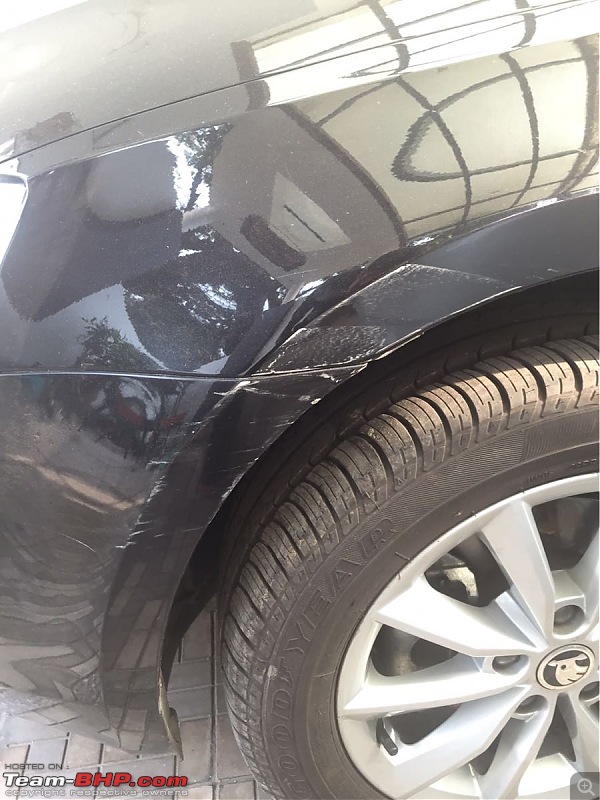

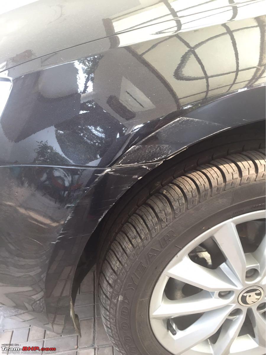

Saturday night a dzire driver did this, while my driver was behind the wheel. What options do I have to get this corrected?
Don't seem to be any dents, rather just the Swift's paint has rubbed off on your body.
Best option would be to detail it and remove that paint.
Alternately, the cheaper option would be to use kerosene / diesel - diluted with water. Just be careful to not get too aggressive for fear of visible damage to the paint.
