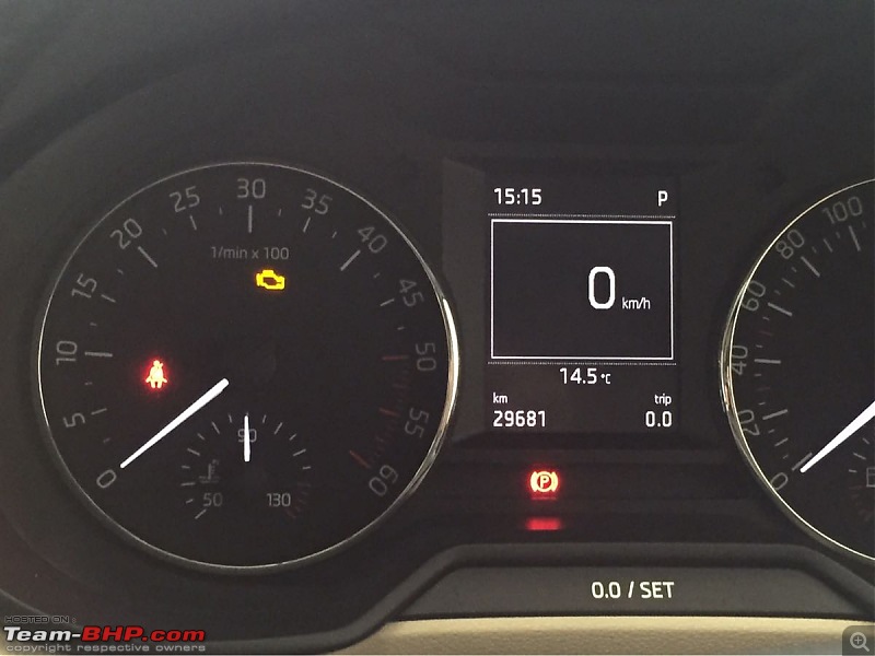

The battery came from my FNG. First they started the car using their own service battery and then affixed the car's original battery. The car threw up number of errors but after 2 kms of driving, they went away. There is this one 'Exhaust Inspection System' light that is not going away. I was asked to let the car run for 30 mins in order to charge the battery. After that time, I restarted the car and it cranked readily. However that light is still glowing. I am planning to visit the service Center tomorrow and get both this light and battery checked. Currently the State of Charge of the battery is 100% according to the MFD. Any idea about this light?
Thanks in advance.
Shreyak.
Thanks in advance.
Shreyak.
The battery is dead again. SOC-0%. I have called the RSA to arrange for a jumpstart technician in the morning tomorrow at 5 am when I am planning to leave and would be taking the vehicle straight away to the dealer at Noida. I have also asked my FNG person to provide me with a service battery in order to start it if RSA doesn't respond. What should I do? Should I ask the RSA for a flatbed?
It's urgent. Please help.
Thanks in advance.
Shreyak.

Your battery is gone and has a dead cell for sure. Just ask for replacement under warranty. You can inform your service centre about it and ask them how they want to proceed.
vinit.merchant is offline   (1) Thanks
The battery is dead again. SOC-0%. Should I ask the RSA for a flatbed?
It's absolutely safe to drive once you have the car jump started. No need for a flat bed. I won't suggest using a service battery.
adi_petrolhead is offline   (1) Thanks
Thanks. Had called RSA, asked them to arrange for their technician for tomorrow early morning to Jumpstart the vehicle. Been three hours and still no response from them whether they are sending the person or not.
In the meanwhile, I had called up the same FNG and have asked them to get their battery. Now a mechanic from their garage will come to my place in the morning tomorrow and he'll start my car with the service battery and then affix the original one like it was done earlier today. I'll straight away drive the car to the dealership early in the morning from where I had taken an appointment to get the battery checked.
Adi, I had told my SA that I won't be able to leave the car with them for two days just to check the battery. To this he replied that they will fix the service battery in my car and keep my original one till next sunday when I will be visiting them again. I hope there's no harm in this if he sticks to his word tomorrow?
