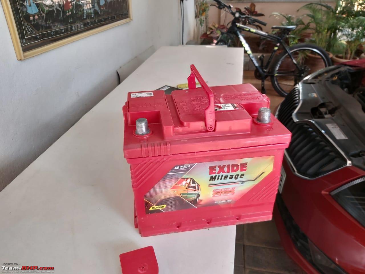

So my TSI battery gave up the ghost today luckily while comfortably parked in our garage, and not in at some highway stop in 45 C temperature!
Which one do I go for? Exide suggesting: http://batteryboss.in/product/exide-mreddin60/
The 60 AH one should do just fine since your's is the TSI. I tried a higher capacity one from Exide but it didn't last any longer. The black battery cover didn't fit either since it was slightly bigger.
The 60AH replacement shall do fine for the TSI Variant! Diesel requires a higher rated capacity.
I'd prefer Amaron over Exide, due to more positive feedback.
However, the advantage of Exide is that your some SAs try to disclaim warranty over non-OEM batteries, which is totally unjustified. Buying Exide will only prevent that conversation from happening, no other advantage.

Thank you both! Spoke to a local Exide dealer and struck a deal for 6.2K (exchange price) for an Exide MRREDIN60. Will come over shortly to fit it.
Price very reasonable in my opinion. A neighbor with a Merc was weeping over his 20K AGM battery cost!

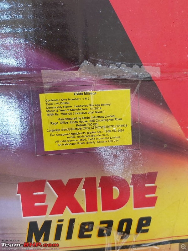

Replaced battery with an Exide MLDIN60 manufactured in January 2019. New battery voltage is ~13.70. Started up and a bunch of errors popped up with ESC & TPMS errors. Restarted and drove for 200 metres and the errors started disappearing.
Relieved at the smoothness of the exercise.
