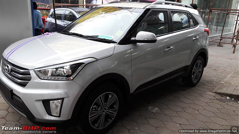

Adding pics taken during delivery yesterday.
All shining & ready for duty
Love the Front look
