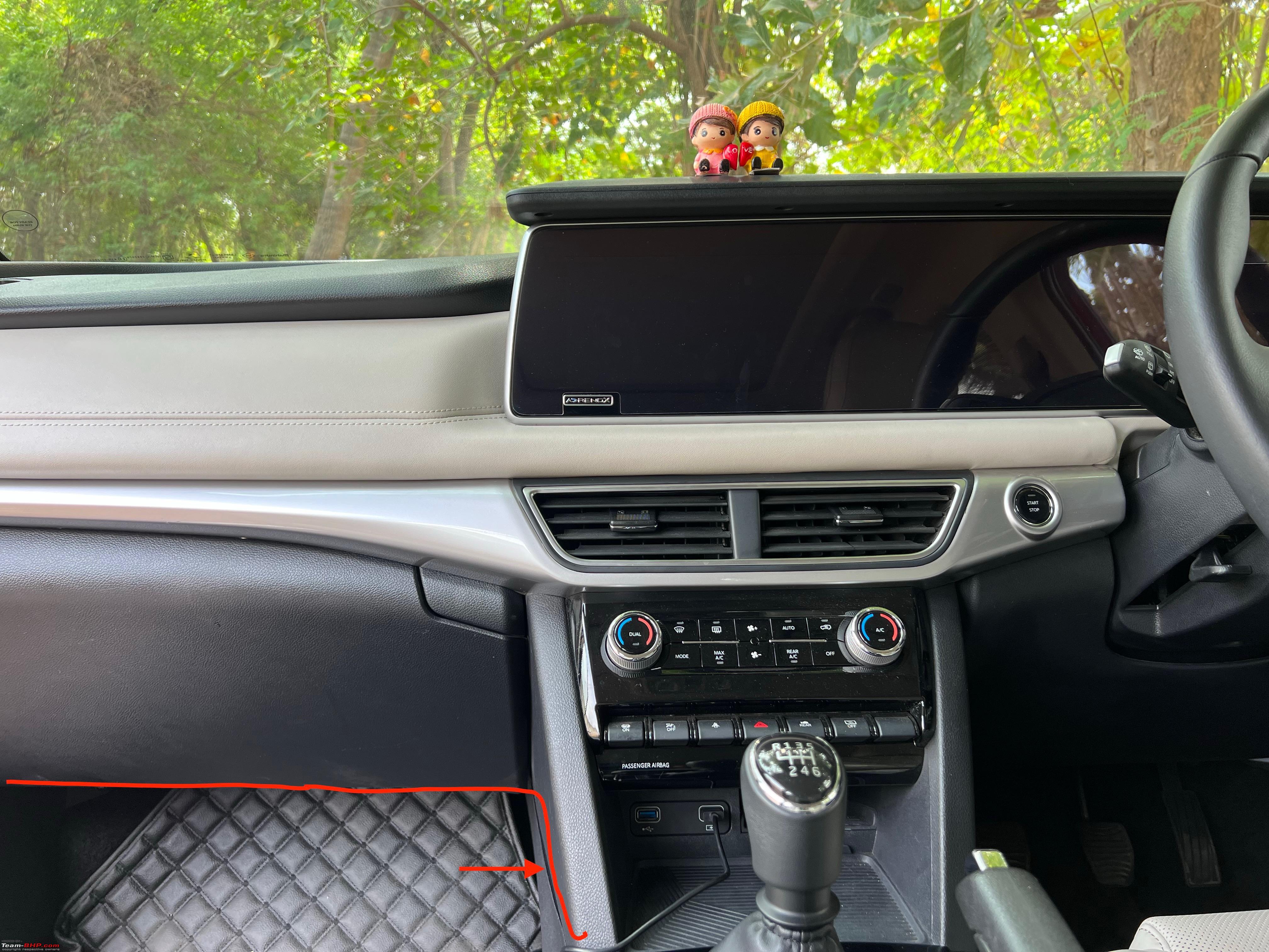

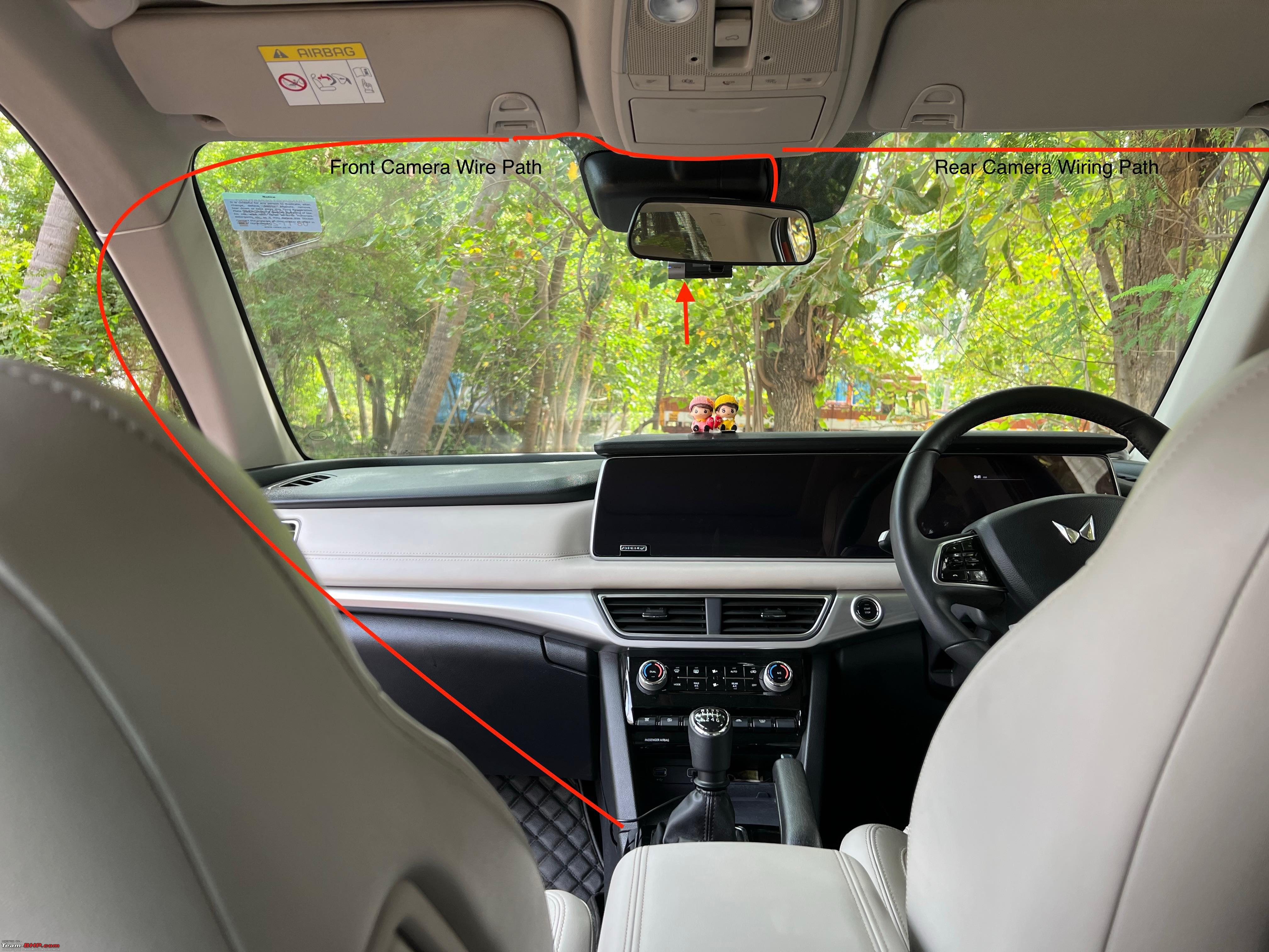

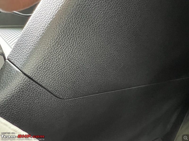

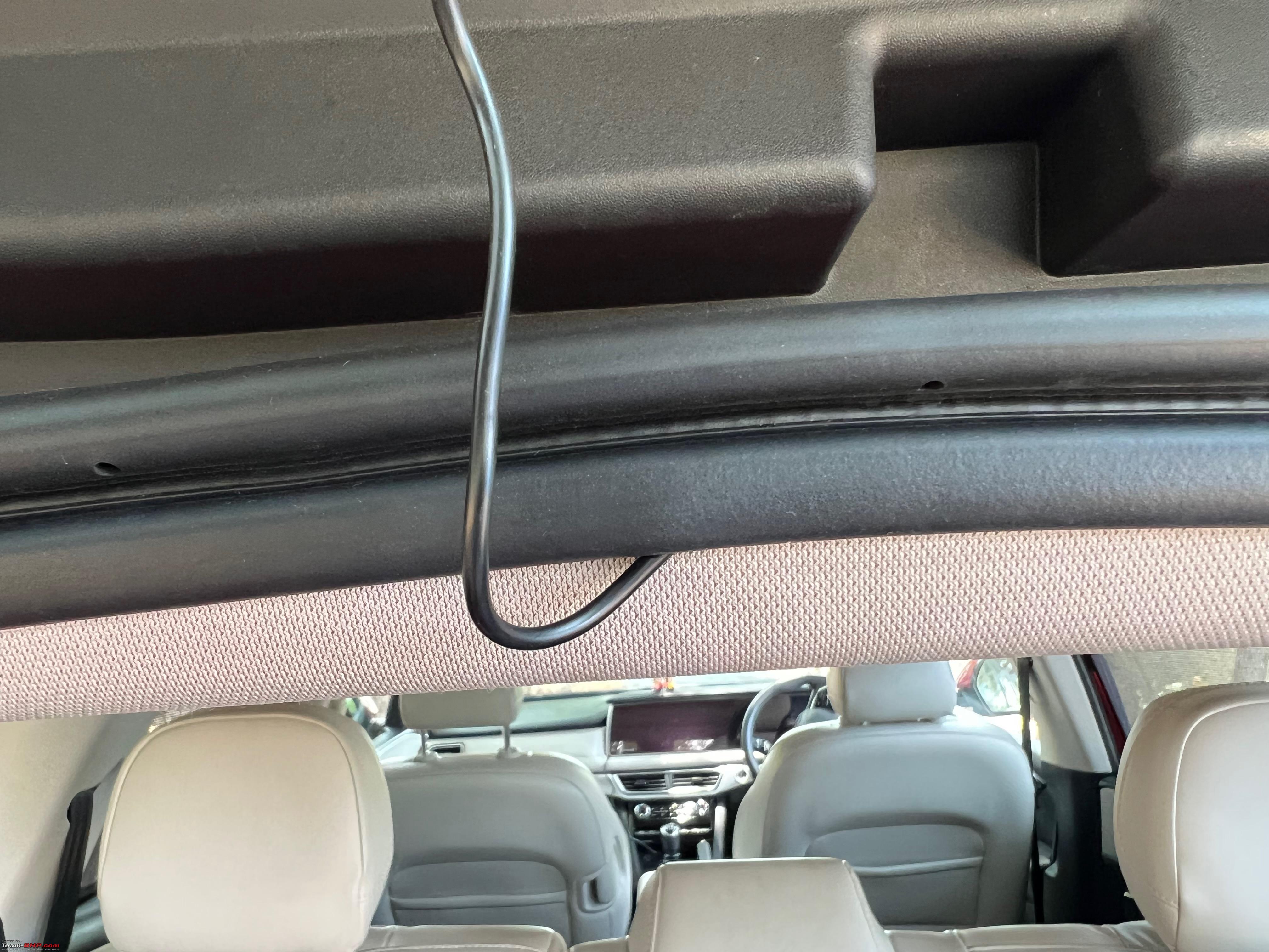

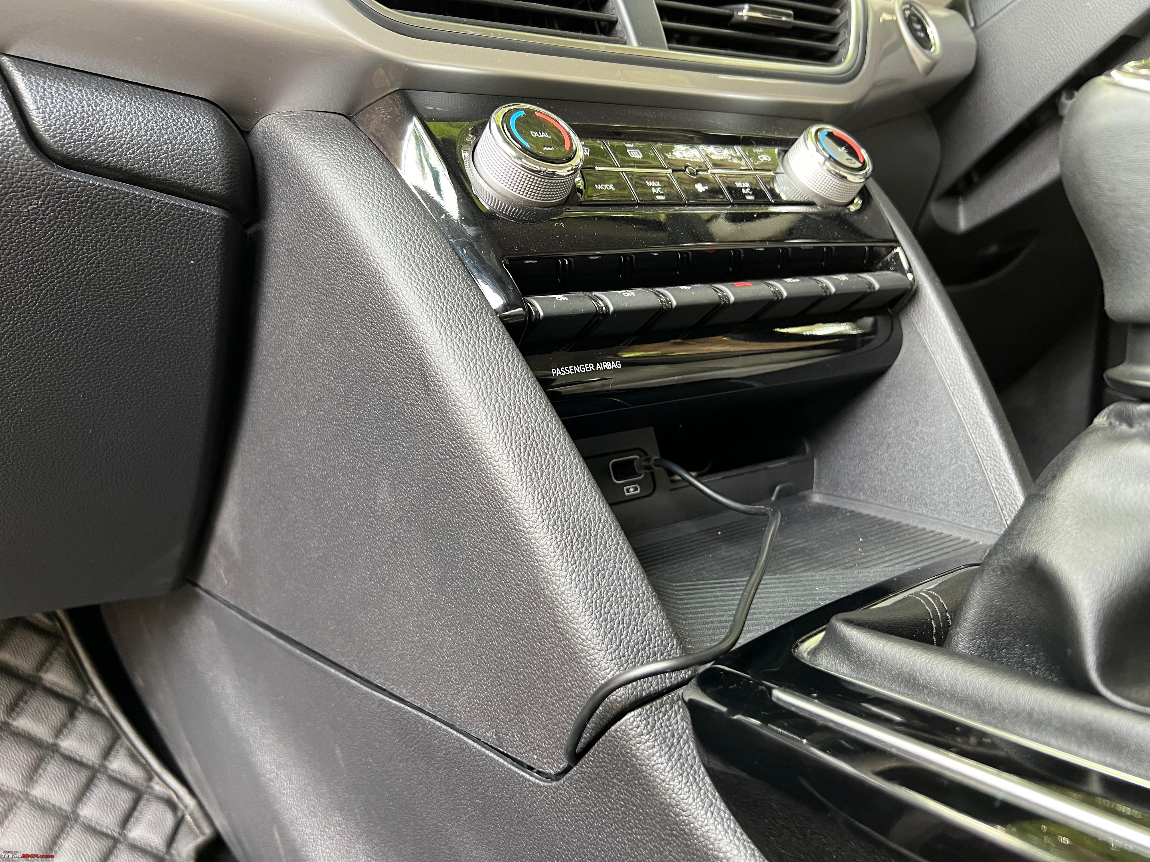

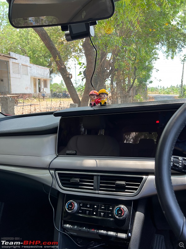

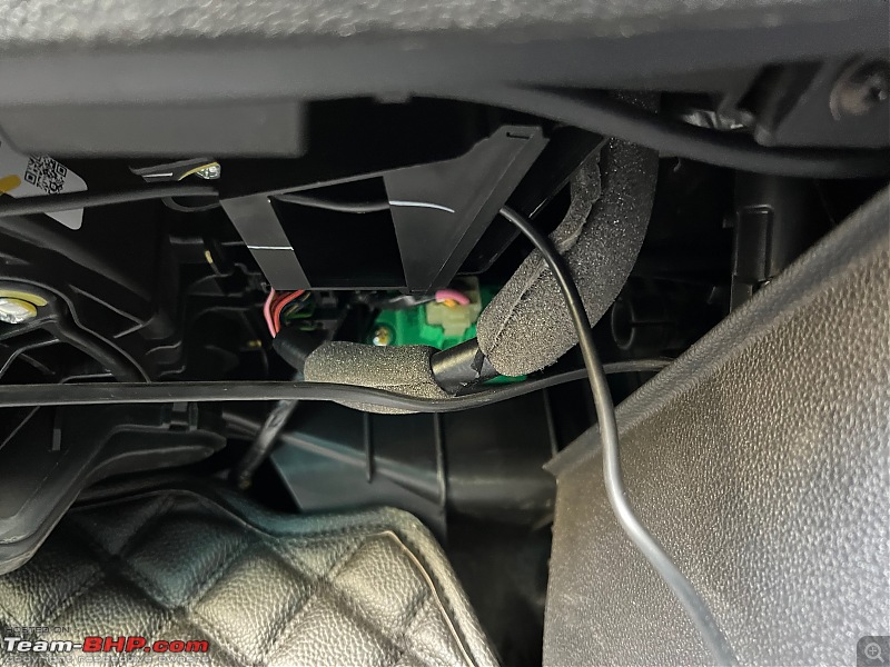

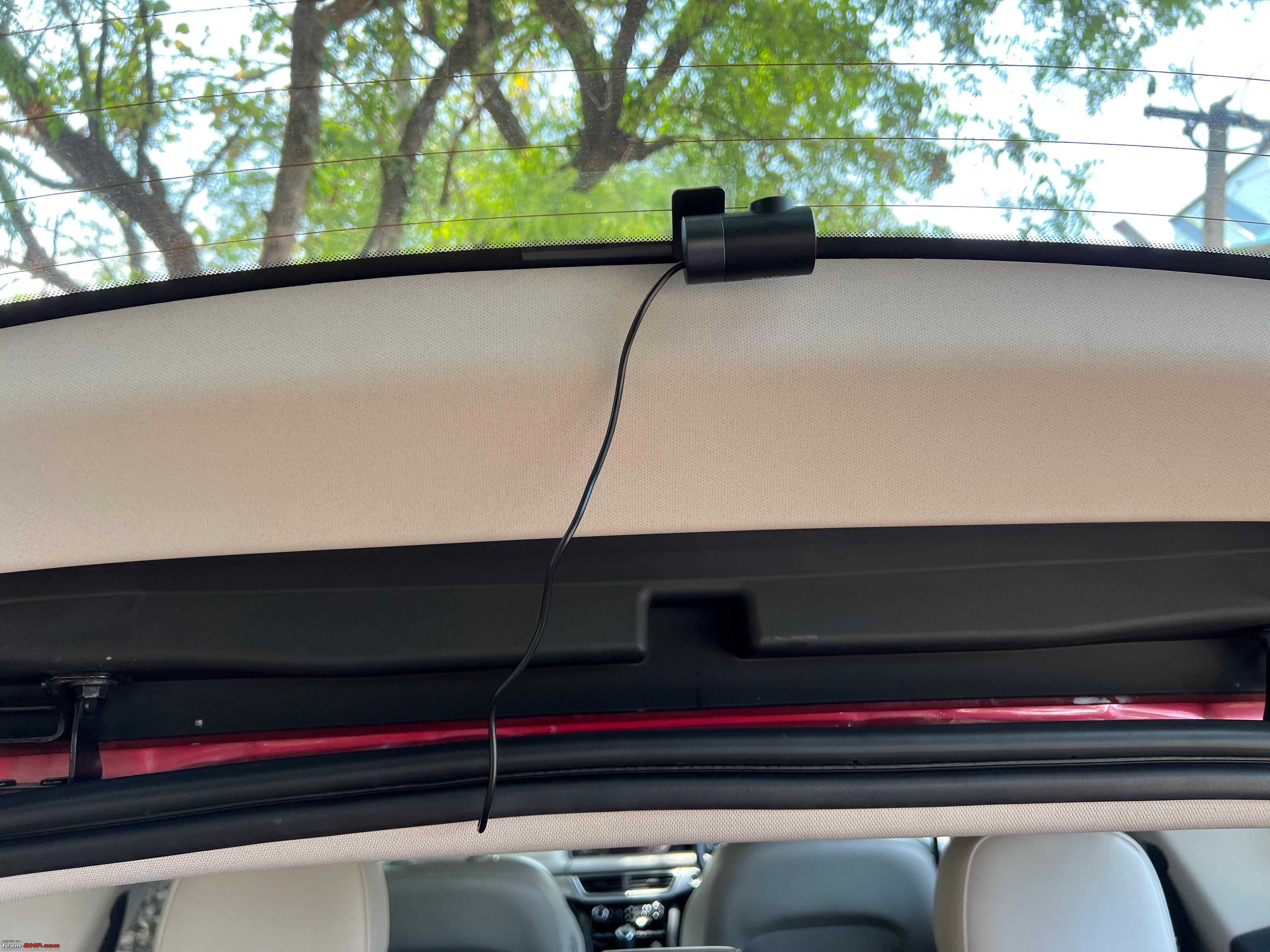

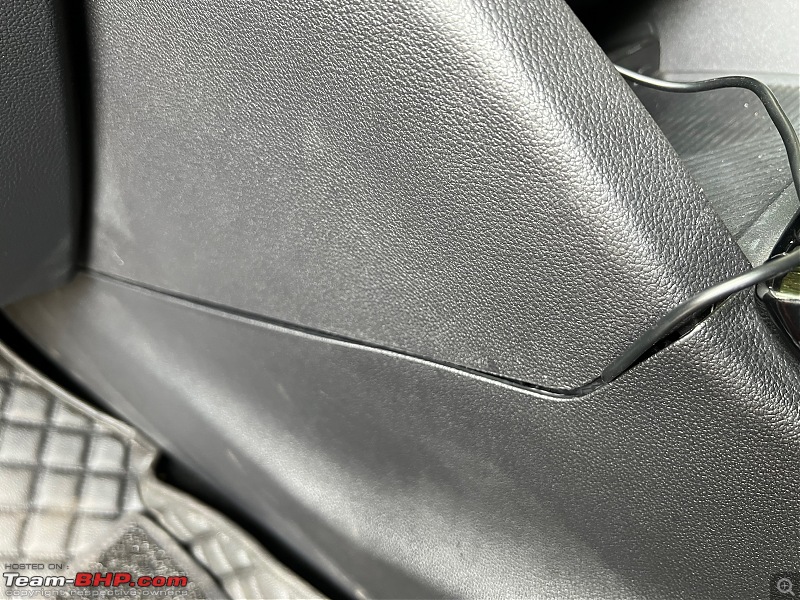

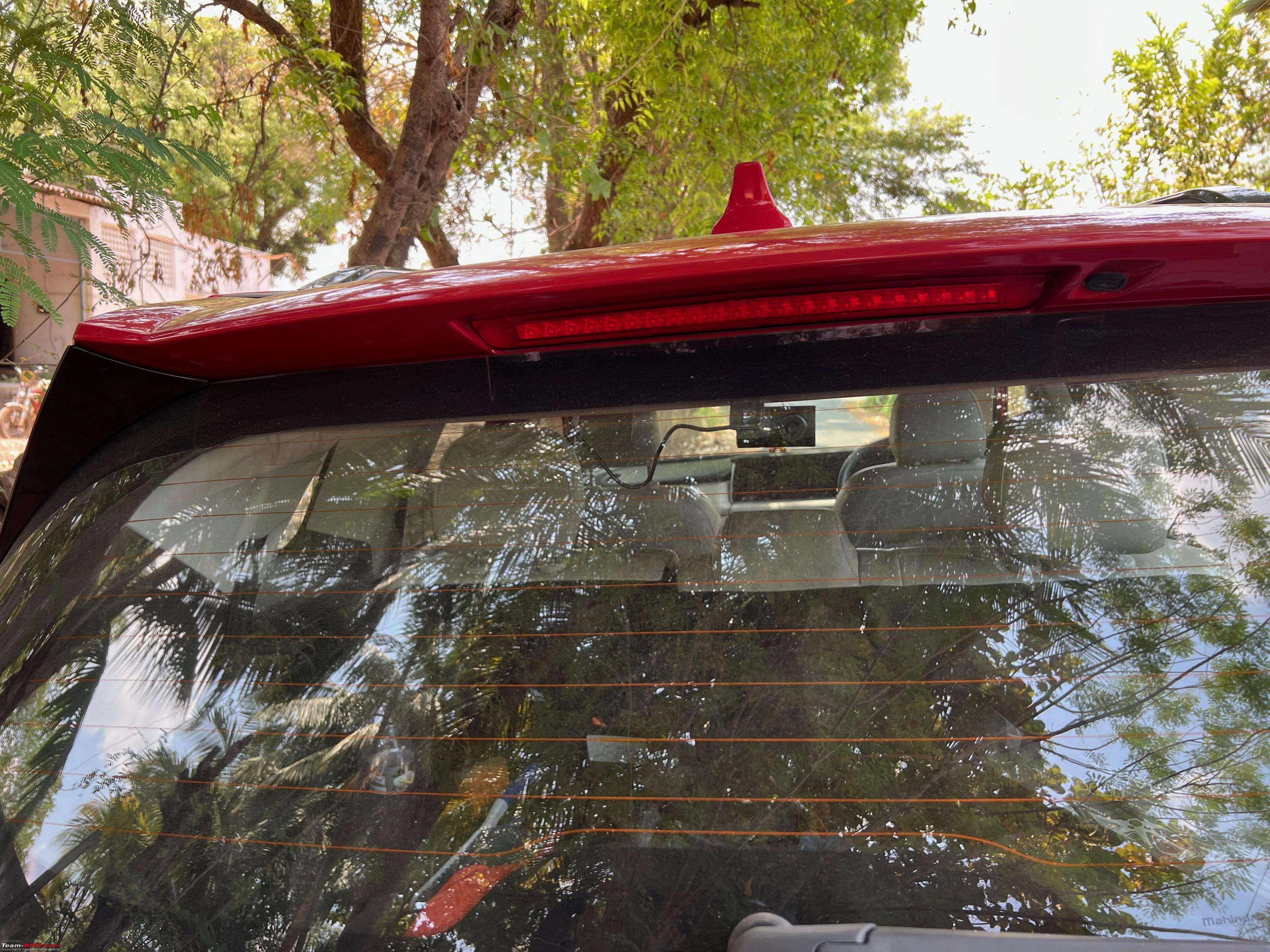

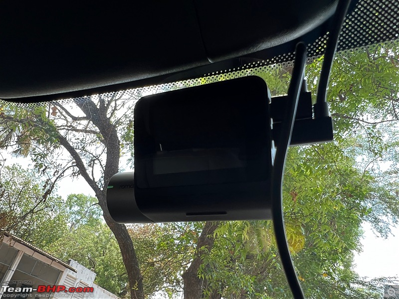

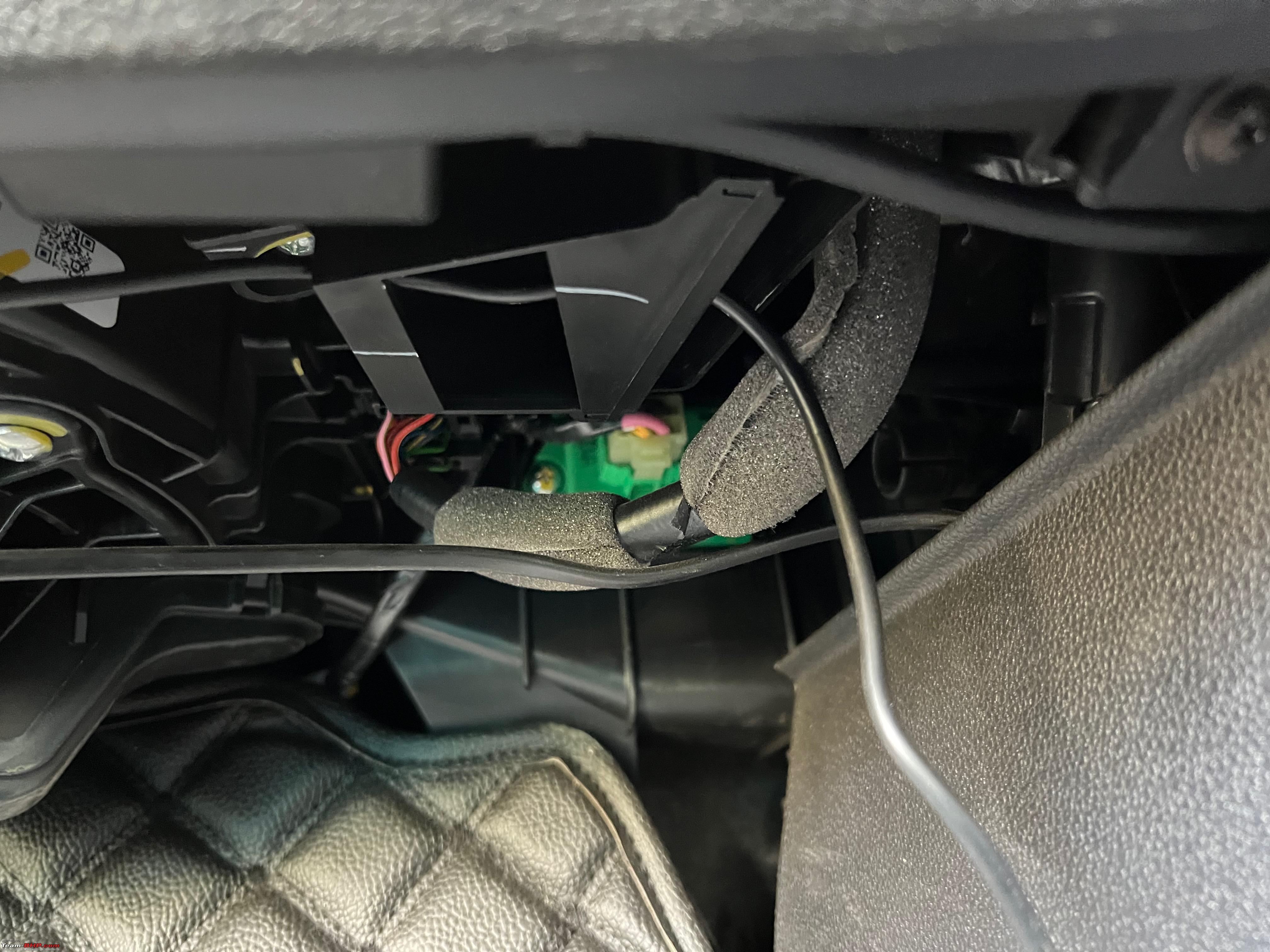

Dashcam Setup
After deliberating for almost 6 months, bought the 70mai Pro Plus+ A500S Dual Channel Car Dash Cam. I wanted to film the installation to show you guys and was hoping I can complete in 30 mins. Uh ! No. It took me under 10 minutes !! I setup the Timelapse for every 30 seconds and here is the video output. Feels like a lightening setup. Eh ?
The real cam cable was more than enough to cover the full length of the XUV.
It was pretty easy doing it myself with the prying tool. Here are some photos illustrating the wiring path for rear camera.
Red Rage - Mahindra XUV7OO - Initial Ownership Review-rvwiretuckedin.jpegRed Rage - Mahindra XUV7OO - Initial Ownership Review-rvwire1.jpegRed Rage - Mahindra XUV7OO - Initial Ownership Review-rcwiring2.jpegRed Rage - Mahindra XUV7OO - Initial Ownership Review-rvwiring3.jpeg
