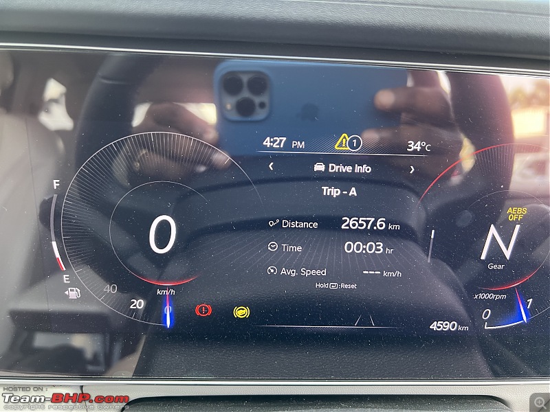

3000 km Update
FE - City driving FE has improved to 10.5 kmpl from the earlier 9.4 kmpl. No highway runs so far. Will update in the next 2 weeks, once I complete the next 1000 km.

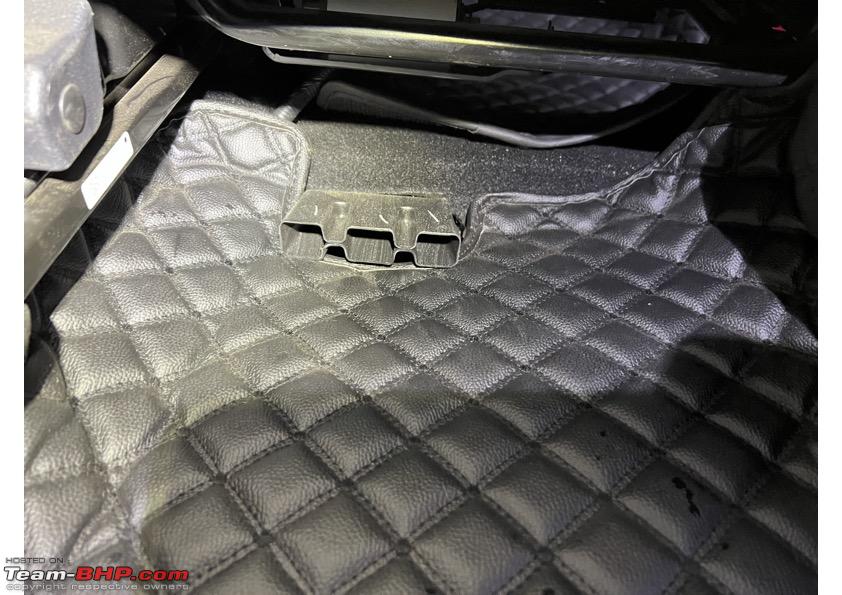

On one such occasion, I took out the OEM mat from the 2nd row and noticed that the mat had all along been blocking the AC vents under the driver side seat.
Before
After
Now the AC is a little bit more effective. But still not as great as the XUV5OO.

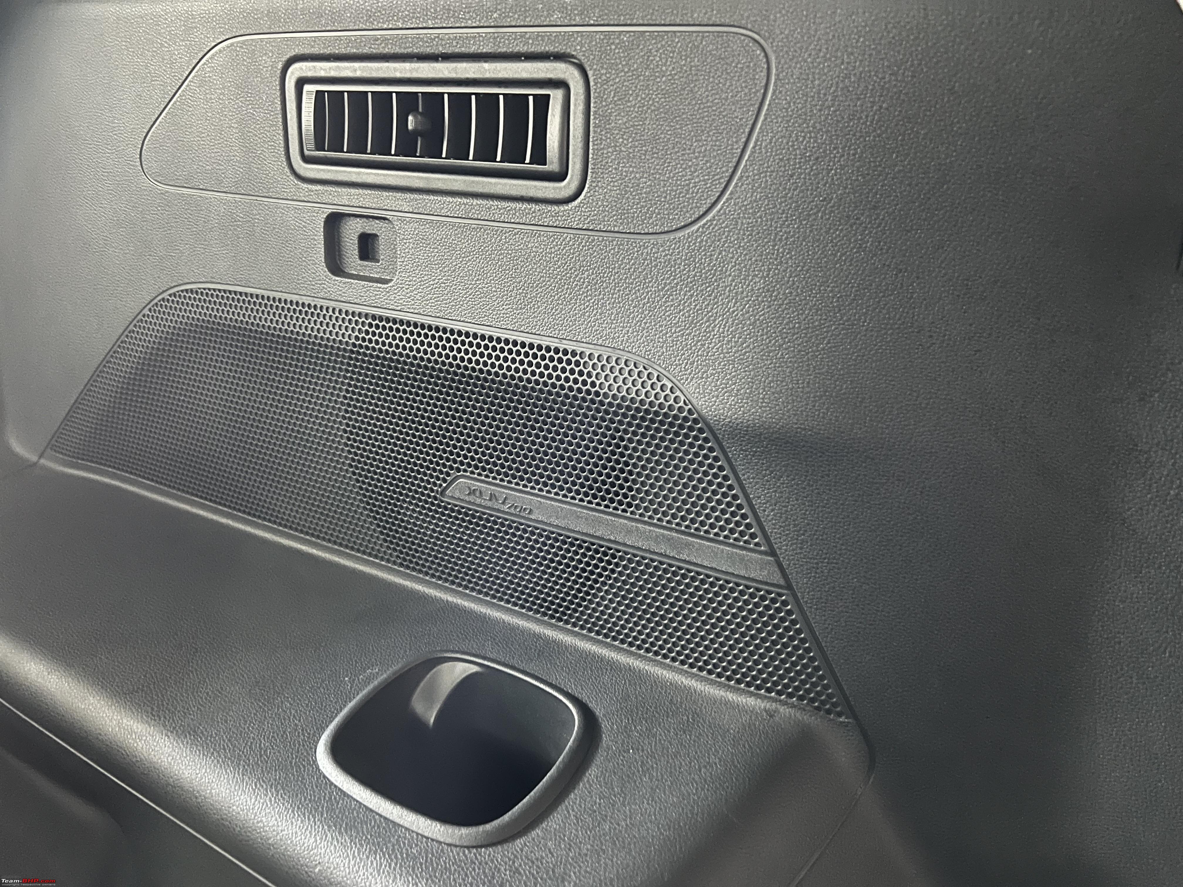

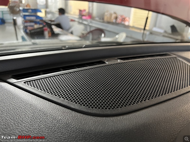

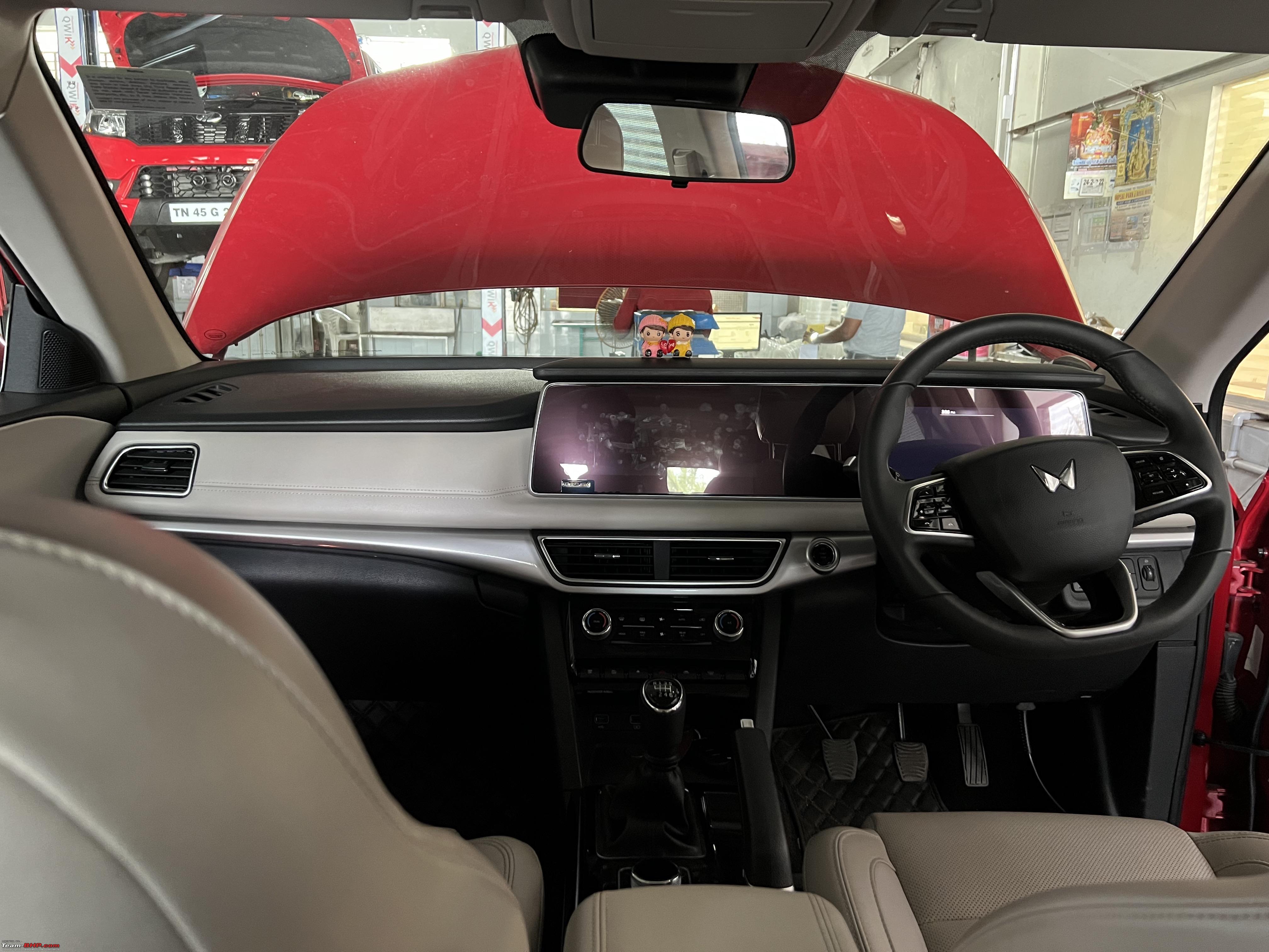

What an embarrassment today at the service centre !!!!
Over the weekend, during the long drive, the family remarked that the music volume doesn't reach the last row and that the speakers don't seem to work. I was like, yeah it should. Take it to the service centre today and I being pretty "famous", the whole crew is on the floor. After almost a 10 mins of hush hush conversation between the folks, the Service Manager comes up to me and these are his exact words verbatim - "Sir, as you might know AX7 has only 6 speakers (shows the physical speakers) and the one on the dashboard and at the last row as woofer/subwoofer systems and not really speakers. In the past, you made us aware of things in the 700, that we were not informed off and when you mentioned this over phone, we thought this was another such instance. We had to contact Mahindra, go over the manual/training doc to confirm sir. That's why we wanted to inspect the vehicle in person. Otherwise we would have informed this over the phone itself"
I then was searching for a rock to hide under !
Red Rage - Mahindra XUV7OO - Initial Ownership Review-front-woofer.jpegRed Rage - Mahindra XUV7OO - Initial Ownership Review-subwoofer.jpeg

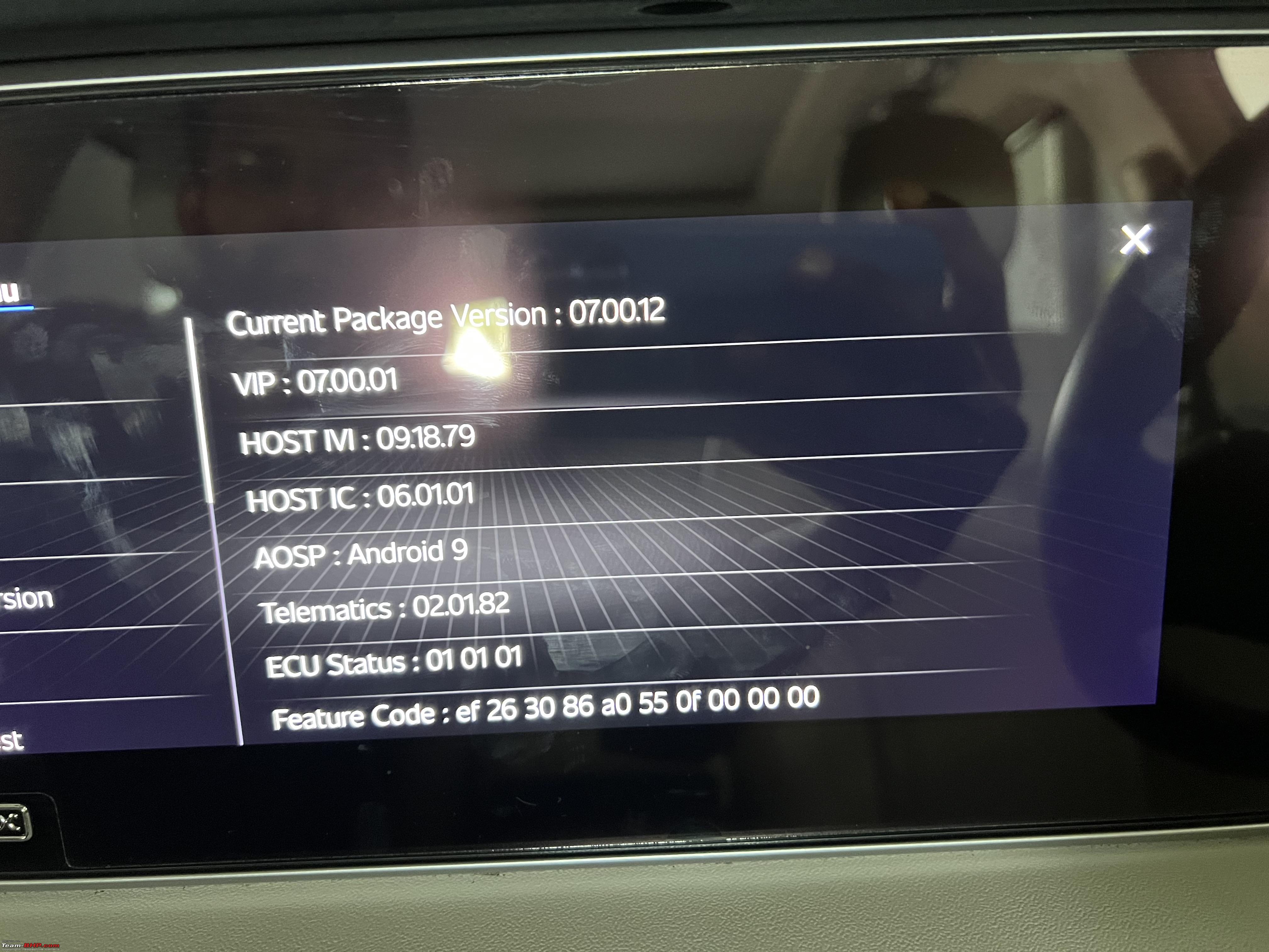

Anyway, the chief mechanic, who is on "hey bro" terms was laughing with me after the village left the floor and he remarked that I could get the long pending software update done, while I search for a rock to hide under. And so my version jumps from 06.00.82 to 07.00.12. That's a weird software versioning btw.
Red Rage - Mahindra XUV7OO - Initial Ownership Review-old-software-version.jpegRed Rage - Mahindra XUV7OO - Initial Ownership Review-new-software-update.jpeg

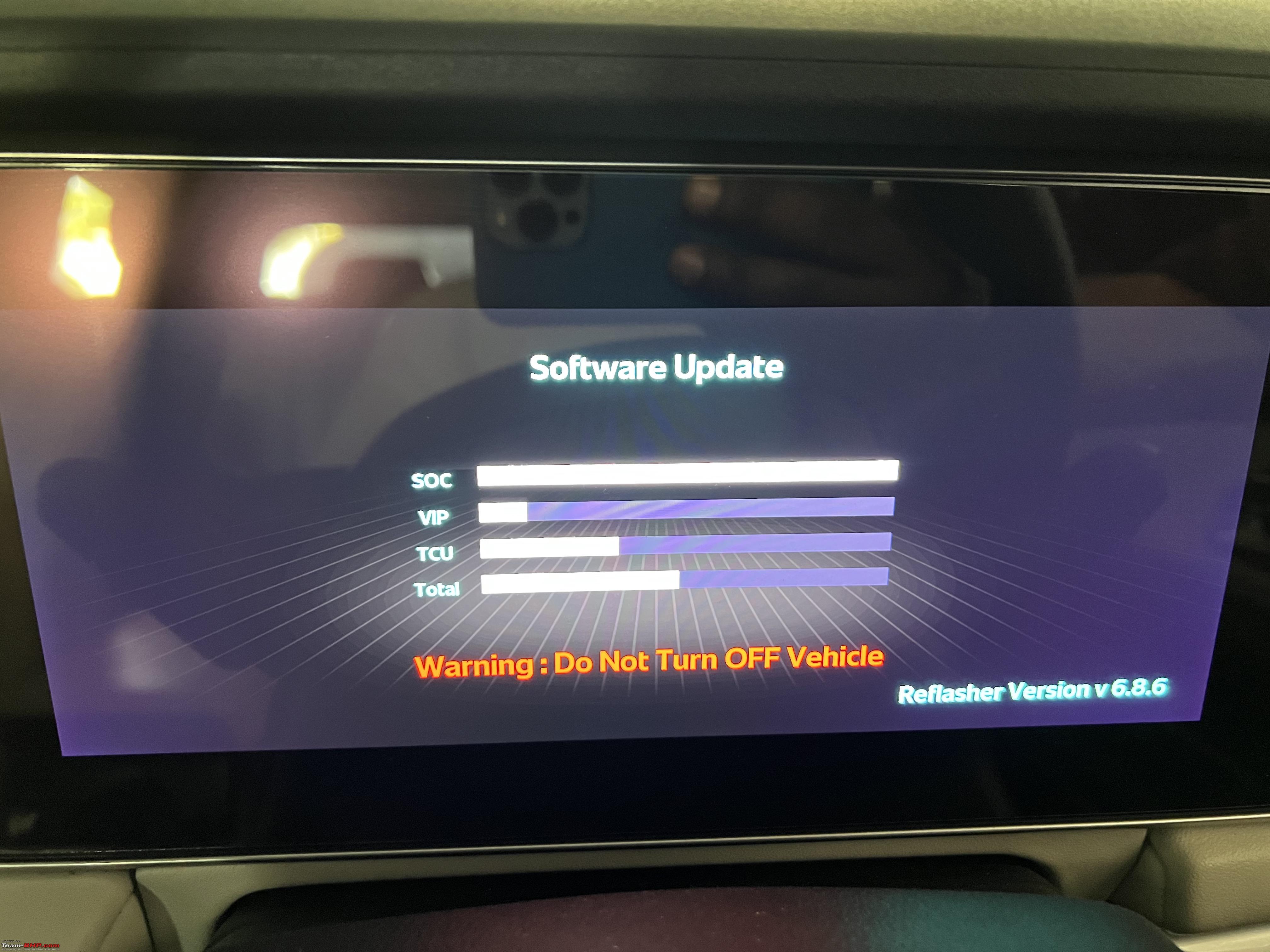

Anyway there were two updates. One they call it "The Software" which gets updated via a USB drive. I'm guessing this updates the Infotainment/MID etc.
Red Rage - Mahindra XUV7OO - Initial Ownership Review-flashing.jpegRed Rage - Mahindra XUV7OO - Initial Ownership Review-software-update.jpeg
And then the next update is a wired update, that updates the MCU/20 odd ECU control units via the OBD2 port.

In all the process took about 20 mins. They disconnect the battery after one step is completed. Didn't ask why though. Next time perhaps.
The interesting part after the MCU update was the vehicle wouldn't crank. The chief mechanic was least worried and was trying to crank for like half a dozen times and remarked that that's how it works ! I'm glad he didn't have to tilt the vehicle to 45 degrees.
And now. the hill hold error keeps popping up now and then. I have to restart to make it go away. But looks like a bug in this version. I didn't have this issue in the earlier version.

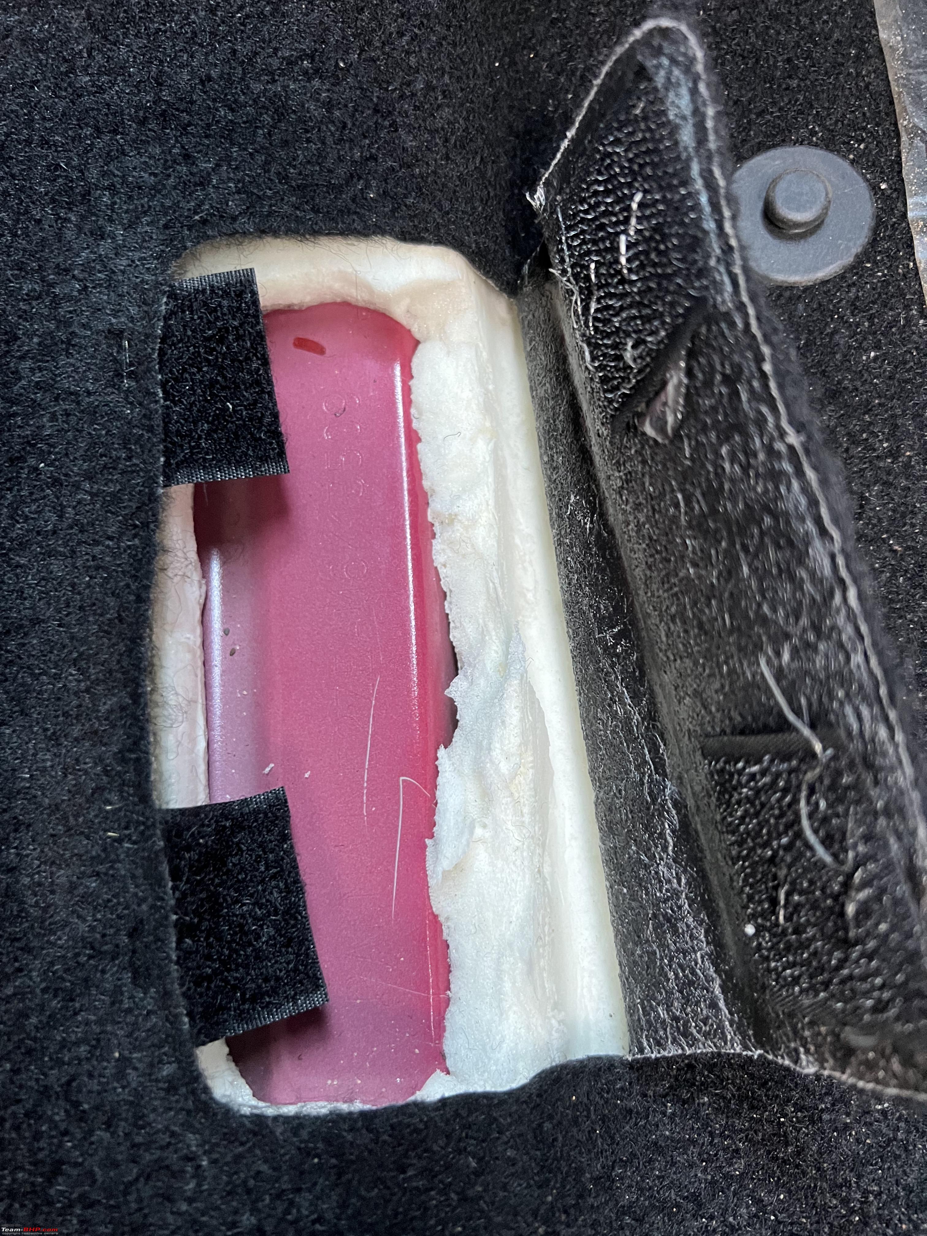

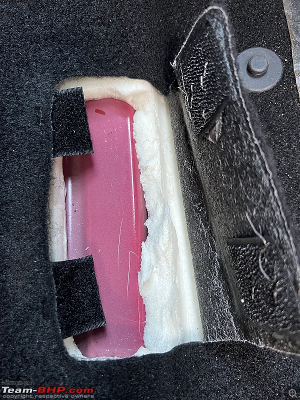

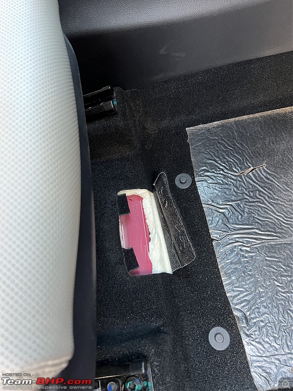

Just under the driver seat, you can get to see the floor padding on the vehicle. One of the reasons why this vehicle sounds so quiet.
Red Rage - Mahindra XUV7OO - Initial Ownership Review-padding-view.jpegRed Rage - Mahindra XUV7OO - Initial Ownership Review-closer-padding.jpeg

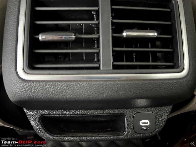

So nice touches here and there like this illuminated USB Type C charging port. I use my mag charger with this port.
Red Rage - Mahindra XUV7OO - Initial Ownership Review-illuminated-typec-charging.jpeg
