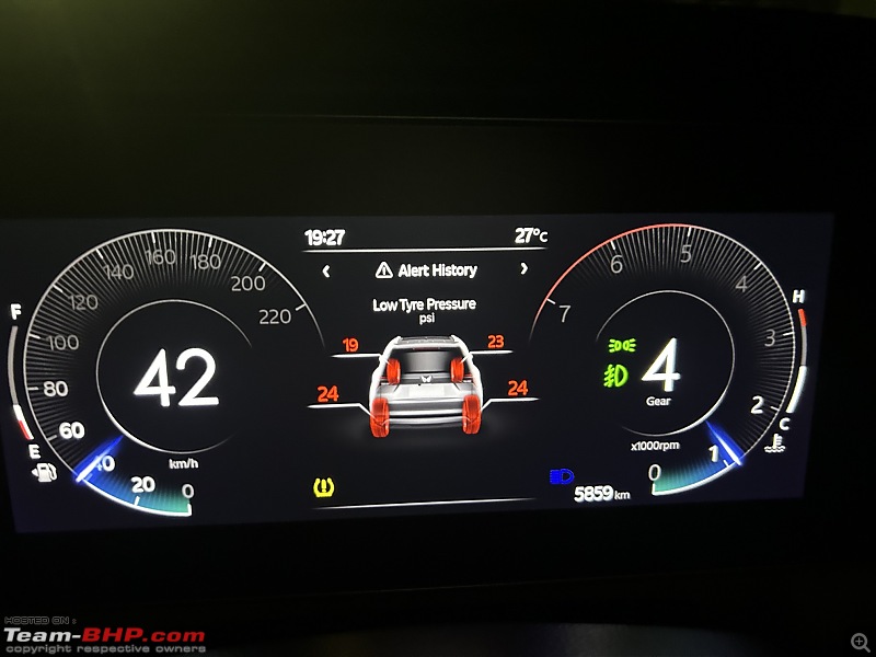

Hey RavevAvi - With the help of your thread, I was able to get my ASC to fit TPMS for my AX5. Thank you.
5 sensors - ~Rs.5k
labour - Rs.1k
Question : I do not see TPMS indication for spare wheel. is it expected? Do we see pressure/temp for spare wheel only when they are in use?
Please refer to the picture post TPMS update in post#150, though it was still incomplete at the time he posted.
You Have to enable Spare Tire from the CoTek laptop, force Manual TPMS learning through the diagnostic console on the OBD connected computer and only then will you be able to see it in the MID.
Congratulations.
As Sommos said, the 5th (spare) tyre TPMS needs to be enabled separately by the CoTek through the service laptop. There are 2 options - 4-wheel TPMS and 5-wheel TPMS. Only after the latter is activated and the manual learning process is completed, you will be able to see the 5th wheel's pressure and temperature on the speedo's MID.

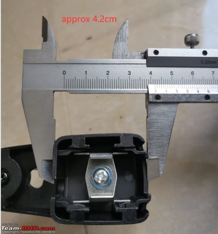

The next option I am looking into is to add an auto-dimming IRVM. Searching for compatible mounts for the same.
Do you think this mount will fit our cars?

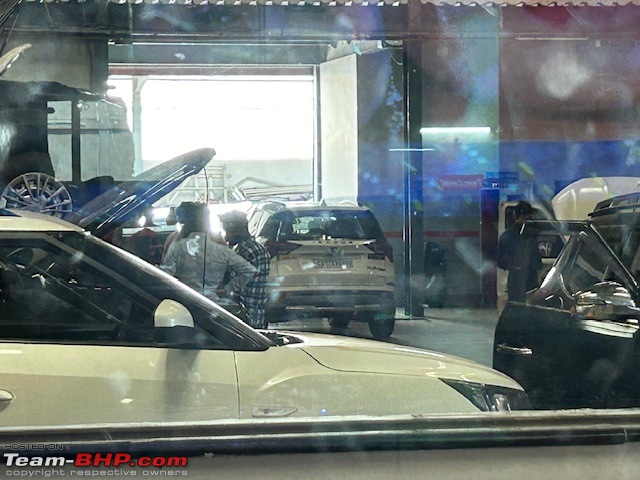

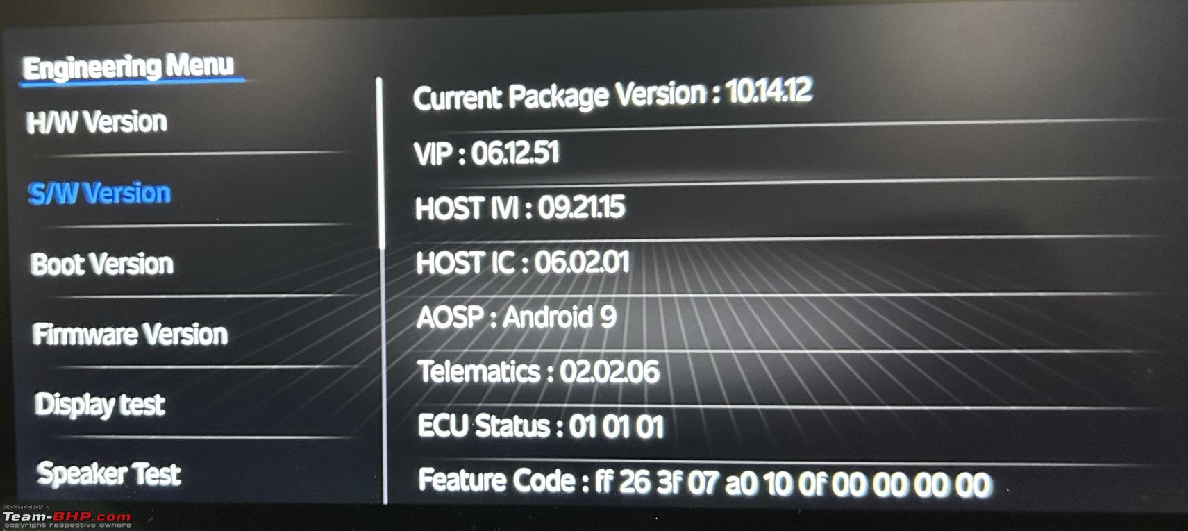

The CoTek came over and completed the AdrenoX update first. Downloading and updating took nearly 2 hours but the software update to the latest version (10.14.12) was completed and finally the "Apple CarPlay" widget started showing in the HU, instead of the "Coming Soon" widget.
Update in progress.
Finally!
Version number.
Curious techs checking out the update process.

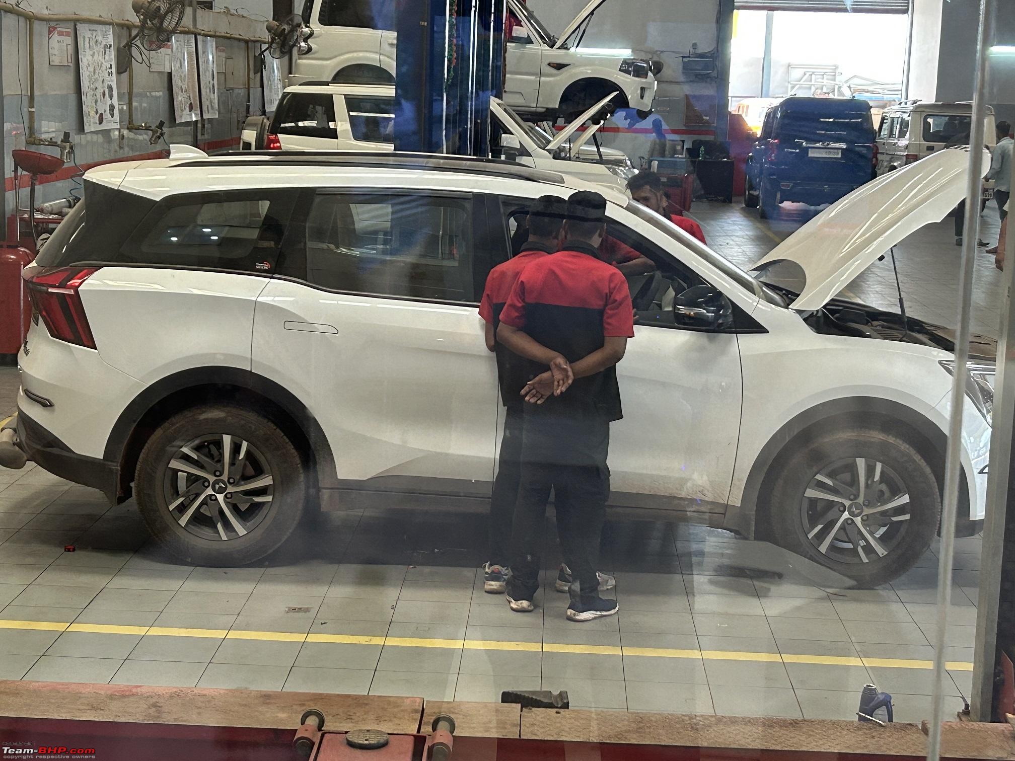

Mechanical checks were completed and fresh engine oil was poured into the engine system. Icarus was the first XUV7OO they were servicing so it took a few minutes for them to familiarise themselves with the engine oil inlet and the oil filter area. The air filter was still good to go for possibly another 5,000-6,000 kms so they cleaned it thoroughly and put it back, but the AC filter was completely gone and was beyond cleaning. Got it replaced. DEF was at 72% so skipped topping it up for now until it comes down to 50%-ish levels, as was advised by them.
Fresh blood into the circulation!

The VIN check showed an EMS (Engine Management System) update pending, so that was completed next. The suspension control arms & their related bushes were not in stock and were promptly ordered. By this time it was nearing 4 PM and I had a prior engagement at 5. Paid the bills and left by 4:30 PM, promising to return on Saturday to get the remaining jobs completed.
Headed back to the dealership on Saturday, 27th May, to get the rest of the jobs completed. Reached there at 11 AM.
The TPMS had stopped showing it's readings from the first week of January. The CoTek took Icarus for a 90-minute run outside the dealership but learning failed. Suspecting a busted tyre sensor or two, he requested me to return back another day so that they could do a thorough check of all 5 tyre sensors. It was a Saturday and they were short-staffed, plus there was an power outage that day till evening due to maintenance.
They then took Icarus up on the ramp and got the fuel filter drained. All fluid levels were good to go, as was the battery. Brakes had plenty of life left in them, and the tyre checks and underbody check sprung up no surprises. DPF was at 7% so no problems there as well - not surprising because Icarus had demanded a parked Regen 2 days prior to this, on the same day the first half of the servicing was done! Got all the wipers checked as well, and got both the front wipers changed. That was the only job which incurred charges that day.

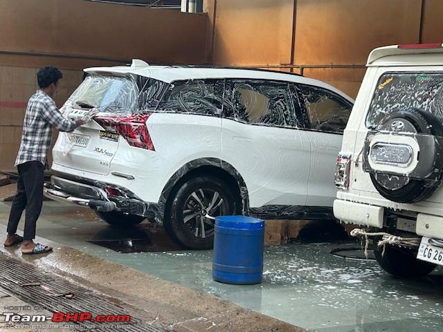

Then Icarus hit the showers. I pointed out plenty of soiled parts on the driver door panel and the inside of the A & B pillars, which were dealt with quite efficiently by the cleaning team. By the time I was ready to head home, Icarus was demanding attention and turning heads - sparkingly clean and refreshed!
Interior cleaning in progress.
After a long, nice shower.

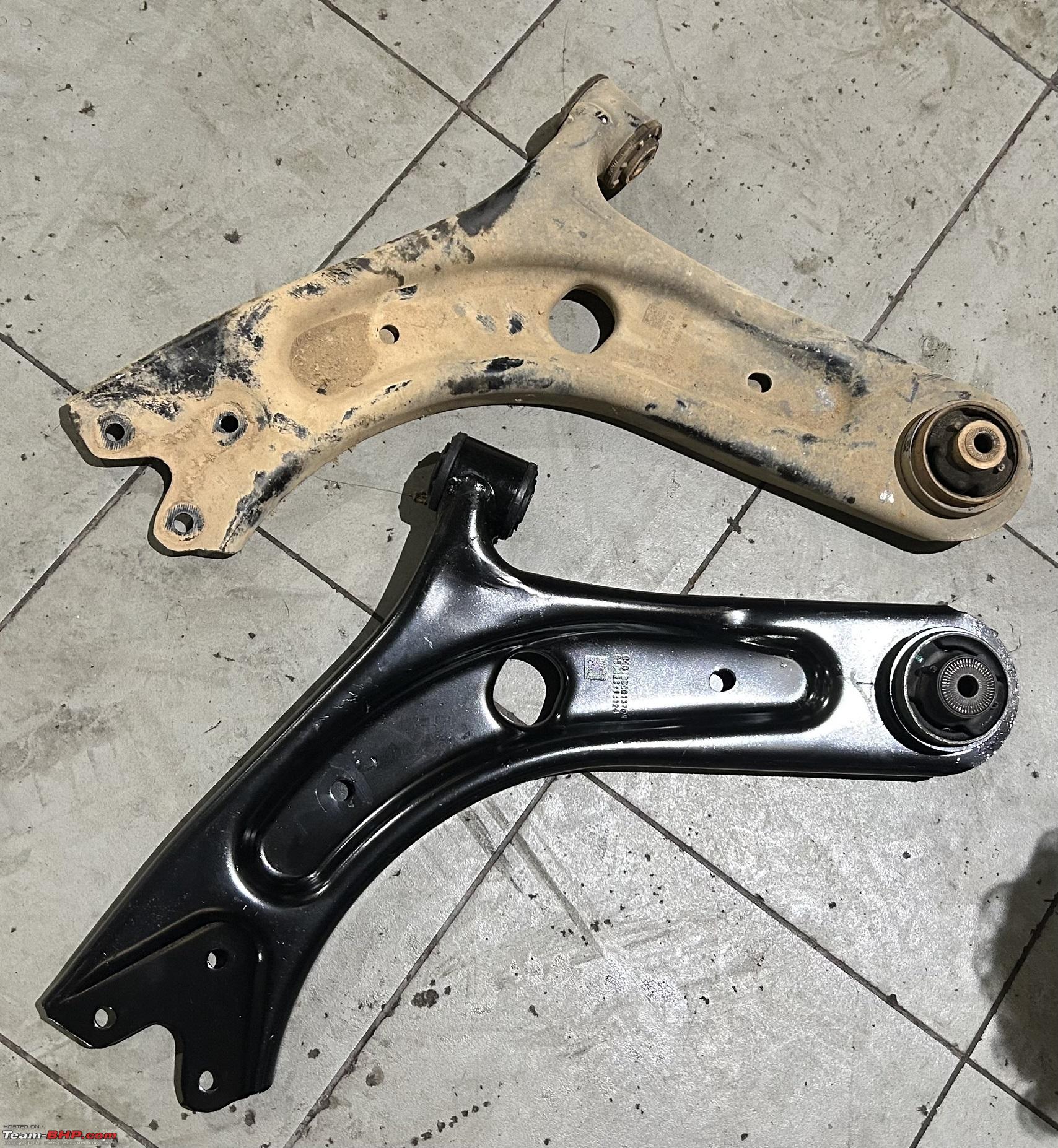

Front Lower Arms Replacement
Took Icarus to the Balaji ASC in the afternoon today to get the front suspension lower arms replaced. In addition, they had procured 2 TPMS sensors and the two tail lamp plastic watershed parts had also arrived. Estimated time was given as 2 and half hours and work started at 4 PM.
Icarus went up on the ramp and the front wheels were off. The only difference I could make out was that the newer lower arms had bigger bushings than the old ones. Rest looked the same, even the sizes were a match.
The lower arm placement.
Part numbers.
Old vs new. Notice the larger bushing in the new one on the extreme right.

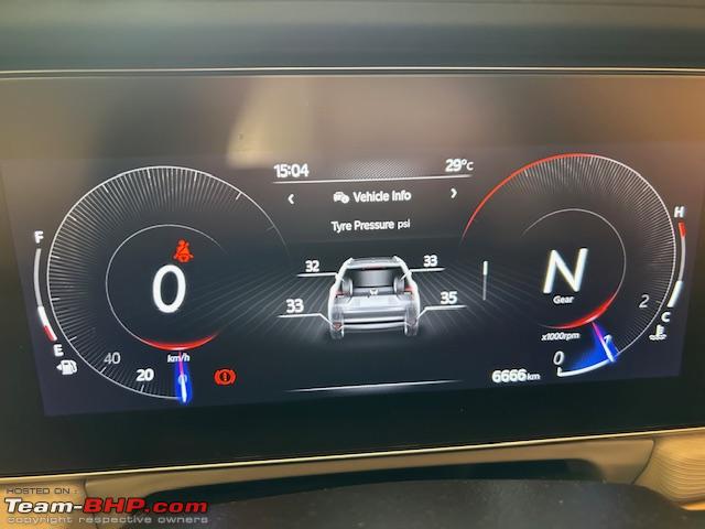

Then they took the wheels and checked the older tyre pressure sensors. Surprise, surprise - the front tyre pressure sensors were completely different from the ones which had been procured by Balaji ASC. A part number search showed that the older ones, fitted by Paramount's ASC at Jeypore, Odisha, belonged to the Bolero! The rear tyre pressure sensors were thankfully of the XUV700. The sensor in the spare (5th) tyre belongs to the Bolero.
Older one on the left belongs to the Bolero! The correct, newer one is on the right.
3 tyre pressure sensors of the Bolero were fitted to my XUV7OO. Only 2 were originals. No wonder the TPMS system never worked.
Previously.
They swapped the front ones with the two new sensors they had procured, changed the TPMS system from a 5-wheel reading to a 4-wheel reading, and then the learning of the TPMS was finally completed and the values started showing in both the tyre pressure and the temperature readouts. The spare (5th) tyre pressure sensor was left as is for now, as they placed an order for 1 more sensor for my XUV.
Now.
Finally.
Hello, TPMS!
