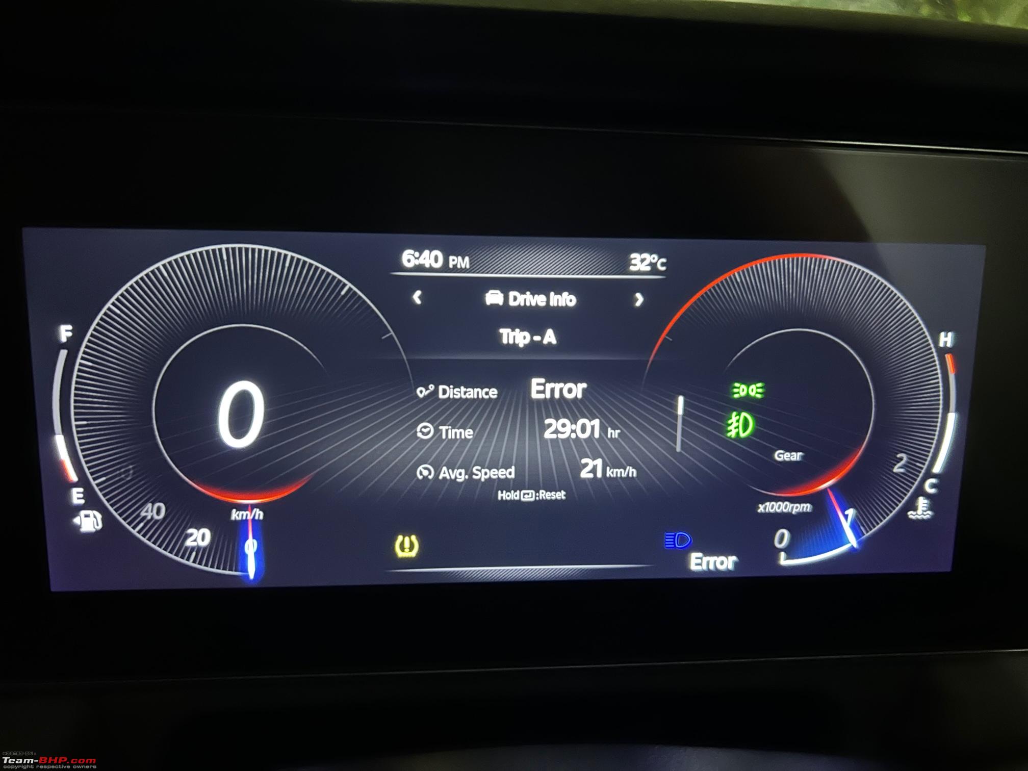

1) Resetting to the first song of the USB drive upon startup. Have done all sorts of experiments with drive sizes, capacities, numbering folders, putting all songs in a single folder, etc. No solution.
2) Blank screens which crop up by themselves then go away after a shutoff - pause - startup cycle.
3) Loud thuds from the speakers which indicate an impending glitch coming up - either MID resets, Error messages (like the ones below) popping up, HHC (Hill Hold Control) error alert appearing, etc. All of them go away after a shutoff - pause for a minute - startup cycle.
4) For those who think these are happening to those who have updated their AdrenoX's software, let me tell you that I am still on the stock 7.XX version.
5) Complete a very short trip (of 1-2 kms) and upon the subsequent startup, the bootup of the AdrenoX system is really slow. Takes a lot of time to show all the screens properly.
6) Intermittently, the Drive Modes don't work - neither by pressing the Drive Mode physical button (below the AC controls) or selecting it from the pull-up menu in the HU. A popping sound indicates that the haptic touch was registered, but nothing happens. Then there is no option other than to drive in the default Zap mode.
Mechanically, the XUV is a gem. IMO it would have provided a much better ownership experience with lesser electronics driving it's systems.
(remember KISS! - Keep It Simple, Stupid!)
In addition, I have noticed a new quirk in the past 10-odd days - whenever I crank Icarus up for the first time in the mornings, there's a distinct knocking sound coming into the cabin. It goes away within a few seconds as soon as the mHawk smoothens into it's idling rhythm. Adulterated diesel causing this, or improper injecting pressure or something else? Something to investigate during the next service center visit, which will most probably be by next weekend.

Attachment 2427476
Attachment 2427477
ODO is closing in on 4,400 kms.
These symptoms sound like a memory (ram) issue for the car's computer. Basically there is a faulty bit of memory and whenever it tries to read or write data from it, it freezes or glitches out. After a restart it goes back to normal for a while because everything in the ram is cleared and it continues to be normal until it tries to read/write from that bit again.
These issues are going to crop up with cars basically being computers these days. There is no way to actually repair or replace the ram itself since these are System-on-Chip (SOC) designs where all components are part of a single chip. Convince the service center to replace the entire board. Each company uses a different name for it like silverboard, logicboard etc but the underlying thing is the same.
