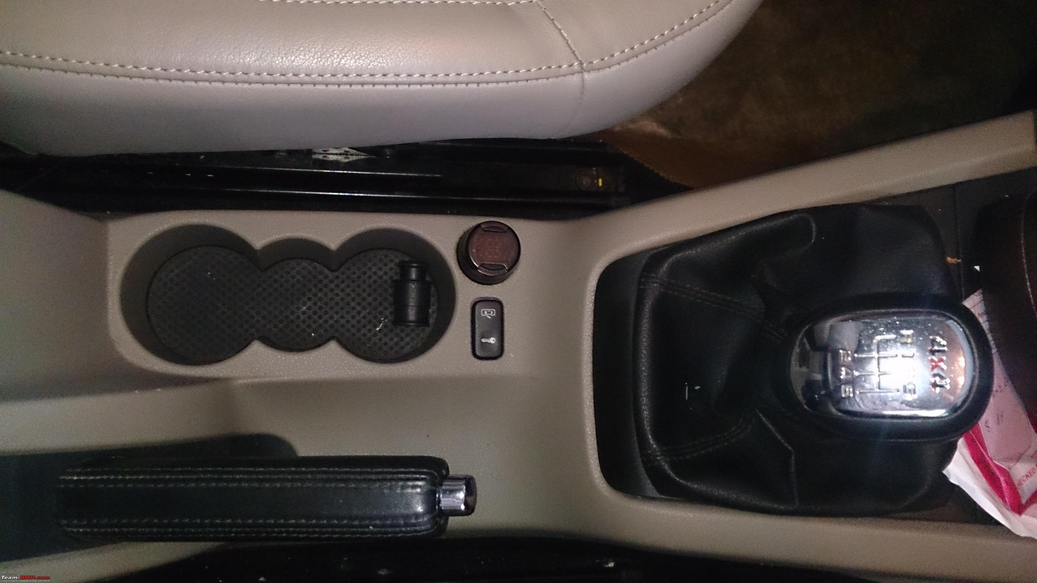

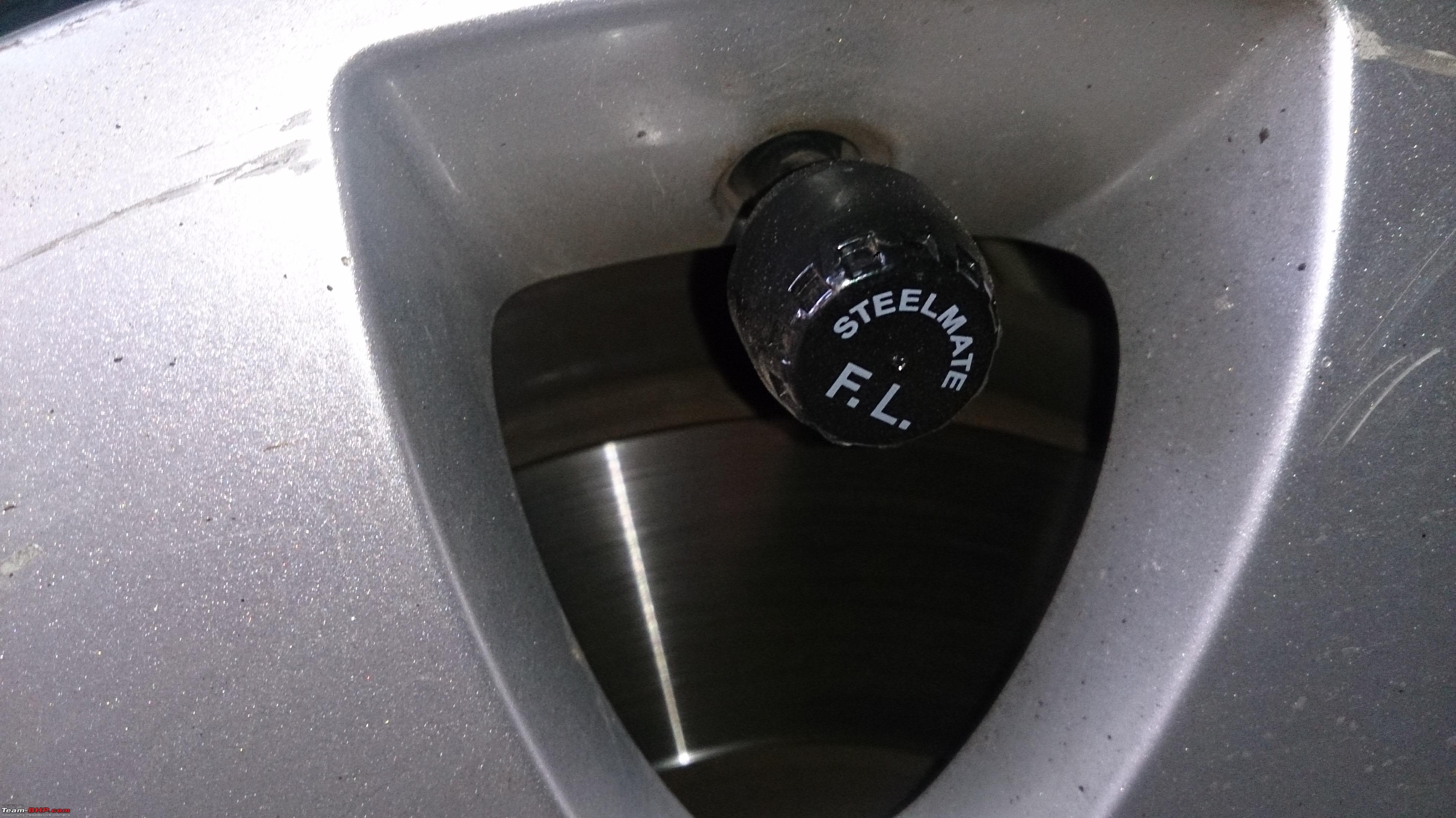

The Steelmates Tyremates DIY TP-70 TPMS - installed on the Yeti
The Tyremates TP-70 cost me Rs 9,675 COD.
I have attached two photos - one of the sensor and the other of the display unit. I really like the non-intrusive nature of the product.
As you would notice that the sensor fits neatly replacing the valve cap. Similarly the display fits snugly in the 12V socket in place of its cover, without creating any distraction or drawing undue attention.
Personally I feel that it's a pretty clever design which is unobtrusive and functional. It sits quietly monitoring the pressure and temperature. It provides real time information about the tyre pressure if needed, and warn through alarms the low/high tyre pressure and high tyre temperature condition - all precursors of potential trouble.
One System, Multiple Cars
Further, for those of us who have more than one car, and where generally only one car is on a long highway drive, where a tyre burst would be catastrophic. In that case transferring the TP-70 from one car to another is a breeze. It's just a matter of unscrewing the sensors from one car onto the car, and shoving the display unit into 12V socket of the other. It's a five minute job. Other TPMS systems cannot be easily translocated between the cars.
Experience with the vendor
My experience with Roger Motors, who sell the product in India, has been positive. They just didn't sell the product, but also called after I took the delivery, to check whether I needed any help with installation and if it was performing as expected. In fact the person who called also reminded me that I could use the product for 21 days and if I was not happy with the performance I could return it for a full refund - no questions asked. This sort of guarantee would generally be dished out in pre-sales talks, but this was after I had accepted the delivery, parted with money and installed the product. These are good signs should the product develop problems in future.
I would suggest, go ahead and buy one for your Innova. It does provide an additional layer of safety.

Old 19th October 2014, 01:10   #263
dean5545's Avatar
Join Date: Sep 2013
Location: mumbai
Posts: 823
Thanked: 1,590 Times
The Abominable (Skoda) Yeti *UPDATE* 20,000Kms Update on Pg.14
Thanks Alot for your detailed description will go for it in a while as my rear left tyre constantly keeps losing air.
