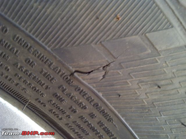

And then a couple of days back I noticed cuts and splits on the sidewall of the rear left tire. Here are the photographs.
The splits have occurred in two places (diametrically opposite) on the same tire. I raised the issue with Skoda, who through their dealer have scheduled for the tire inspection by Goodyear for tomorrow. This would be the first issue with the Yeti.
Now my questions are:
1. The tyre needs to be definitely replaced immediately. While the other tires appear normal. Is it a good idea to replace only one tire?
2. If I need to replace the entire set, then I'd rather put A/T tires. I enquired with a few dealers. They have 215-65-R16 for A/T tires and not 215-60-R16. I understand the difference in out dia with A/T tires would be about 3.25%. What would be the impact of such change?
3. On the other hand I'd welcome advice on any 215-60-R16 tyre that is better than Goodyear Excellence?
4. Finally should I just stay with Goodyear Excellence.

Did you scrape your tyre on a curbing by any chance? Tubeless tyres are very sensitive to scrapes on sidewalls. Goodyear or any tyre manufacturer for that matter are generally very reluctant to accept any manufacturing defect esp after 16000 kms of running. I had a similar experience with them when they refused to accept their fault, when their tyres developed uneven wear on alternate ribs after just 5000 kms of running. They blamed my car for faulty suspension! My earlier Bridgestones had run 40,000kms on the same suspension btw. And the next set of Bridgestone also lasted 40,000 following the Goodyears on the same car.
Since you have a cut on just one tyre, you could just replace that one with the same size and same make. More than 3% difference in dia from the OE size is not advisable as it will affect your ODO readings, gearing etc... Also you would be rubbing your car manufacturer on the wrong side as far as suspension warranty is concerned.

Even in my Yeti, I have noticed sidewalls damage in the Goodyear tyres.. Though it is not as bad as yours, the tyres certainly seem to have very weak sidewalls. My front right tyre had developed a cut around 3 cm long, but without air leakage. I repaired the tyre with some Feviquick, but I am now terribly conscious about the tyres and am also actively looking at changing them with good AT tyres. I am also able to find the 215/65 R16 size everywhere. I sent a mail to Skoda on whether this size will be ok, but so far haven't got any response. I feel that we need to push Skoda to offer AT tyres in the correct size directly.
