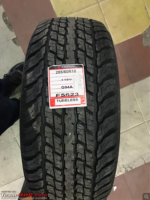

Yes, error at my part. I have same on my Endeavour, though I would have preferred 285x65x18 which unfortunately were not available anywhere.
265/50 R20 is the one to pick as TRD Sportivo Fortuner has the same size in 20"
Are you recommending going for size 20"? Apart from aesthetic reasons, I can't think of anything useful by going to such large dia.
But if Varshi finally goes ahead, my suggestion will be not to return his original tyres & alloys. He will need these back sooner than expected from my experience.
Toyota Fortuner : Tyre & wheel upgrade thread-1-pm.jpeg
Turbanator is online now   (1) Thanks
