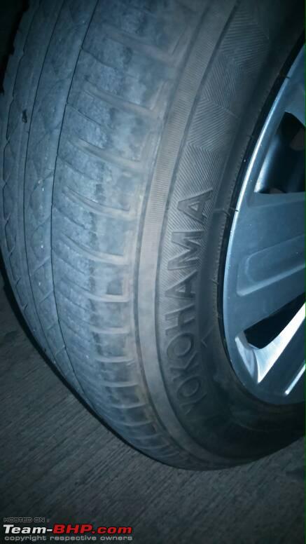

Now i am confused, whether the excessive tyre noise is because of,
1. Retread tyre sold to me as new
2. Yokohama tyres are noisy
3. Tyre rubber became harder because of less usage (Most of the days car is parked on tar road in front of my house)
Yoko A-drives are not noisy, and they should not harden like that. I have used A-drives on my Ikon for 4+ years. Even after 43k, I had more than half of tread left.

Originally Posted by sbalagru6 View Post
I have purchased a pre-owned (~78K mileage) ford ikon 1.6 in March 2012. It came with almost new Yokohama A-drive tyres (175/65/R14)...
Now the odo is ~85K, i.e I have done ~8K in past 2 years...
Almost from the day one after the purchase, noise inside the car was like riding on a road roller ... Initally i didn't suspected tyres, since they were new...
I have Yoko A Drives on my Ikon Flair and it has reduced the tyre noise I had experienced when I had MRFs on the car. So, I don't think it's the tyres in general.

Originally Posted by Nikhilb2008 View Post
Can you post pictures of your tyre's sidewall? Take multiple pictures in such a way every inch of the sidewall is photographed. Post it here.
Also, it is possible that the manufacturing date is printed on the inside of the tyre (the part facing the suspension/brake discs).
Sorry for the late reply, since i was out of station over the weekend...
Last week i have done tyre rotation, so 2 of the tyres which were facing inside are now facing outside... But no manufacturing date details...
Will take some pictures and upload it here as soon as possible...

Here are the pics...
sbalagru6 is offline

The noise from tyres are unbearable...
Please see posted photos of the tyres and confirm, whether they are original
The noise from tyres are unbearable. Please see posted photos of the tyres and confirm, whether they are original
I've been using the A-Drives for two years now and I can vouch for the fact that they are very silent. It seems you have gotten a defective set but its difficult to tell from the photos if they are genuine or not. Where did you buy them from?
Thanks for the revert gpa.... Tyres came with car when I purchased it from used car showroom-Classic Automotives...
You can use the serial number stamped on the tyre to determine the year and month when it was manufactured. If the tyres are really old then they can harden learning to noise.
I am not able to find the serial number... you can go through my posts on this thread to get a clear picture.... that's the reason i have posted the pics of the tyres...
The serial number on your tyres is FLP 0411which makes it a February 2011 tyre. But this is a grey market tyre, all yokohama tyres officially being imported into India have been stamped with YYY as the preceding letters (instead of FLP in your case) YYY denotes tyres designed for Indian conditions and also having BIS approval. You're lucky to have just noise as an issue, someone I know bought a set of 2 and is grappling with 'left pulling' since fitment. And Yokohama India Ltd did not entertain his complain for lack of invoice & warranty card.
Try to find a 4 digit number on the tyre which will tell you the week and year of manufacture.
For example: 1411 will be the number printed on tyres, which is decoded as 14th week of 2011. The first 2 numbers represent the week and last 2 numbers represent year of manufacture.
