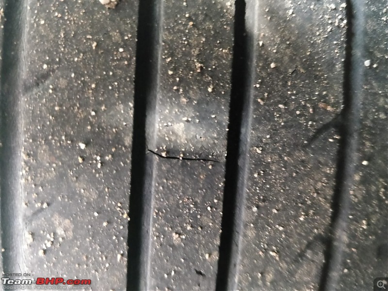

Witnessed this cut after a long 750 km drive yesterday. I have a return trip planned in 2 days. What do you guys recommend? Do you think it's superficial or deep? I am not keen on a tube inside etc. Continue to use, discard or use as Stepney?

Originally Posted by bharatbits View Post
My bad. I was travelling, the picture i clicked could not be uploaded along with the post as it's size was larger and i could not reduce its size as i was on mobile. Here it is.
The crack seems to be deep, not superficial. And it is connecting the two grooves. Such crack can cause sudden loss of pressure and tyre blow out even without any foreign object like nail. Also, such wide crack can't be repaired.
Discard the tyre. Anyway, it seems to be worn out past the tread wear indicator. There is hardly any groove depth left.
Here it is.
+1 to what Rahul Bhalgat said.
Also, tread wear does not appear to be uniform. See if there's a problem with the alignment, else your new tyre will also wear out faster from one side.

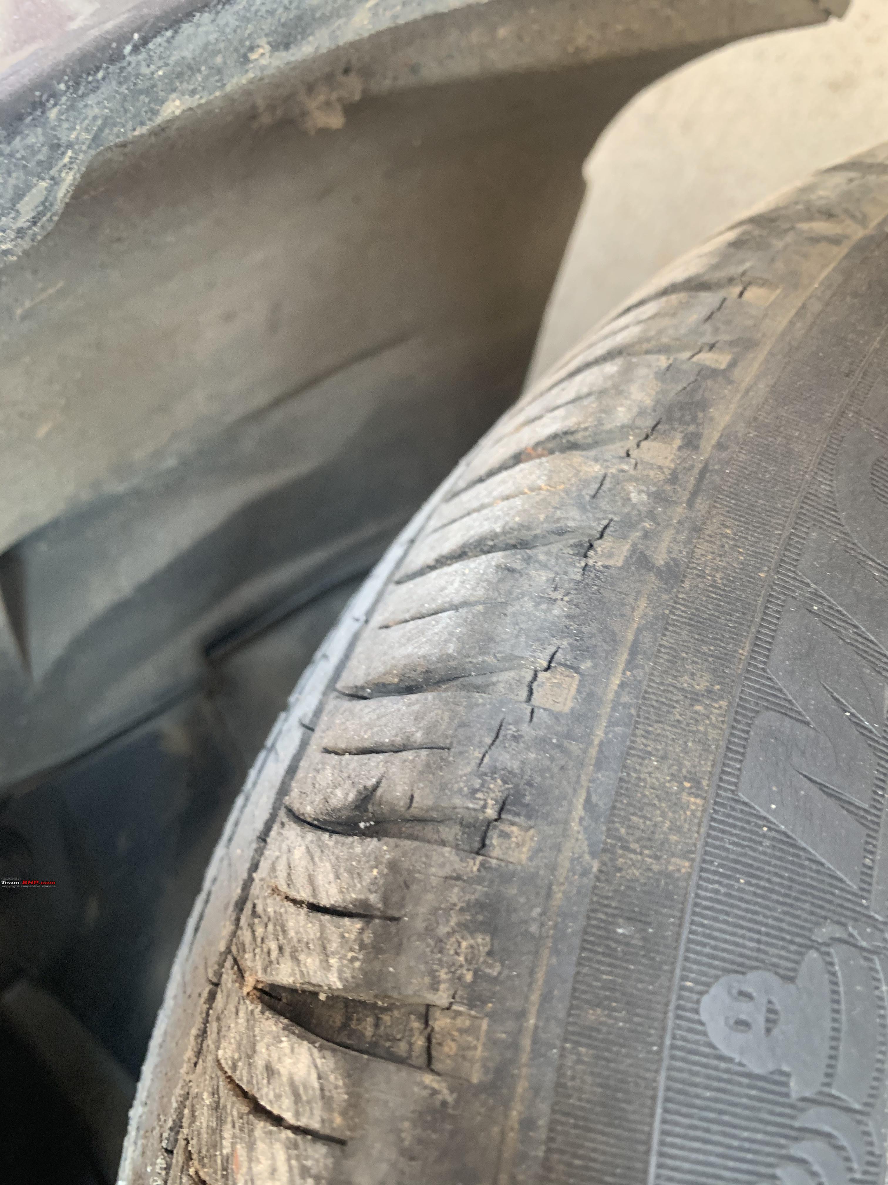

My Apollo Alnac 4G tyres (195 R16) have developed cracks at the sides (shoulders ?). All 4 have those cracks visible. Road noise has increased significantly over the last few months. The car (Baleno petrol Zeta) has run 26 K KM since May 2017 (purchased date). The wheels are rotated, balanced and aligned during the service intervals at Nexa.
What could be the reason. Here are the pics with the cracks outlined :

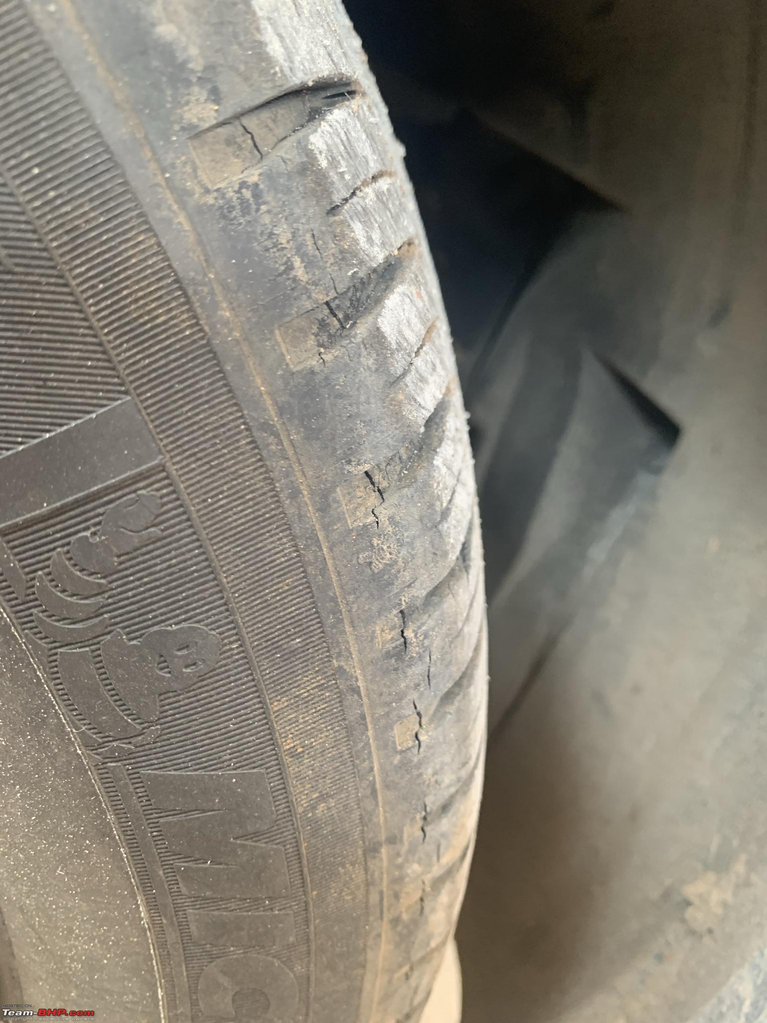

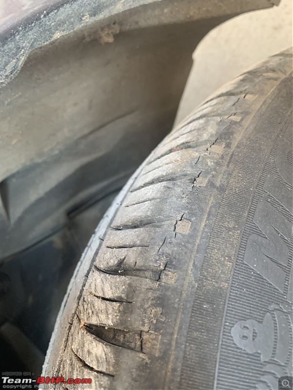

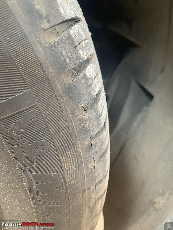

Are these dry rot cracks in my tyre? And should I replace it immediately? This is driver side front tyre and other tyres appear to be not having such cracks.
Yes please replace the set more so if you do highway runs. I just replaced my Michelins. All 4 had cracks. Guideline for replacements:
a) Age - a max of 10 years after production date
b) Wear - tread wear indicator visible
c) Physical damage - This includes cuts and large punctures to the sidewall, damage to the tread or carcass for e.g. if the steel belts are visible. Never attempt to get these repaired
R2D2 is offline   (1) Thanks
Replacement is necessary.
How old are they? If its within warranty, please contact them and get a prorata replacement.
