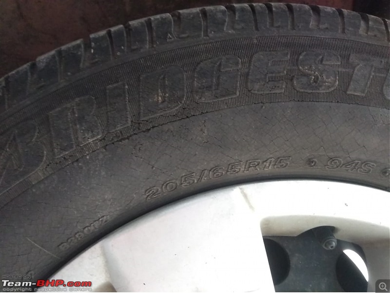

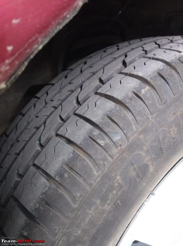

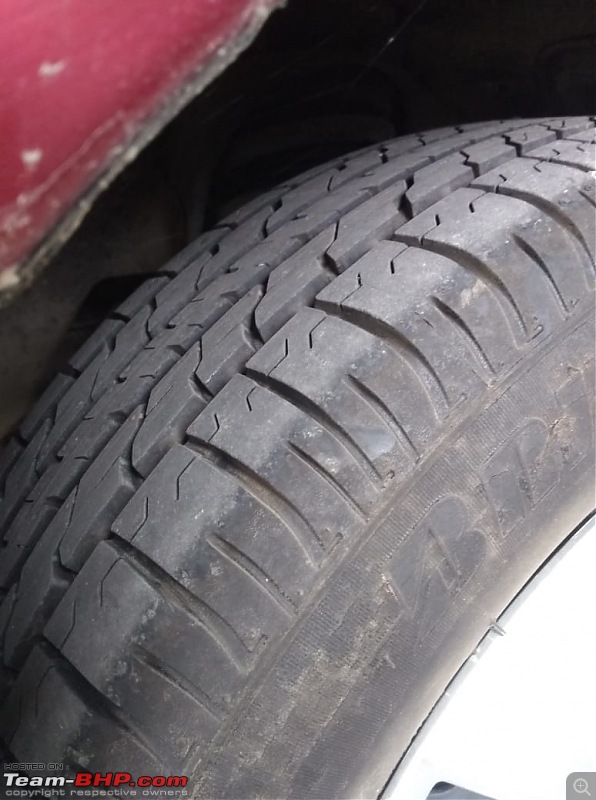

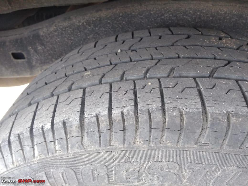

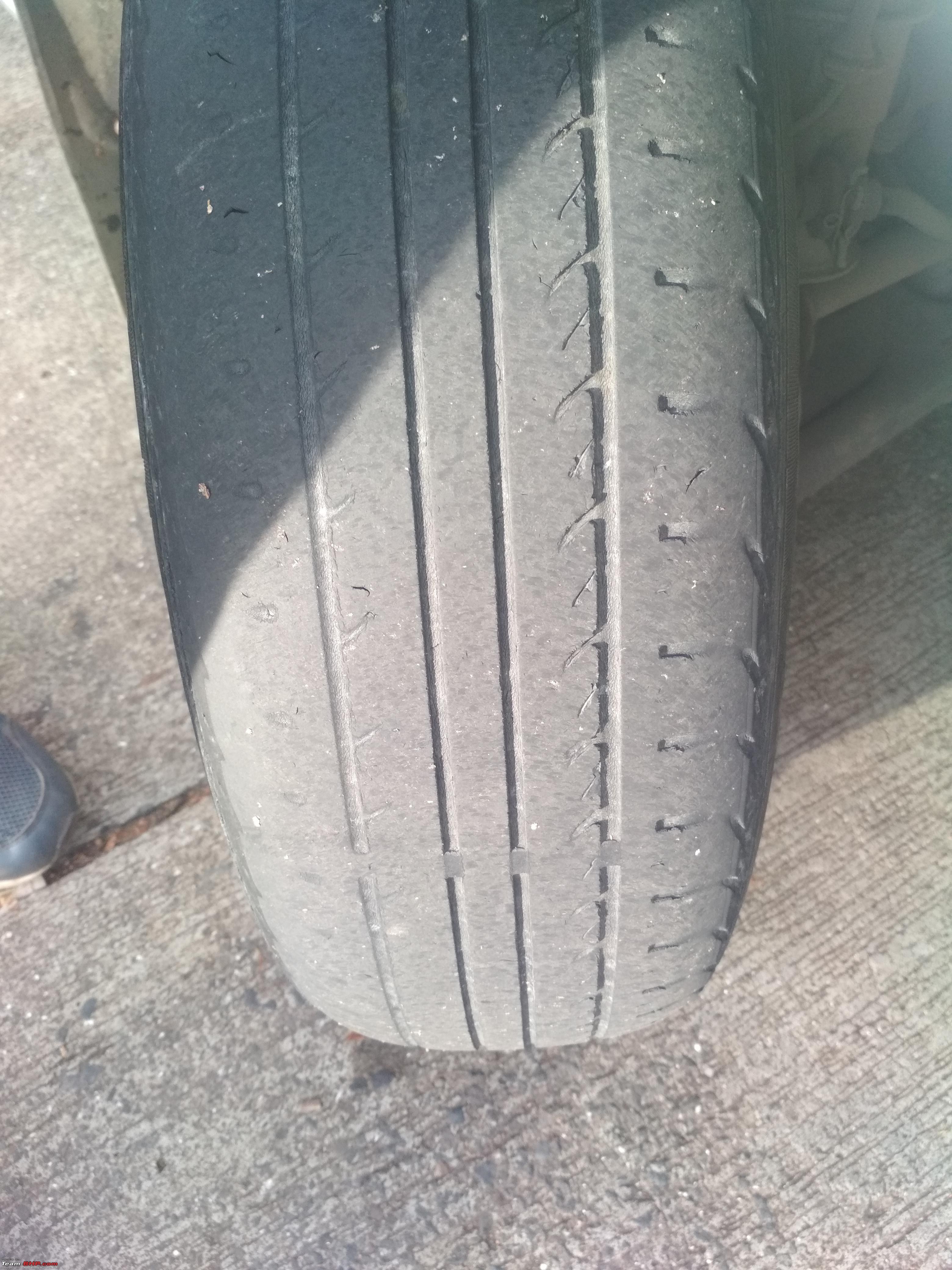

Hi Members,
We have a 2010 Innova 2.5 G driven just for 16k kms (mostly highway runs) till now and is still on the tires came from factory (205/65R15 Bridgestone B390 on steel wheels).
Now, the general practice says that we should have already changed the tires some 5 years back and its already too late, but now given the amount of driving, in the midst of pandemic, we doubt any highway drives, and it might be limited to very short city drives, so does it make sense to move to new tires?
If yes, what would be the options both in VFM and the best tires available for the Innova 15 inchers? My preference is a very comfortable and silent ride. Sharing some close up of the tires taken recently.

Please change the tyres immediately. The condition doesn’t look good based on the pictures.Irrespective of how they look, 10 years is too long a time.
I would suggest Michelin XM2 or XM2+ as both are available in your case. Mrf, Continental and Apollo all have competent tyres now. Comfort, silent ride and durability is good in all these brands.
However Michelin although slightly pricier, provides better overall experience in my opinion.
I have seen some knowledgeable tyre stores suggest running on Michelin’s for more than 5 years provided the usage is low, in city driving conditions as long as the tyre health is fine. Same guys don’t seem so confident with other brands for extended usage.
Please do not drive the vehicle further without replacing the tyres. The tyres are really in a bad shape.
With an experience of working in tyre industry for 7 years (in Manufacturing), I would urge you to replace it NOW.
Tyres are one of the most important factors in safety aspect. Do not compromise on safety. As a thumb rule 5 years / 50K KMs is the tyre replacement threshold. In practical scenario, this varies based on many other factors.
Please change those tyres right away, I have changed 3 year old tyres that developed cracks near the tread and sidewall just like your tyres It's not worth the risk as the life of the driver and any passengers depends on those tyres. Also, tyres should be changed after 7 years regardless of the mileage, this is advice from Michelin. Speaking of which my car is also due for new tyres since the last change was in 2013.
I'd suggest Michelin XM2 and Primacy 4ST, Bridgestone Turanza and Continental CPC. There are others too. If in Bangalore go to Madhus which is owned by DBHPian Nikhilb2008. As a pro in this field he'll be able to guide you well.
Tyre in the second last picture looks fine, rest of them are toast.
I agree with others that these are not fit for the highways. But with such low usage + low probability of highway drives in this pandemic situation, I don't see the need for immediate replacement unless this is a daily-driven car.
Just as an example there's no harm in using the car in this condition for running errands or grocery shopping. For anything more important, you may go ahead with replacement depending on your risk appetite. Let us know what you decide.
