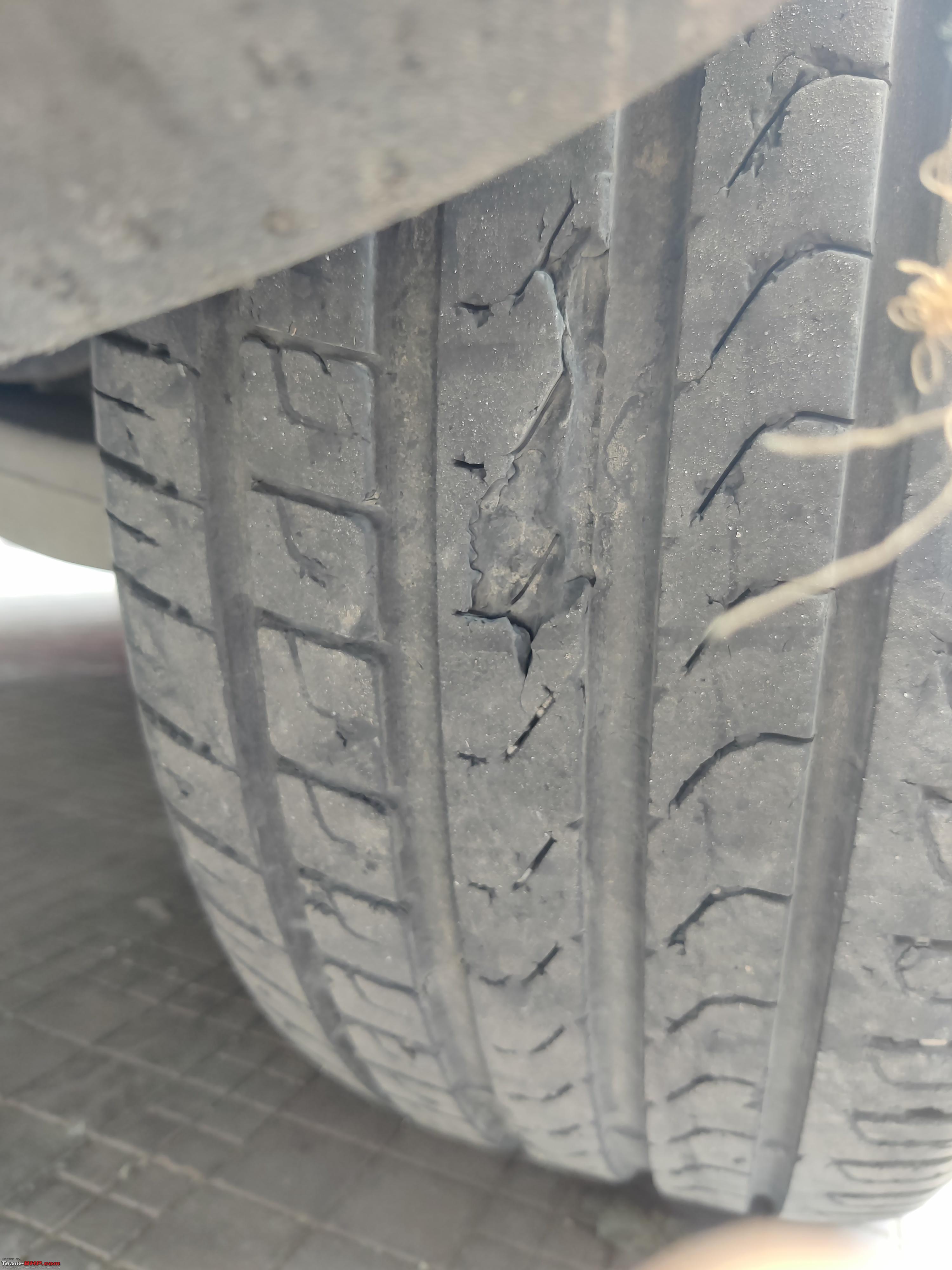

Re: When is the right time to change tyres?
Had a bad jolt a few days ago due to a pothole not visible due to rains and maybe that is the culprit for causing this. I was shocked to see this big a piece of rubber missing from the tyre. Considering the tyres are mid 2017 and run about 45k, this calls for a change of all 4, specially since I have upcoming highway trips
Sumer is offline   (1) Thanks

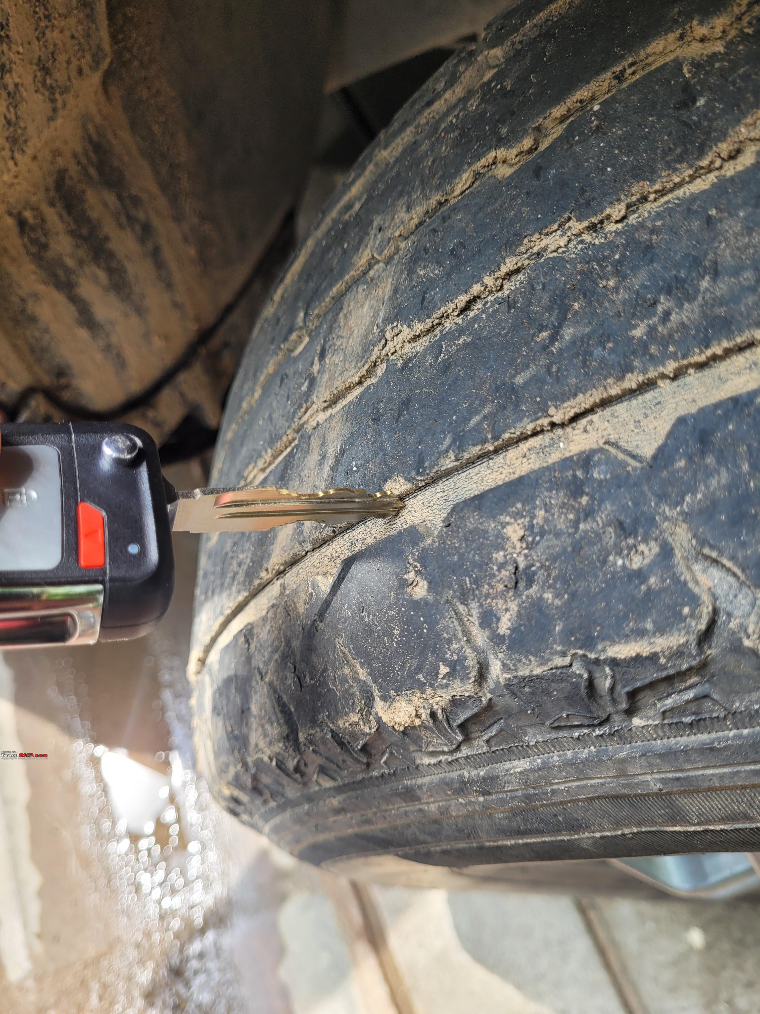

My tyres are almost 5 years old on my TUV300. Planning a road trip of about 800km starting this Saturday. I suppose makes sense to change them? I see depth between 3-4mm of tread.
I wanted a soft tyre and would like suggestion if I should pick Yokohama or Continental. My spare is a Michelin but they have stopped producing 215/75 R15. Please recommend if Conti is the right option or if there are other better options. Tyresnmore shows options of Goodyear as well.

[quote=Sumer;5367698 I was shocked to see this big a piece of rubber missing from the tyre. Considering the tyres are mid 2017 and run about 45k, this calls for a change of all 4, specially since I have upcoming highway trips[/QUOTE]
Yes absolutely 100%. The best thing you can do for yourself in this case is to change all the 5 tyres immediately to nice new ones. In any case they are all more than 5 years old. It’s definitely the right time to switch to new ones. Your car and your passengers will bless you abundantly.
Going by the pictures you have posted, I would most certainly immediately change all the tyres in this vehicle. 4-5 years is the maximum you should use tyres, in our conditions. Ideally I would change all 5 tyres and from now on, rotate them, balance them and align them every 5000 kms. Both Yokohama and Continental tyres are made in India nowadays. As per my estimation, you would be fine with either brand, even though there is a lot more written about Yokohama since they have simply been around in India for longer.

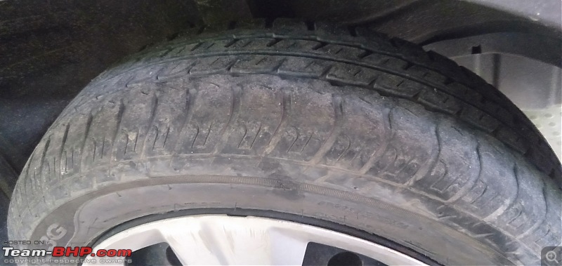

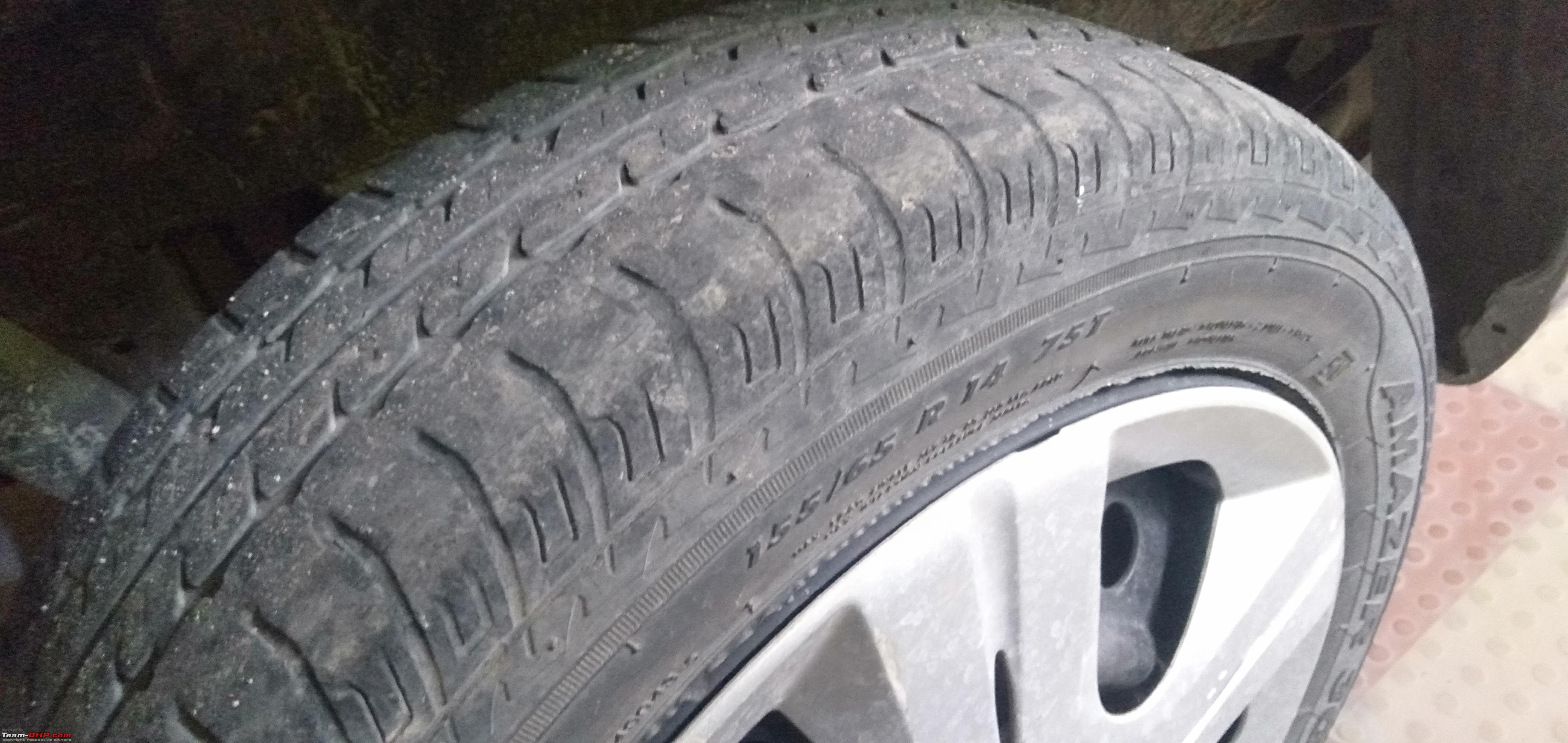

Dear Tyre gurus
Following are the pics of my stock 2014 Wagon R tyres (Apollo Amazer 155/65 R14).
My car is seldom used post 2019 due to lockdowns and now since my employer has granted permanent Work From Home, the usual home-to-office daily routine no longer exists. It only does an occasional within-city trips.
However, I am planning for a 700 km trip (roundtrip, God-willing) and I feel its time to change the tyres. But I have been getting conflicting opinions-
1. The tyre guy near our house (good reviews) says the front tyres can be retained and moved to back and fit new ones on the front
2. An old driver in our building says these tyres could easily be used for another 2-3k kms before swapping. However I am disinclined to accept his opinion as he showed the tyres of his car (Qualis) and they were almost bald.
I would rather go for one of these 2 options-
1. Either swap everything as they've done about 39k kms and have completed 8 years now
OR
2. Take the opinion of the tyre-wala who suggested changing only 2 of them.
Kindly advise.
