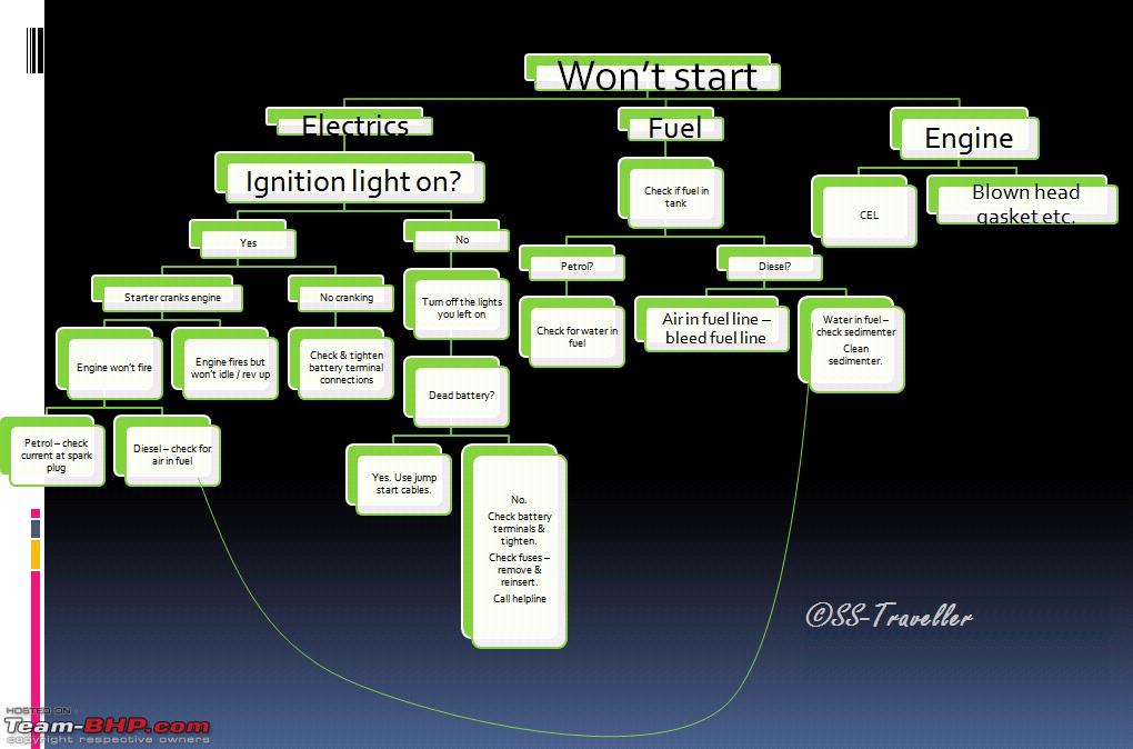

Step 1: Understanding the Basics
Before you begin the process of troubleshooting, it is absolutely essential that you ensure your own as well as others' safety by pushing the dead car safely to the side of the road.
There are essentially 3 systems that start your engine up:
In the next few posts, we shall progressively try to identify what is preventing your engine from running, and explain some quick repair methods. The ultimate solution for the mechanically-challenged individual is to call the manufacturer's helpline and / or have the car towed to a workshop. But before you do that (it can take an hour or more for roadside assistance to turn up), let's try to get you home safe.
Step 2: Checking the Electrical System
About Push Starts:
A push start may or may not work with the problems listed below. Do note that a push start won't get you anywhere if your battery is completely flat and the fuel delivery system gets no power. As an example, check this thread out. Also, not all cars can be push started; check your owner's manual for details.
The commonest culprit at the root of preventing your engine from starting up, or that caused it to die suddenly, is the electrical system. Turn on the ignition switch, but don't crank the starter. Are all the telltale lights on the dashboard coming on & fully illuminated?
If YES (all dashboard lights are on):
Determine if the battery has enough charge to be able to start the car. A quick way to check is to turn on the headlights and blow the horn. If the lights dim and the horn sounds hoarse, you have a nearly flat battery. It's push-starting or jump start cables to the rescue!
If there are absolutely NO telltale lights on the dashboard:
Be prepared that the fuse might blow again, in which case there is a short circuit somewhere and you need to summon professional help.
If the starter motor is turning over, but is slower than normal:
If there is no noise from the starter at all:
If you hear an audible "click", but the motor doesn't turn over:
If the starter motor churns over normally, but the engine will not fire:
The engine starts, but refuses to rev up or dies out after a few seconds:
WARNING: Do not continue to run down the battery by repeatedly cranking the starter motor, if the engine turns over well but will not start. You don't want a dead battery over and above other issues.
