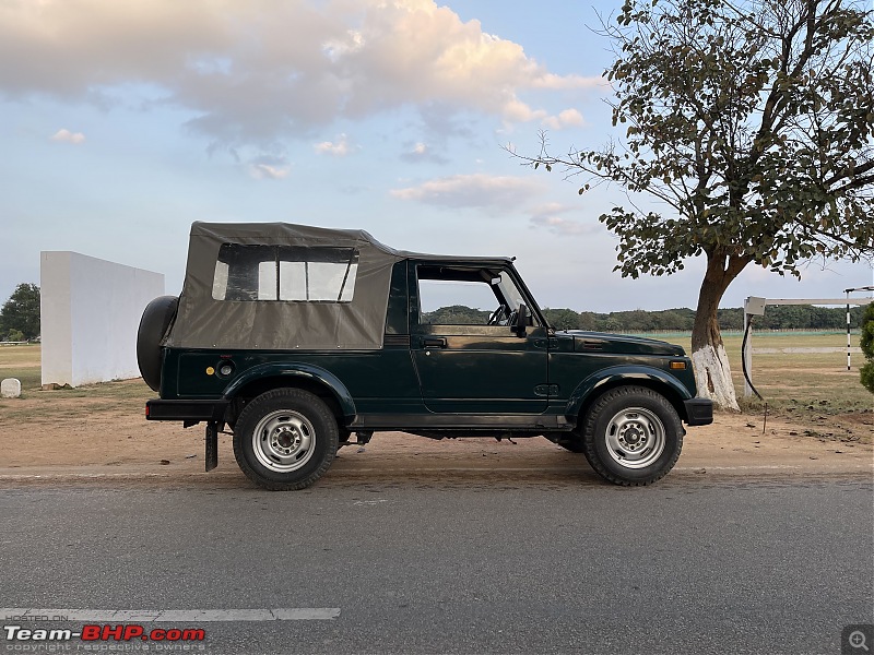

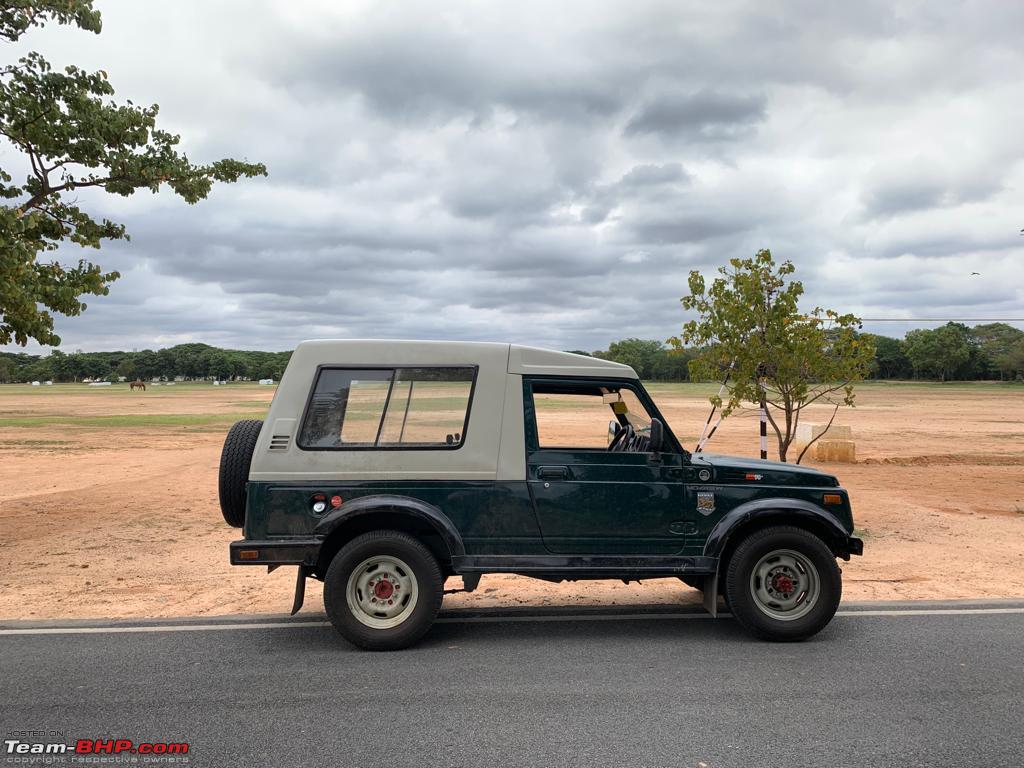

The stock Gypsy comes with F78-15 Nylon Cross Ply tyres as Standard from the Factory. These can be Ceat HT75 or MRF Estate. My Gypsy had Estates and since they were old I bought and installed a fresh set of these.The recommended radial tyres for Gypsy are 205/70/15.The most acceptable upsize is 215/75/15. Anything more is absolute overkill.
I speak with conviction because I have had 5 different Gypsys over the last 25 years and still own one.
Pictured below you can see my present green soft top Gypsy with stock F78-15 MRF Estate Cross Ply Nylon Tyres. And my earlier Gypsy with Goodyear Wrangler 215/75/15’s.

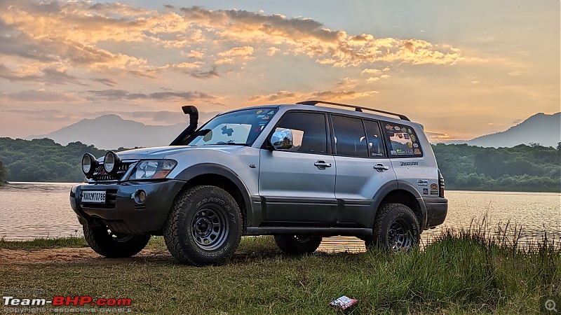

So I changed my wheels on my Montero to Off-Road wheels. The damn thing is heavy and imbalanced on high speeds. Still just because how good it looks, I'm keeping it.
dhanushs is offline   (5) Thanks
