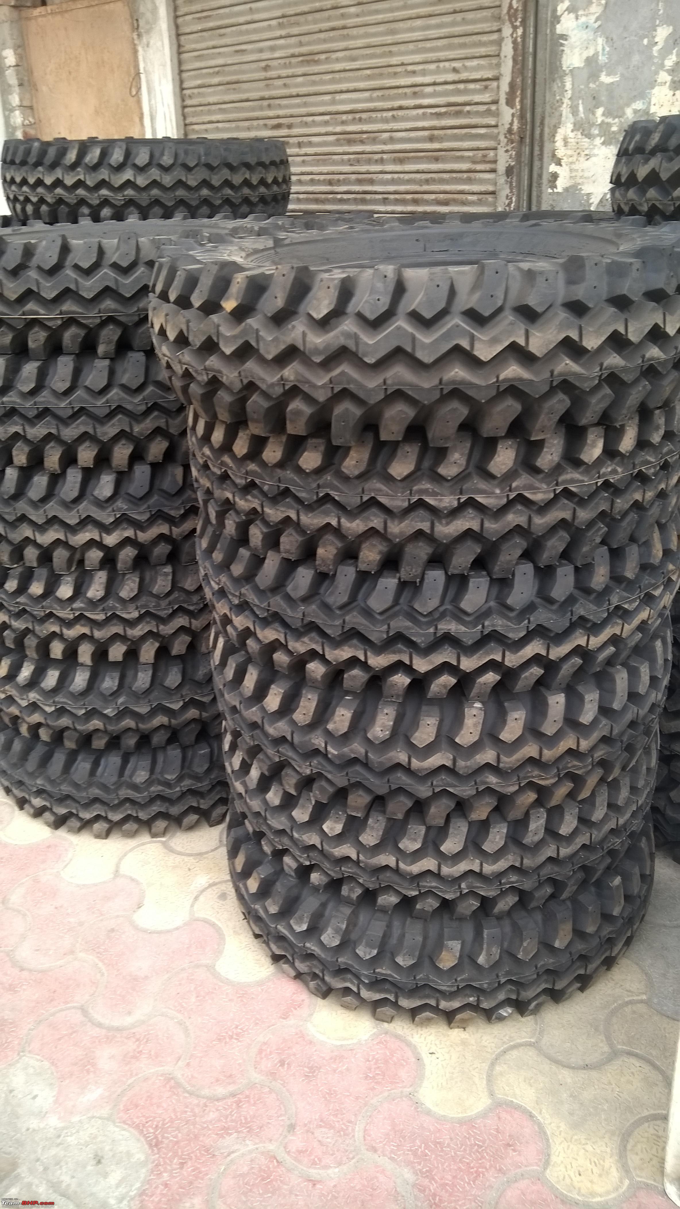

Just found these at Bara Hindu Rao in Delhi (under the flyover not far from Pul Bangash metro station):
They are supposedly 6-plys and if so wouldn't ride too awfully rough; around 32" diameter and really aggressive as you can see which should be able to really pull through mud better than just about anything other than NDMS / Maxxis Trepador/Buckshot (at much higher price).
No warranty, shop owner was unwilling to really promote them very strenuously, says it's a new product and not much experience with it.
Having "Buckshot" and "F78-16" (old American sizing, very inaccurate in this case) molded in small print on the sidewall, it's obvious these are pure desi, but at Rs3750/piece it might seem worth a try for someone doing more pure offroad and not really needing anything highway-worthy.
For anyone interested, Harjinder Singh (Lucky) @(011)23671223, 9212004848; or citytyre.traders@gmail.com
