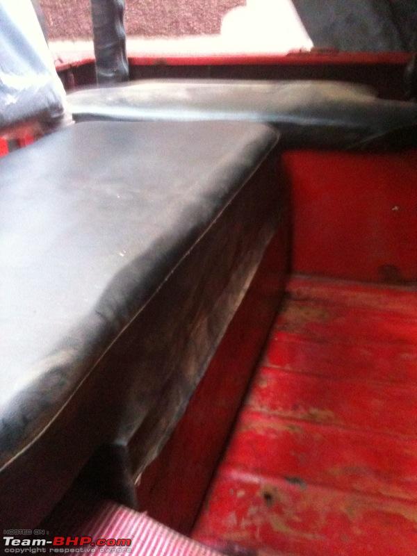

Long awaited pics of my rear bench install. I had an old metal case lying at home with a really thick gauge metal. Sand papered and spray painted it. Took it to the welders and got it fixed to the rear bench. The whole thing is then nut bolted to the tub using existing drain holes.
The side seats needed to be modified slightly and reduced in width.

Thats a very innovative storage box you have got Tejas I also need to figure out something like this to accommodate more stuff inside and make it lockable.
