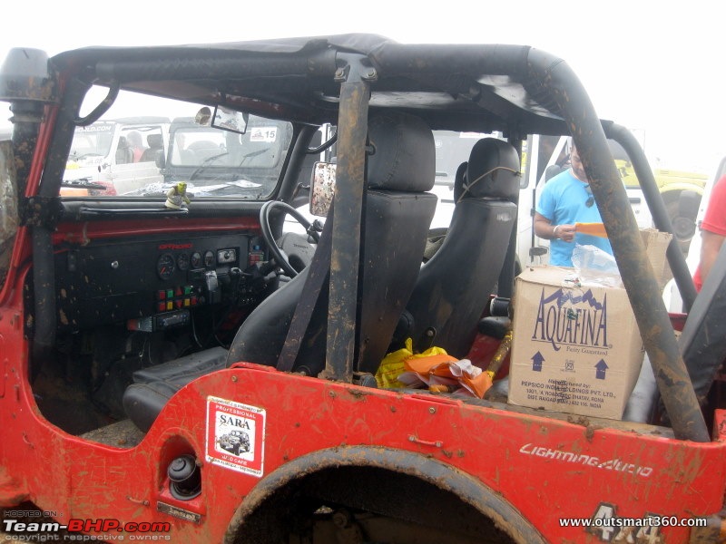

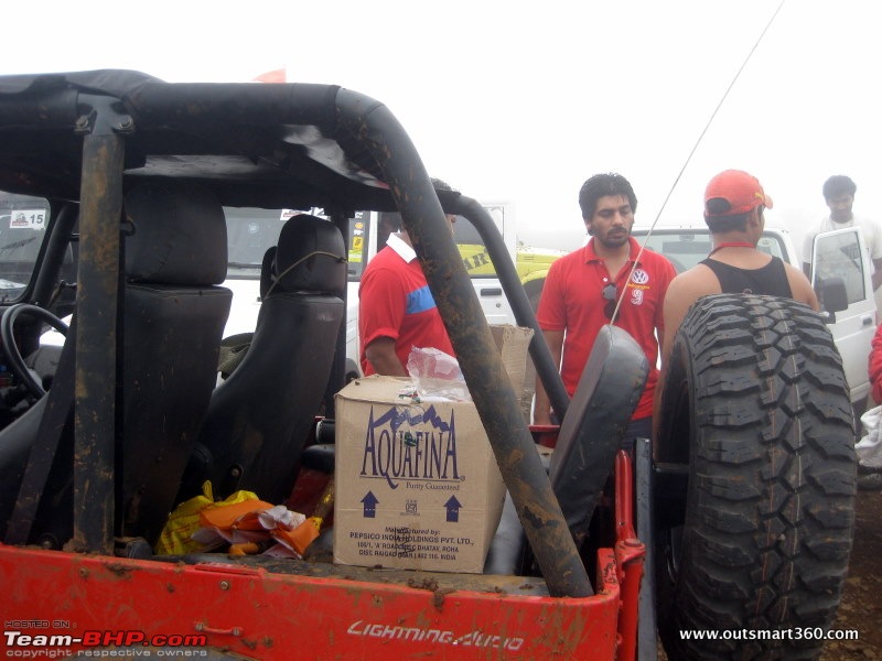

@ Red Liner: you took some pics of my roll cage during the EXAMM! Please post them here till i get to my jeep.
Here you go. Pictures of your roll cage from a variety of angles:
