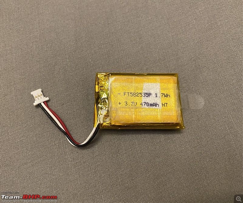

  • After about a year (outside the warranty period), the internal battery died. If I don't drive the car for an hour in the last 24 hours, the dashcam's internal clock resets upon the next ignition. I have to either manually set the time or use the time sync feature on my phone over WiFi. It would have been better if 70mai used a replaceable coin cell for its time controller. 😑 (The time sync issue is irritating enough to make me consider buying a different one.)
Update after ~ 3 years of ownership (142 months)
I sourced a replacement battery from Nexdigitron, the official reseller for 70mai in India, but they initially sent me the wrong battery (HMC 1450) meant for the older Midrive D04 model. The correct battery is a flat Micro LiPo battery (FT582535P) with specifications 1.7Wh, 3.7V, and 470mAh.
Around the same time as the battery replacement, my dashcam started randomly rebooting. It would happen within a few minutes of the car starting and at other random times. I considered the possibility of the SD card wearing out quickly, so I replaced it, but that didn't resolve the issue.
Next, I examined the power supply. I use the dashcam in hardwired mode with the official hardwire kit using a fuse tap (I chose hardwiring to clean up the area around my center console). The fuses were intact (they had failed earlier, but I replaced them with new ones). When I connected the dashcam to a 20W Apple charger via a Micro-USB cable, there were no reboots. This made me suspect that the power supply to the dashcam was faulty.
However, I wondered why the inbuilt battery didn't kick in if there was a momentary power supply failure. It's supposed to work for a few minutes after the car is turned off. Maybe it is just the replacement battery being faulty. Maybe it doesn't function like a UPS. At this point, I've given up on finding a solution and am hesitant to replace the power supply and wiring to fix the reboots.

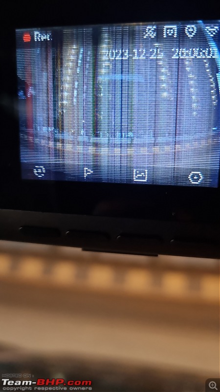

Hi, I'm new here.
Installed the 70mai A500S dual Dashcam on my car.
Got the hard wiring kit as well
Got a reasonably rated local installer to do the job
Had a few questions regarding the unit. But I'll get to that later.
There is banding on the screen.
The Dashcam / Car Video Recorder (DVR) Thread-img20231225wa0012.jpeg
Do you think this is a problem with the unit or an incorrect installation problem?
On a side note the app is prompting me to update the Dashcam software. Could this be a solution?
