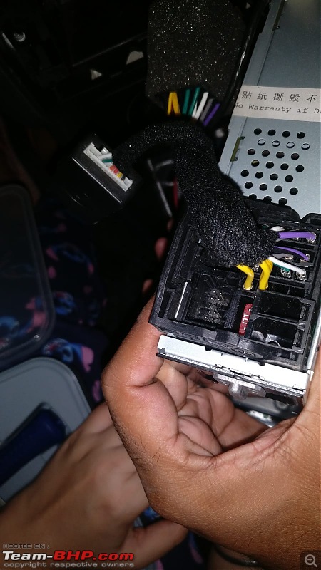

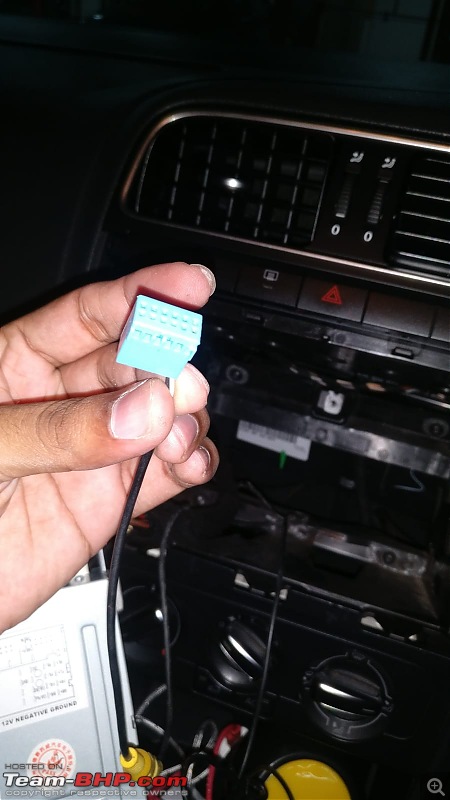

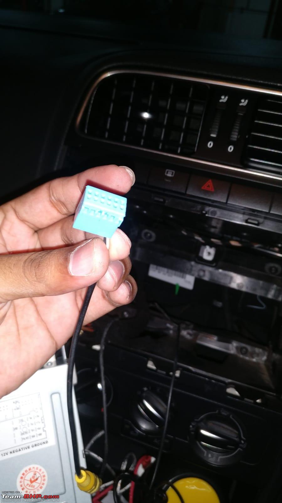

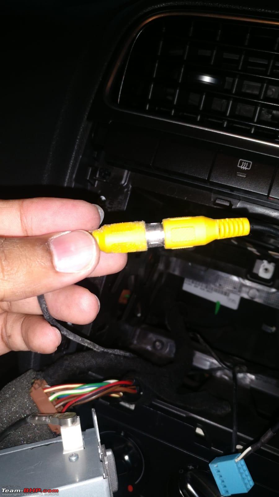

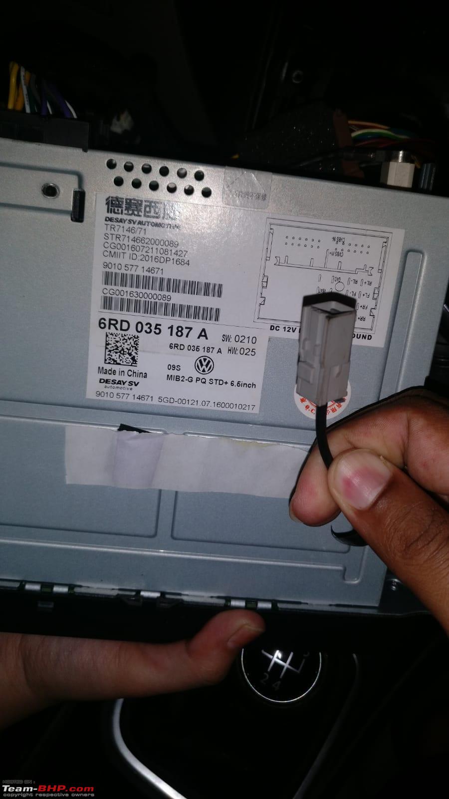

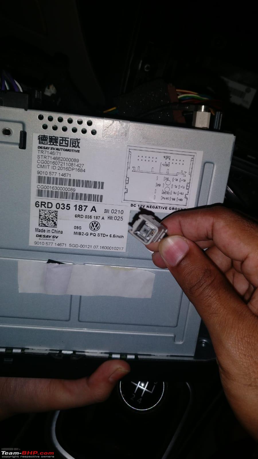

I have the following set-up in my car which has a RCD 330 Plus (Desay Unit). I am keen to do this DIY!
I opened my HU yesterday to understand the current set-up and what do I need to purchase.
There are two cables I can see
The rear view camera cable with yellow color and the convertor with blue socket (with two thin wires plugged in). This is plugged on the left side slot in the system currently. This one fits in the right one also, but some diagrams in the thread above show them in the left one.
There is one more cable, which I dont know the purpose off. The black cable with the Grey socket.
Can someone who understands this please help me on how to configure the rear view camera? Basically,
  1. What to do with the Yellow cable?
  2. What to do with the Black cable?
  3. What to do in the VCDS Module?
  4. Do I need to purchase anything for a successful setup?

I will update this thread with my findings. Thank you once again.
Vikram, you also need to enable the respective bit Back-up Camera Installed under Long Coding in Radio-56 through VCDS.
