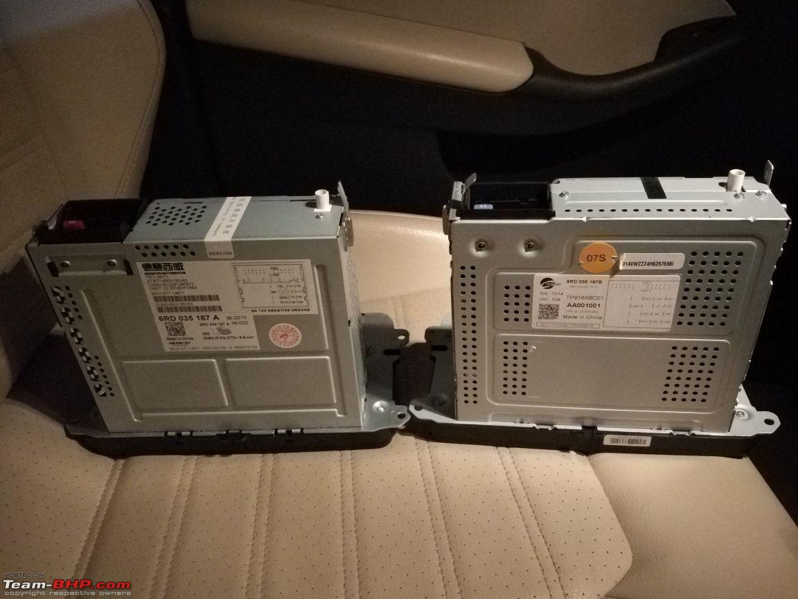

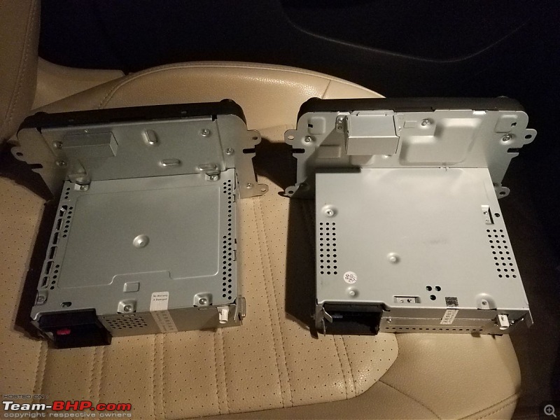

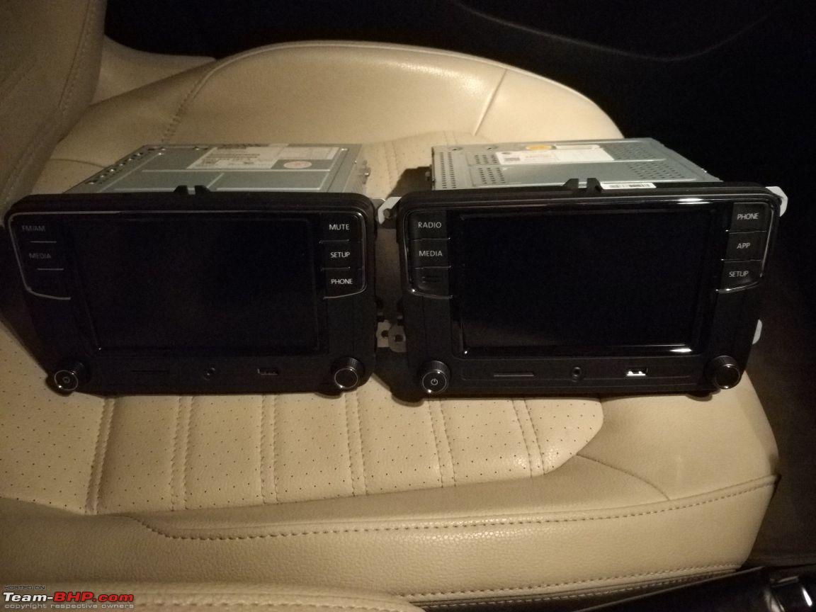

Originally Posted by Immix View Post
Yes, looks like this is a 187B with modified firmware that enables Android Auto. The seller has also changed the color theme from yellow to red. I placed an order for this unit yesterday. I'll report back once I receive the unit.
So I finally received the unit yesterday after a goof up of epic proportions by Aramex - they didn't process the shipment at customs for 3 full weeks and customs didn't even open the box. i must have called them at least 25 times during the last 3 weeks.
Anyway, on to the unit. I had originally replaced my RCD 510 with the Desay 187A version of the RCD330 plus. So when I received this unit yesterday, I took a few pics of the two units to for a quick visual comparison. See pictures below and please excuse the poor camera quality of my MI5
VW Polo/Vento : Replaced stock RCD320 with RCD330 Plus + rear view camera installation guide-image-4.jpeg
VW Polo/Vento : Replaced stock RCD320 with RCD330 Plus + rear view camera installation guide-image-2.jpeg
VW Polo/Vento : Replaced stock RCD320 with RCD330 Plus + rear view camera installation guide-image-1.jpeg
VW Polo/Vento : Replaced stock RCD320 with RCD330 Plus + rear view camera installation guide-image-3.jpeg
This (link) is the unit I bought and it comes with Android Auto and Apple Carplay. Seller is "upring store" but this is the same guy who used to sell on Aliexpress earlier by the name of "Yacht Science". If you go to the product page and look at some of the feedback he has received for this unit, you will notice that there are some quality issues with the unit. Sadly, I can confirm all of these issues and few more bugs.
The good thing, however, is that the seller has agreed to send me a new unit, which he claims is free of all bugs. Since yesterday, I have been constantly in touch with him and I am happy to note that he has been very cooperative so far. He told me that the first batch of these units that he received from Volkswagen China had bugs but the later batches are all bug free. He has told me that if I downgrade the firmware on my unit, which will take Android Auto away, all the bugs will be gone. So this is what he has proposed as a solution:
  1. He will give me the bug free firmware without Android Auto
  2. I will update the firmware of the unit
  3. I will then ship the unit to somebody in India who purchases the Carplay version of the unit from him on aliexpress in the next couple of days
  4. He will ship a new bug free unit to me and refund me the customs duty via paypal
I know this is not ideal but I am still OK with the solution. I'll report back once I receive the new bug free unit

Received the new head unit with Android Auto 2 days back from the same seller. Happy to report that Android Auto works perfectly and all the bugs are now gone. Total landed cost of a new unit comes to around INR 20,000 including customs. Here is a mini review of the unit:
  • Although the description in the product page (link) mentions the model as R340G, the part number is 6RD 035 187B, which was the part number of the HU with Carplay only. The R340G that comes pre-installed in Polo, Ameo, Vento, and Rapid in India has a different part number 6RF 035 187C (Reference Image)
  • Android Auto integration of Google Maps and "OK Google" in the HU works perfectly. This alone makes the update worth it.
  • Sound quality is decent although not as good as the OG RCD510
  • The Radio picks up RDS text from the stations that support this tech. Not surprising as the RCD 320 I had in my GT also supported this function.
  • The color theme is "Red" as opposed to "Yellow" in the RCD330 plus I had earlier. I think Red blends well with the red lighting in my car.
  • There are no presets for Equilizer. My RCD330 plus w/o Android Auto had a bunch of presets.
  • Haven't tried Carplay, so can't comment.
  • I do not have a RVC installed so can't comment on this either.
  • The only issue I have at the moment is that the HU stutters a little in Android Auto mode. I notice the sluggishness when I am switching between apps in HU and also while scrolling the cards in Home or going through songs in the playlist. The stutter is not horribly bad and will likely not bother a lot of people, but it does put a damper in the overall experience, at least for me. Outside of Android Auto - in Radio, playing music through SD Card, etc., things are fast as they should be. I haven't heard anyone with R340G complain so I think the sluggishness is likely due to the processor and/or 1GB RAM of this model. The R340G must have upgraded hardware to alleviate this issue, because of which the part number has also changed. Can someone who recently purchased a Polo, Ameo, Vento, or Rapid that came with R340G pre-installed comment on the smoothness / sluggishness in Android Auto mode?
Right now there is only one listing of RCD330 plus with Android auto on Aliexpress, but the good thing is that the seller is quite good and very responsive. And while I had issues with Aramex with the delivery of my first HU (with bugs) - Aramex took more than 40 days to get that HU to me, the second HU (w/o bugs) was delivered to me in 10 days flat. Let me know if you have any question about this unit.
