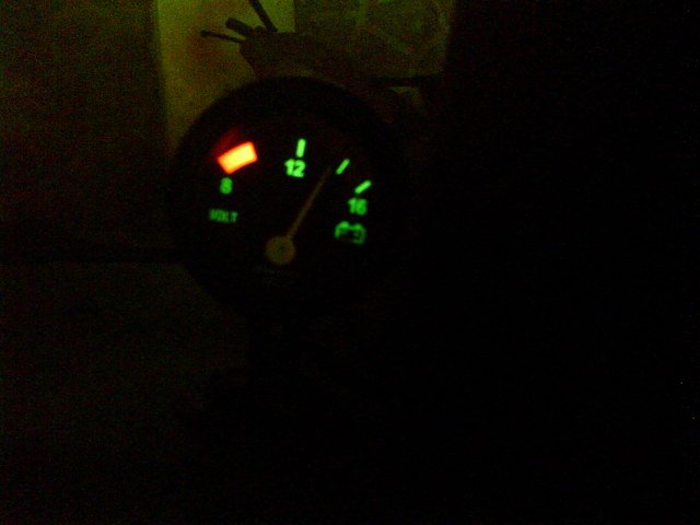

update on the project-
received the satguide kit by five days of ordering. satguide bluetooth gps receiver with Mumbai map and all India map. spent two days trying to pair it with my phone. then paired with the car pc. my bluetooth 2.0 dongle was not pairing up, later managed to pair it with the older 1.1 lying around in junk.
getting used to its various options now. the larger display is nice to look at.
the painful thing about the order was the day after i ordered satguide with Mumbai and all India map with receiver for 6k+tax times of india gave a one day offer for 3999. that was real bad.
next month will look at OBD and security and car travel data logging.
installed the voltmeter on right side so that will have a good idea on the electrical loads . this came to use the very next day of installing. that night while driving headlights started to dim and after some time was flickering. later completely off. no fog lamps also. i was scared initially expecting some electrical goofup but the voltmeter was rock steady all the time. because of this didnt stop and followed another car till home. later on found the connection out. if voltmeter was not there i would have stopped on road and searched for a mechanic since my tool box was lying in palio
some pictures through my mobile
