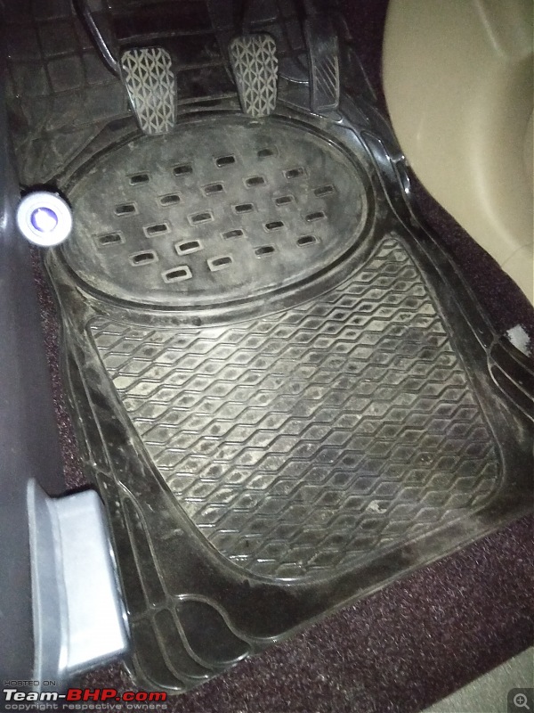

Since I love to keep my car absolutely clean, I decided to put noodle mats in my car. Did it as a DIY. I brought 20 sq ft of the mat at ₹45 per sq ft.(we know the since we always buy all the required things from that shop. his salesperson said tgey sell it for ₹60 per sq ft.)
I planned to install these beneath the rubber mats. Here is the final output.
(sorry for the picture quality as they were clicked in low light conditions under a flash.)
Passenger side. The rubber mat was taken out before clicking this.
This is the driver's side. Note that the rubber mats are in their desired place.
The left rear side.
The right rear side .
I wanted to secure the sides and the carpet which is not covered by rubber mats. Do note the mat which is placed below the passenger seat.
I used velcro tape to keep the mats in place bought from a local shop. Got it for ₹30 per metre.
