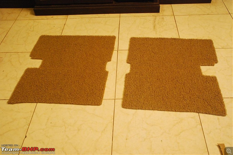

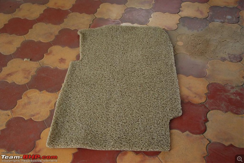

Was looking for a change of floor mats for my 4 year old Verna. Did not want to spend too much, so the 3D, 3M etc was ruled out. Did not want a repeat of the rubber mats as well. I had seen rolls of the noodle mat (similar to 3M Nomad), so thought I would do a DIY with this. Was a long weekend with Monday being a holiday, I thought I would take this up. Really happy that it came out well. Will observe for few days and maybe do a repeat for my X1.
The material is available in two widths - 2 feet and 4 feet. It is sold in sq ft, so its important that you first take an approx measure of how much you will need so as to avoid wastage. I bought a 2 feet width one (beige colour), 8.5 feet length. Thats 17 sq ft. After a bit of bargaining, got it at Rs. 1300. I'm sure you will get it cheaper if you scout around. I got it at approx Rs 76/sq ft.

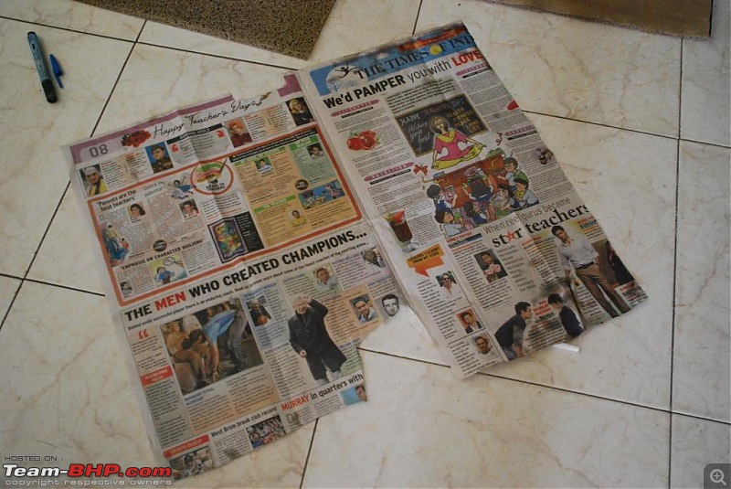

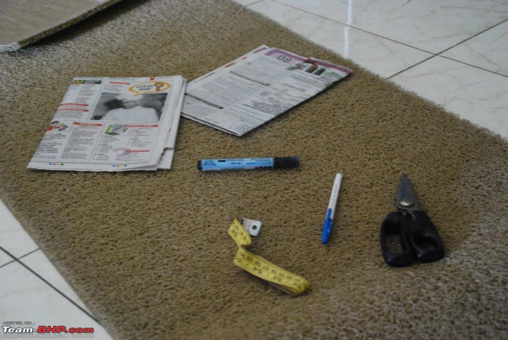

Next is to get a newspaper template of the exact dimensions and then cutting the material as per this template. You will always need to do some final tweaking in the car - especially to accomodate the cutting for dead pedal, fuel lid opener etc.
Tools needed - Good pair of scissors, Measuring tape, Marker.
Let the pictures do the talking. Hope you like it.
