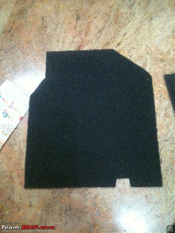

Posting the pics of the work done on the WagonR.
Got 20 sq.ft of greyish black colour.
On conservative mode, avoided the extra bit which goes into the front foot well. I save around 2 sq.ft.
Finished product of front driver side mat.
Front Mat in place. Made sure i had extra bit to slip it under the gear console(Arrow mark).

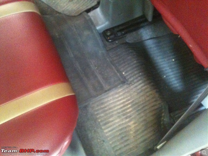

Rear of wagonR is not flat. The rear floor is a raised platform and the area under the front seats is a well kind where all the dirt gets accumulated.Please look at the pic below of the pathetic displaced old mats
Finished rear mats. I couldn't get exact pattern of rear with news paper. Just got the outer dimensions, then kept the mat in place, made the markings and did the cut. No seperate piece for the hump.
Rear mats in place. Made sure had extra bit on both the mats over the hump. One will rest on the other.
I used only 16 sq.ft of the mat roll.
P.S. : Keep in mind to use the mirror image(upside down) of the paper cutting on the reverse on the mat for markings. One could easily end up cutting the other way.

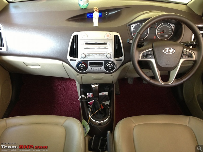

Changed the floormats of my i20 to the Noodle-mat. Getting the exact dimensions was indeed a pain. Since this was a first-attempt, kindly excuse the imperfections.
Pics:
The Passenger side:
The Driver side:
