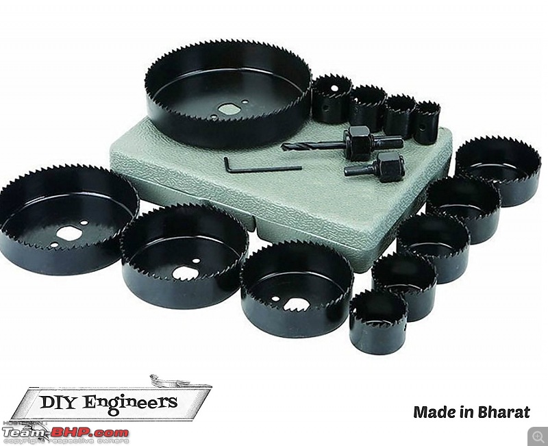

If you are not going to drill large holes in steel then stick to 10mm drills. The nomenclature of 10mm, 13mm etc is capacity to drill through steel (as well as chuck size). For wood and masonry the bits of larger diameter have shanks that fit 10mm drill chuck.
I personally like buying individual drill bits to suit the job.
. For drilling in walls, I suggest that you get a few long (say 150-250mm) masonry bits in 6mm, 8mm and 12mm
. For wood working get a range from 4mm to 12mm.
. For large diameter holes in wood get specialised "Hole Saw"
