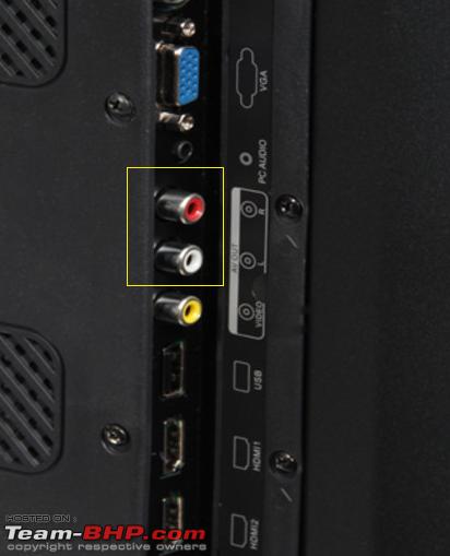

re: The TV Thread - LCD, Plasma, LED etc.
Originally Posted by fine69 View Post
Can somebody help me figure out whether I can attach a 2.1 sound system to Philips 50PFL4758 (50" model) through our regular 3 mm jack? If not are there convertors which will allow 3mm jack for sound system and some other jack for this TV?
It has a composite audio (RCA) input on the side:
You will need a 3.5 mm TRS to RCA cable to connect your 2.1 system to the RCA out.
The RCA sockets on the TV are inputs; you have said so yourself.
How can these be used to connect a 2.1 audio system to the TV?
If there are any RCA output sockets, they are not shown in that picture.
They are outputs. It was a typo. Check out the description in the sticker adjacent to it. It says AV OUT. Sounds good now?
... It says AV OUT. Sounds good now?
Indeed it does!
Sorry, I could not read the sticker.
This is a rare feature on TVs today, to have an analogue audio output. Only a few carry a headphones output.
