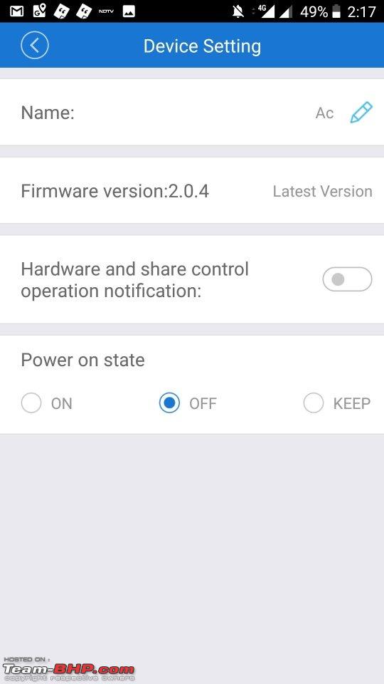

I bought 2 of these after diyguy mentioned about it here. They have one issue though. They won't come online if there is any interruption in the mains supply. You have to manually turn them on or use the app in your mobile to turn them on.
I am using one of these switches to monitor the consumption to one of my UPS. I noticed that I have to manually switch it on everytime there is a power cut.
I think there is a setting for this, just play with the settings. See this page.
Yes. Thank you. I was running firmware version 2.0.2 and in my iphone, I can't see the download option as the line was hidden. After I downloaded the new firmware 2.0.4, the setting gave this option - Power on mode.
