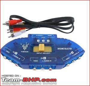

@DerAlte, Thanks for your help.
I was searching around for solutions,
Is this item suitable for my requirement.
Audio Video AV RCA 3 Way Switch Switcher Splitter&Cable | eBay
I can make RCA cables and will use only the audio ports.
My main concern is the current carrying capacity of this device since I am attempting this at the speaker level output.
rrswift is offline

Originally Posted by rrswift View Post
... Is this item suitable for my requirement. ...
I can make RCA cables and will use only the audio ports. ...
A-ha, I had bought this box in Delhi long time back to use in my sister's house - cheap AV switcher for 250!
Yes, you can use this box if you terminate the 3 pairs of cables (2 pairs from receiver and the bookshelf speaker wires) with RCA plugs - commonly available. Solder -ive to outer, +ive to pin. Receiver A speaker to In 1, B speaker to In 2, bookshelf speakers to Out.
Current carrying capacity will be sufficient (you are doing 0-current switching anyhow), but what will be suspect is the switching action after some time. This switch is contacts wiping PCB tracks, so any dust depositing will make it go kaput after some months. Keep it wrapped in cloth to prevent dust - I used a small cloth bag with just the cables coming out.
DerAlte is offline
