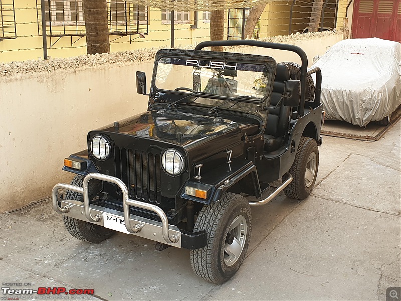

GTO's 1997 Mahindra Classic needed its Registration Certificate renewed some years ago. Because it is registered in Nasik, the vehicle had to be driven to the city. The process cannot be done remotely.
We ensured that the vehicle was in excellent shape, be it the body, mechanicals or electricals. We then hired an agent as GTO isn't a DIY guy at all. The original RC, insurance, PUC, pencil print of the chassis / engine numbers, copy of the owner's id proof and PAN card were sent to him. He filled out the Form 25 (attached to this post) & kept the document set ready. Guess Aadhar card might need to be added today (it wasn't then).
Procedure of renewing vehicle registration at the 15-year mark | It's easier than you think-1.jpg
The agent gave us a date for the re-registration of the vehicle and since GTO was occupied with other matters, I took the car to the Nasik RTO to have it passed. Important to note = it was not necessary for the registered owner to be present himself. The RTO officer inspected the vehicle very carefully for faults and took a print of the chassis number. This was done by placing an A4 size paper on the portion where the chassis number was engraved and using a pencil to print it out on the paper.
As the Jeep is in good shape, there was no problem found. After the documents were duly signed and stamped by the inspecting officer, our agent paid the necessary charges and on obtaining the receipt, I drove back to Mumbai. While the official renewal fee is just 600 bucks, you can expect the RTO to add various charges, fees & levies (registration charge despite one-time tax paid, green tax etc. etc.). Time taken? In total, I spent about 4 hours at the RTO.
About a month later, the renewed Registration Certificate was sent by registered post to the address mentioned on the old RC. Due to the infamous fake address racket, the RTO came up with this method of verifying that the address actually exists.
