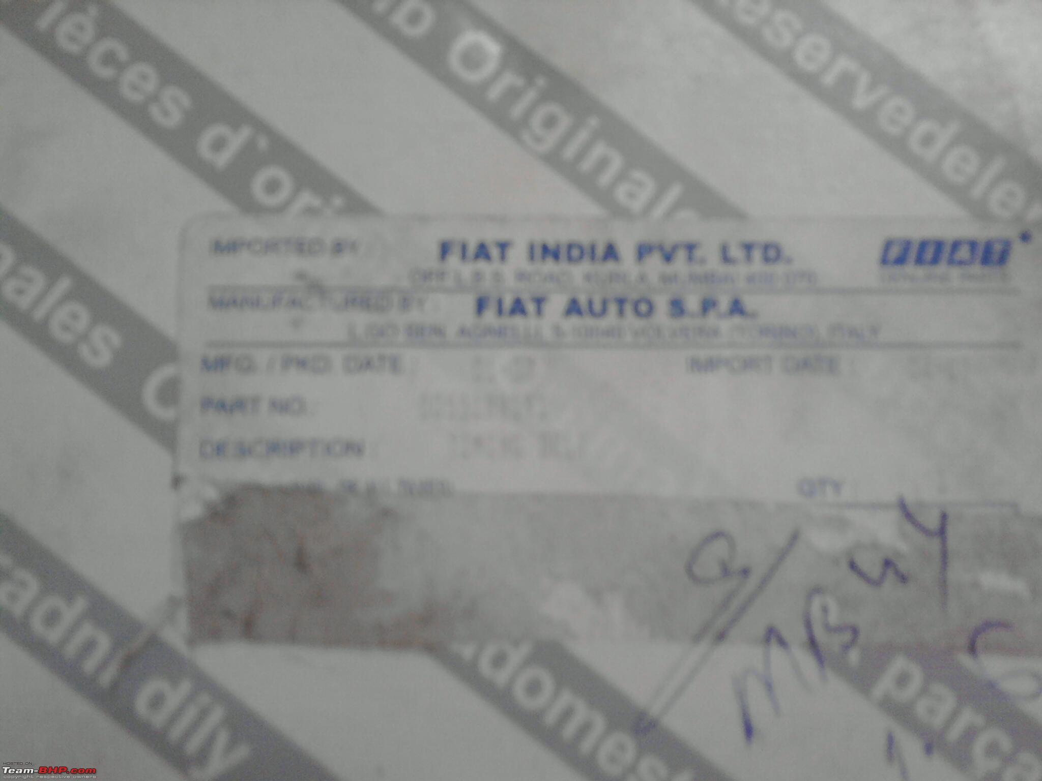

Timing Belt Part Number Confirmation & Pics:
Palio GTX - Red beast comes home! EDIT: update @100,000 kms-photo0037.jpg
Palio GTX - Red beast comes home! EDIT: update @100,000 kms-photo0036.jpg
Palio GTX - Red beast comes home! EDIT: update @100,000 kms-photo0035.jpg
